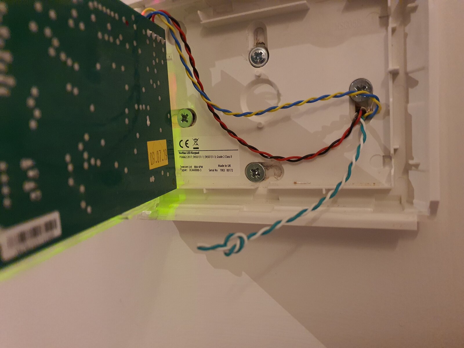

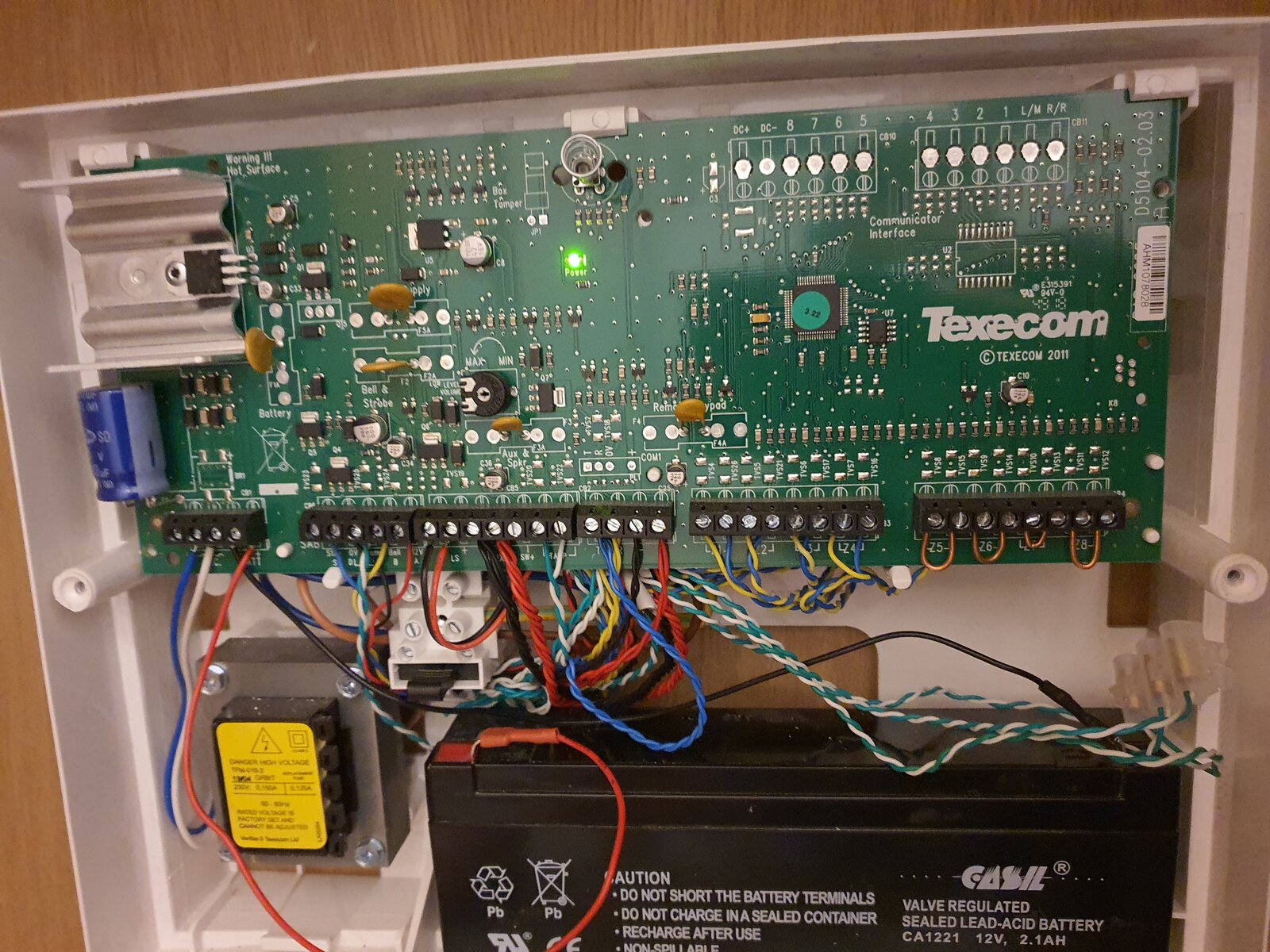

HI,
I bought the house with alarm installed Veritas R8. Upstairs keypad haven't respond to anything. So i mess around with programming but keypad starts working. But after week or so i had few false alarms but only from keypads. So i decided to cut the power(remove wire from battery, remove fuse) then everything looks like I've done factory reset. This time I only change the user code and engineering code but both keypads still working. After few days false alarms comes back. So I've done few factory resets but doesn't helps. False alarms coming back all the time. I've check manual and there is information how I should change setting on DIP switch, but I havent found one. I put engineering code,Prog, 09, (shows red dot on number 1 and 4)Prog, Reset and error tone can be heard.
I don't know what should I do to get rid off those false alarms from keypads. Anyone can help?

The veritas can have a valid address between 1 and 6 for remote keypads. They don't need changing.
what is the false alarm?
Sounds like normal alarm but sound is only coming from keypads. I've heard them only when unset. I have to put pin to get them silent. House was redecorated just before when I move in so I perhaps the alarm is around one year old.
sounds like means nothing, the keypad display should show the fault at the time, or go into event log to look at the fault.
I haven't got a digital display. I think only shows tamper when keypads goes on and when i put i pin is just gone. Haven't set up time this time. But when i set time up doesn't help at all. I never check log. Need to check manual how to do it. Is that possible that alarm got some issue and i should try to send it back as under warranty issue? Thanks
Tamper fault could be ?

Post photo of control panel wiring for a start.

if you read the manual, you will see that in the event log you can look at the extended display and the tamper will give you another number, that number relates to where the tamper is coming from.

you may get a 5 or a 3, 5 keypads lost (address changed or not connected), 3 a lid tamper
With first post I uploaded control panel and keypad. If i should make different one please let me know.
