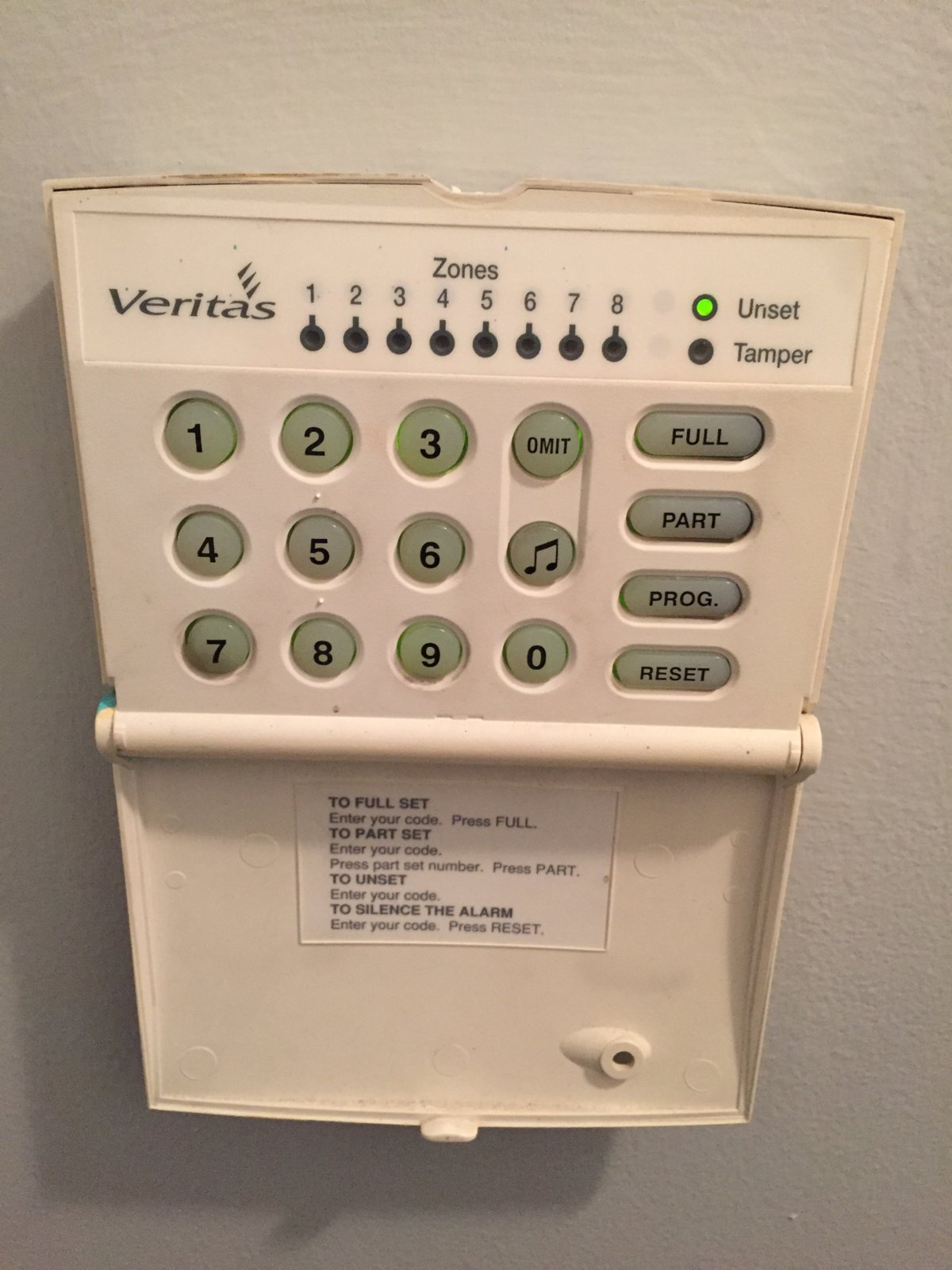

Hi think I have a Veritas R8
Been having problems since I had the power cut off so I changed the internal battery
The alarm sets now and when I return home put the code in to cancel it just doesn’t do anything and activates the alarm.
To silence it I have to enter 4321 & reset
The company that installed have gone bust and nobody seems to know what I can do...
maybe a full reset ? Please if anyone can talk me through this or put me in touch with a engineer that can? I’m in St. Helens area NW

draw a plan ! What zone lights up when you enter the building BEFORE you reset the panel ?
No zones light up when I re-enter I put my code in pressed full and left the house the blue light on the exterior building flashed 7 times
When I came back in it wouldn’t recognise my code so had to enter default this then cancelled it
Amazing you are a absolute star mate
It’s worked (I think) seems to be working thank you so much this has been doing my head in all day. Can’t thank you enough :)
