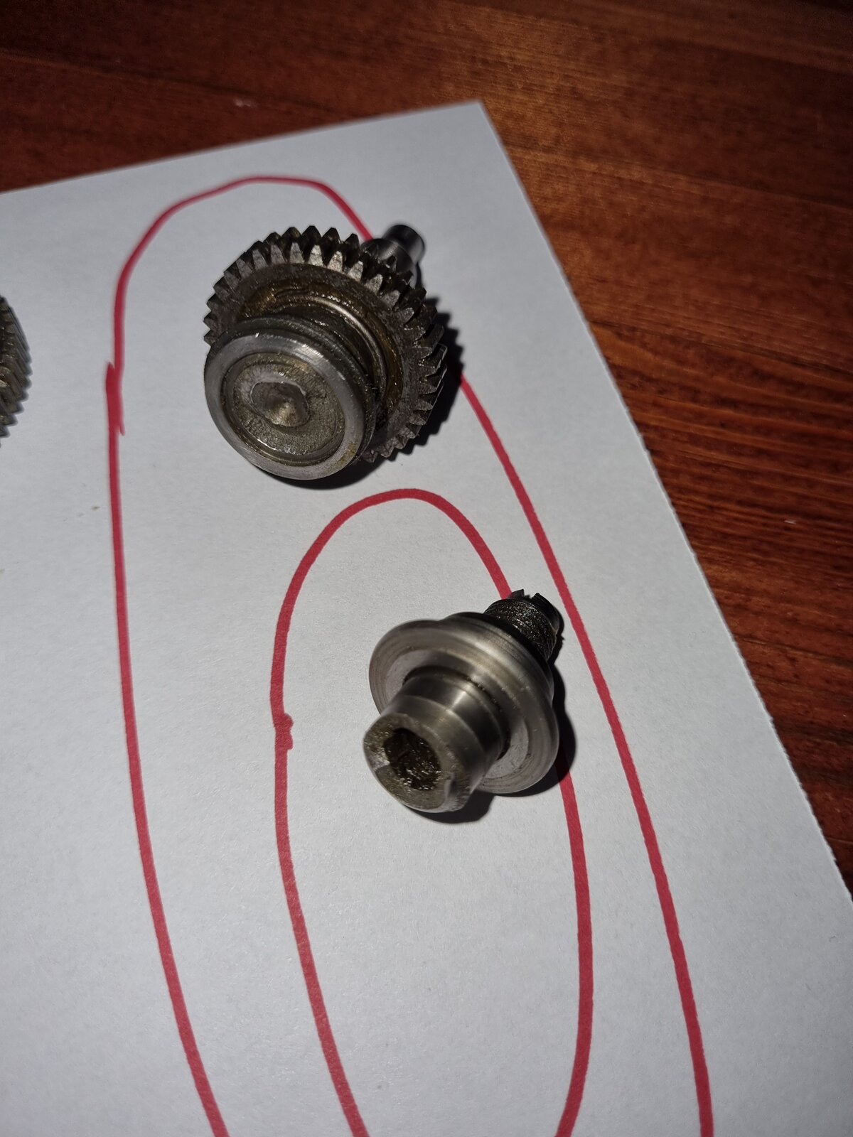

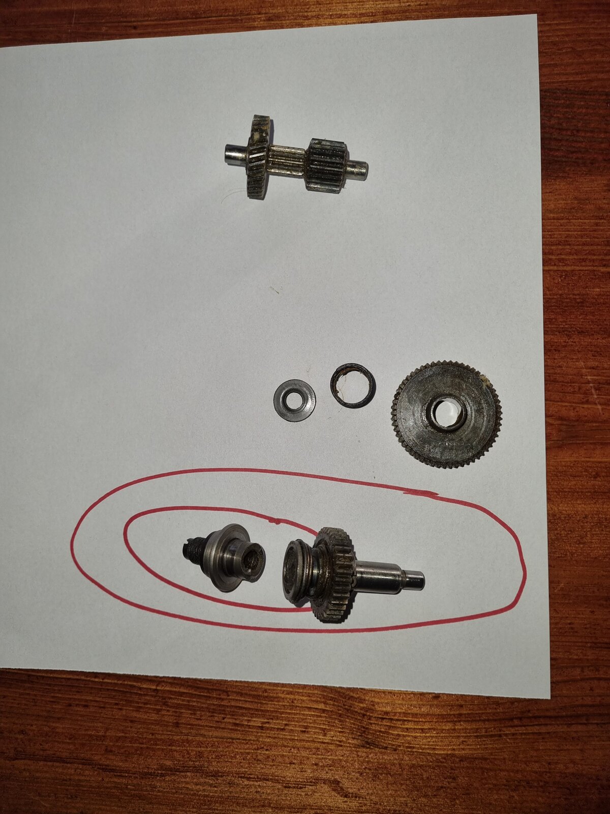

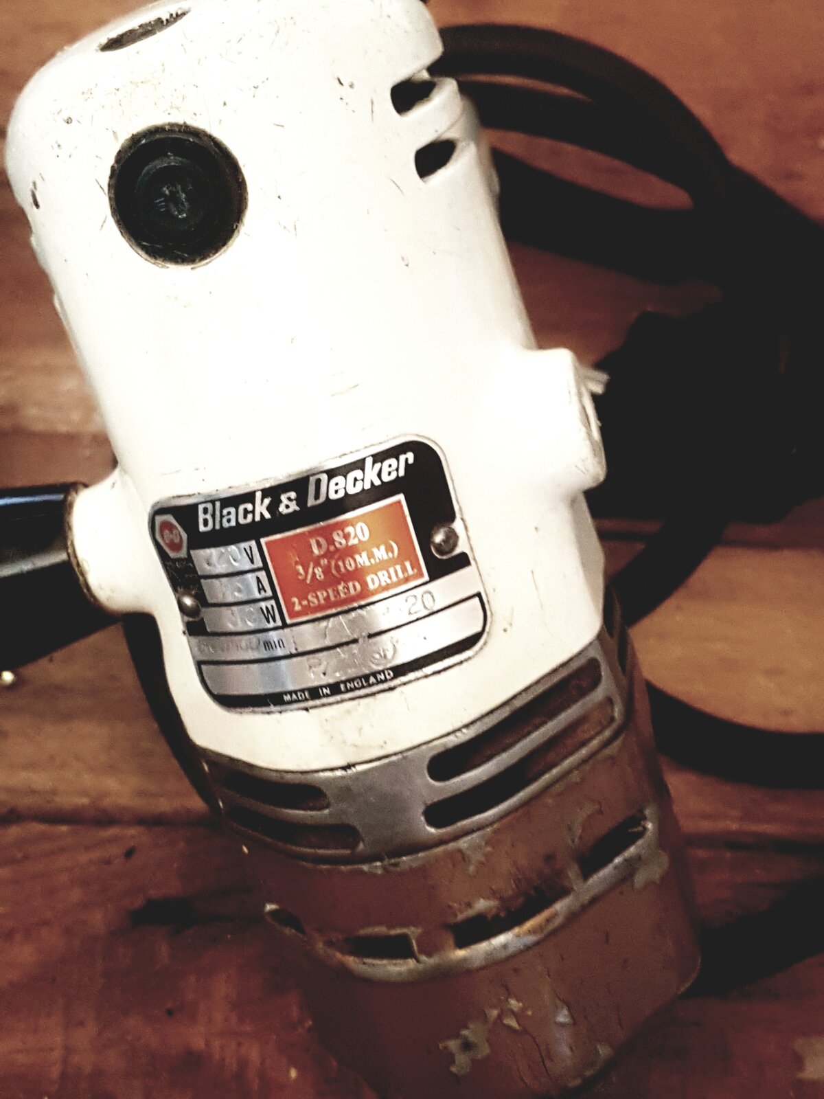

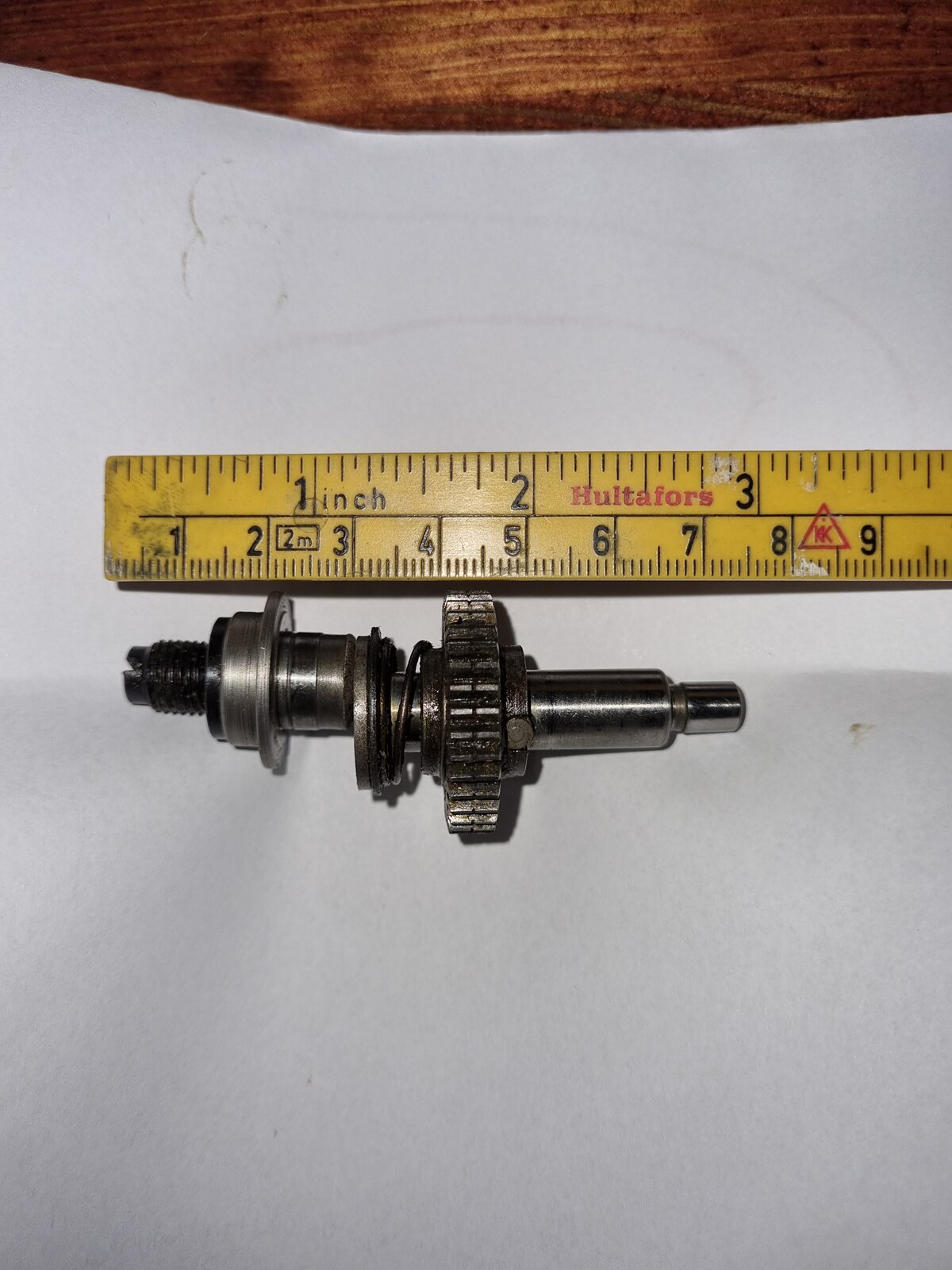

Hi! I'm repairing old B&D D820 two speed drill from 60's. It's gear, main axel, is broken. Does anybody know where I could find one?

Thank you for the link :giggle:, this seller doesn't send item abroad. I've no idea what those letters mean but I see that there is difference in amperes and watts on the labels.

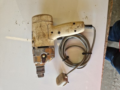

Your D820 is more than 50 years old, so parts have long been unavailable. The D820 and the single speed D800 were replaced by the V8xx series around 1971, the main differences being the 3/8in chuck being replaced by a 1/2in Jacobs model, the motor being upgraded to to 400 watts and a nylon body (as opposed to an aluminium body with a nylon coating, although I may be wrong about that).
As said before, your best bet will be to look for an older 2-speed model with a pull out and flip tag type gearbox. This type of gearbox was used on the all-metal D420, D520 and D720 models from the mid- to late-1960s onwards (painted at various times all light grey, all gold, all blue, white gearbox/blue body and gold gearbox/brown body) as well as the later lt grey metal gearbox/orange plastic-bodied models (e.g. models D420, D520, D720, DNJ52 and DNJ62, etc). Avoid the later silver/teal and all plastic body models as the gearbox design did change later in the 1970s.
Personally I'd look for an orange/light grey model as they are later (1973 to 1978 or so) than the all metal models and the gearbox is compatible. You should be able to pick up a "worker" for £10 to £20, but if you can't find one PM me and I should be able to find you either a complete suitable gearbox or the contents of a compatible gearbox from my bits box (you'll need something like 10 posts to send and receive PMs). I know that I currently have a complete lt grey gearbox which came out of a GD-series (industrial) drill but which has been fitted onto a DNJ84. As it is the wrong gearbix it will be getting replaced shortly, by the correct type of gearbox (I already have this, it just needs cleaning, greasing and respraying)

Yes, well, I can see that antique B&D parts may well be an issue. I had a look this morning and I have a couple of donor drills (gearboxes) which will fit. I'll strip them down later on to see what state the gears are in. The gearboxes themselves are quite heavy, so It should be a lot cheaper to just send the gears and thrust washers. I'll let you know what I've got later on

It seems like I can use that feature already and take contact later. But I'll post here photos of that broken part later today.
