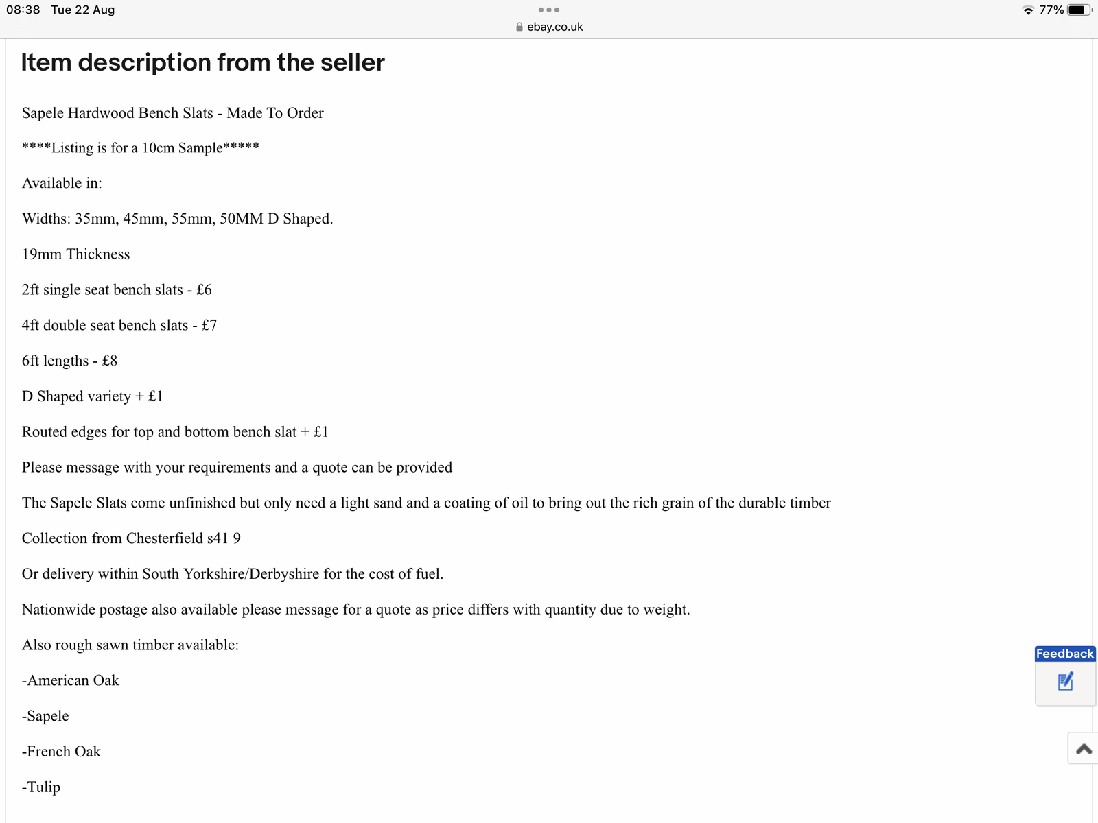

Suppose it would be stright replacement job of the timbre rails as long as they are cut for the correct measurment. Need to drop by local timbre yard. I don't suppose B&Q would stock the timbre rails for the replacement? What sort of timbre would be the best for the replacement? Oak? Ash? - suppose they have to be solid hardwood.

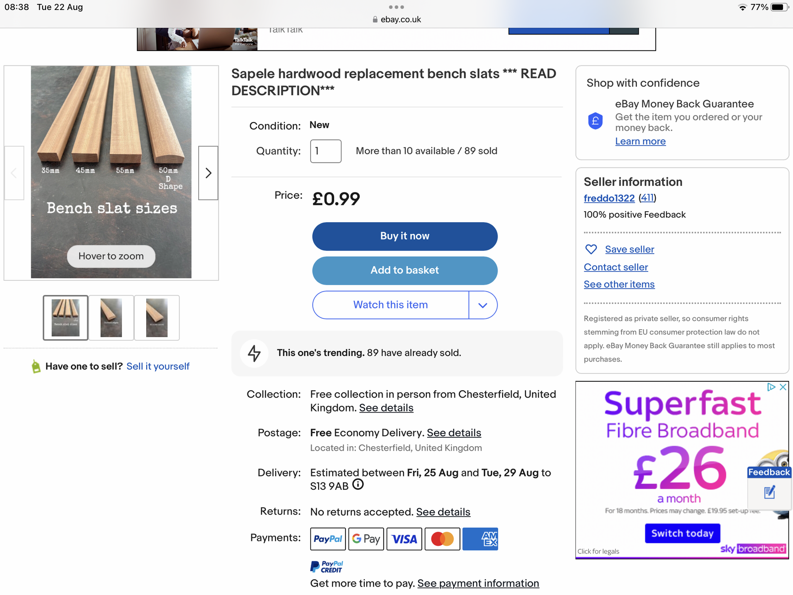

go to your local timber yard or saw mill [not a general builders or diy] and ask for suggestions as they will know what they have and may have an odd piece at a decent price
Great info. Thanks. I was also looking at local B&Q timbre stock list, because it is the near from us.
I was going to get exact measurment of the slats, and then get roughly same sized ones, and cutting them into exact size to fit into the cast iron frames and shaving the edges into rounding for the end slats just like the original ones. But will also look for local timbre yard as well - perhaps price might be better there?

Look on eBay ….example …
