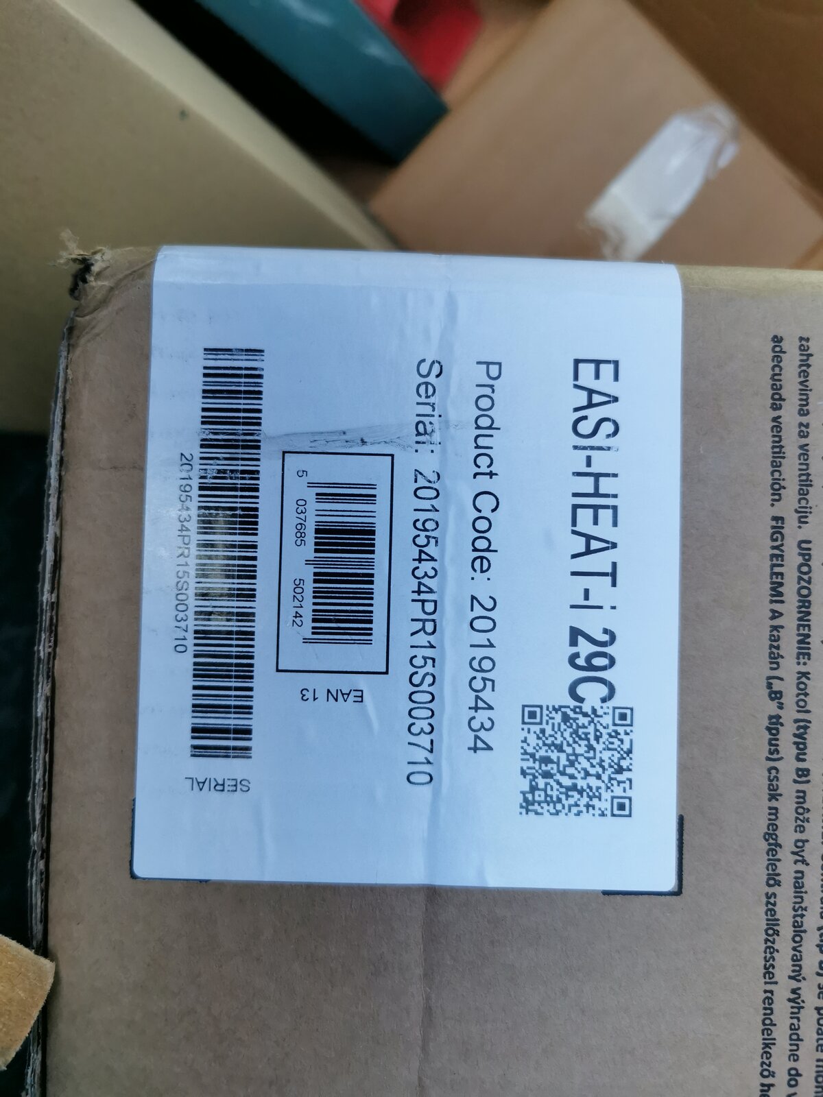

Hi there, it's an Easi heat I 29 C.....hope this helps? Thanks
The reason I ask is that there is an easiheat C, an easiheat ci, and an easiheat i.
Does it have a digital display and buttons left right and below the display. Picture?
The 'i' is the latest but the factory made some more of the discontinued earlier C model recently because of demand.

So this is what was on the packaging, hopefully this helps? Really appreciate all the help folks
  • Thanks
Reactions: CBW
Ok, the stat is compatible.
Your gas safe engineer should have no problems wiring the stat in but you’ll need a connection box.
I say gas safe engineer because you have to open a combustion cover now on this boiler and that shouldn’t be done by someone not competent to do the necessary safety checks afterwards.
I’m assuming you have a RF room stat and a receiver that connects to the boiler.
Take a LNE fused at 3amps into the box from your household supply.
Connect the LNE from the boiler in the box.
Connect LN from the receiver of the control to the LN terminals
Connect the switching wire connections from the receiver (usually black) to the TA terminals of the boiler as shown in the boiler manual using a separate cable.
If your gas safe engineer or his electrician puts mains voltage into the TA terminals of the boiler they’ll burn out the board.
This is the most common fault call we get so tell them to take care.
If you use a different brand thermostat all the above still applies.
