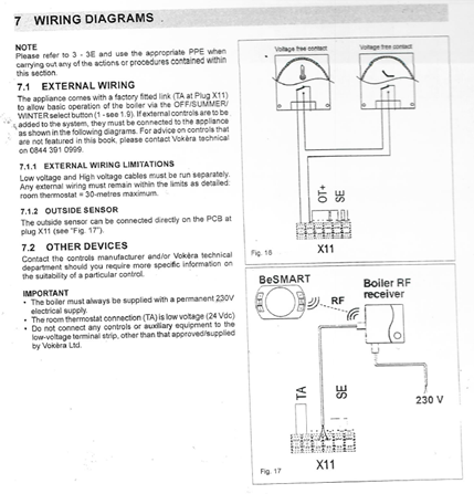

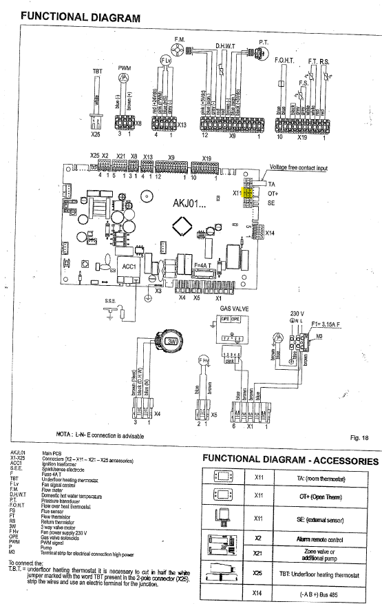

Hi All, New to the forum and i think my issue seems to be a common thread.
I have the Easi-Heat I combi boiler and the Vokera BeSMART Alpha 7D Programmable 7 Day Wireless Room Thermostat, the issue being the boiler does not have the plug and play so its a wiring job.
Following the example below, it advises to wire into the two middle connectors, or in the above diagram the OT+ is this correct, because its not syncing, i.e the receiver is flashing green about every 1 second, reading a post above should it be wired in the TA connectors?
Second question, im reading on another post something about the Besmart servers being replaced, is that relevant with my example. When i try to use the COUP mode to sync the control returns r01, any help with this will be eternally appreciated.
For extra clarity i have attached where we have wired, again i am now wondering whether it should be the TA connections
Yes, the TA connections. Your version of BE SMART is not one that could e connected to the servers anyway with a £80 accessory.
Your thermostat can be converted from ON/OFF to OpenTherm but you need to open the receiver and alter wiring.
