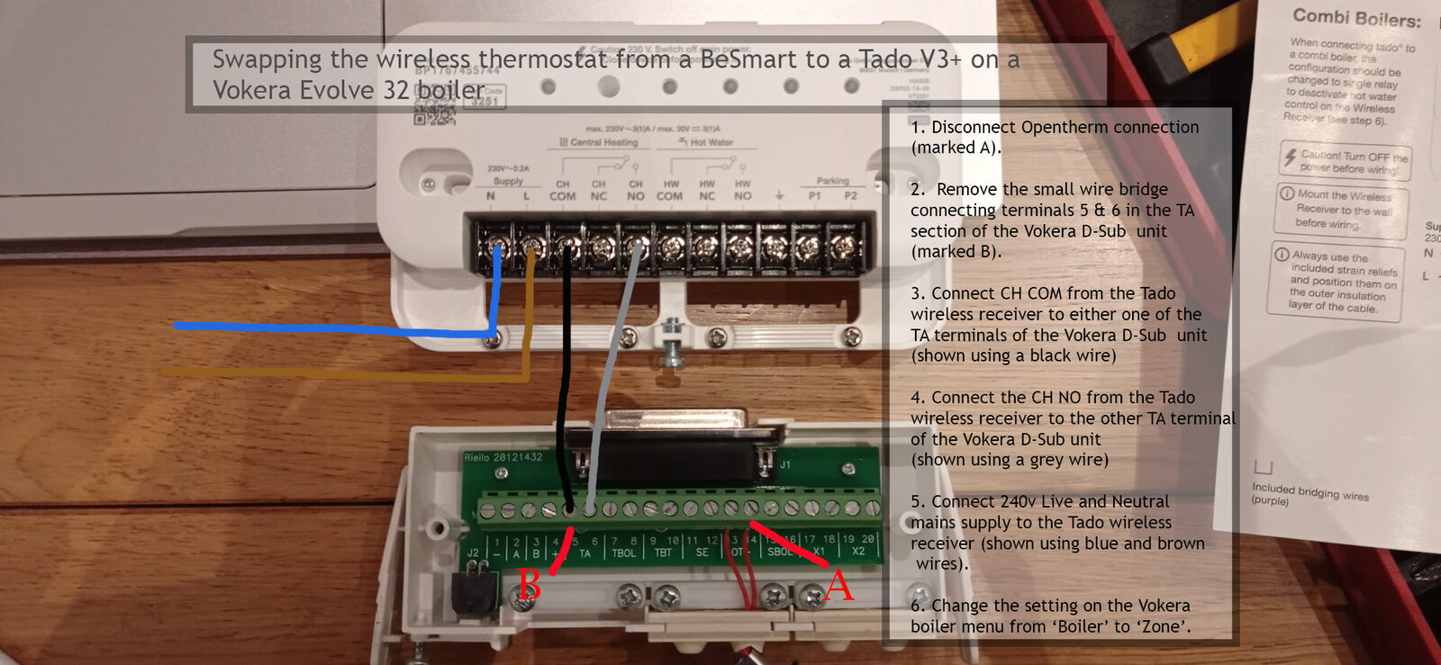

Vokera engineer came around and diagnosed a failed wireless receiver in the BeSmart thermostat. As it was no longer under warranty a new thermostat was required. Screwfix had a Tado v3+ on offer which looks like a direct swap as far as functions go so I got one of those. The Vokera engineer kindly advised me how to decomission the BeSmart and connect the Tado. System immediately worked with timer and thermostat functions and has been fine since installation 4 days ago. The engineer did mention 'server issues' with theBeSmart but didn't eloborate. I've attached a photo and the wiring instructions given to me so that they may assist others in the same situation. They are instructions to replace a BeSmart wireless thermostat with a Tado 3V+ wireless thermostat for use with a Vokera Evolve 32 boiler. I'm not an electition or plumber so if any of the instructions are incorrect or advice like this isn't permitted from DIY'ers please delete the image.
