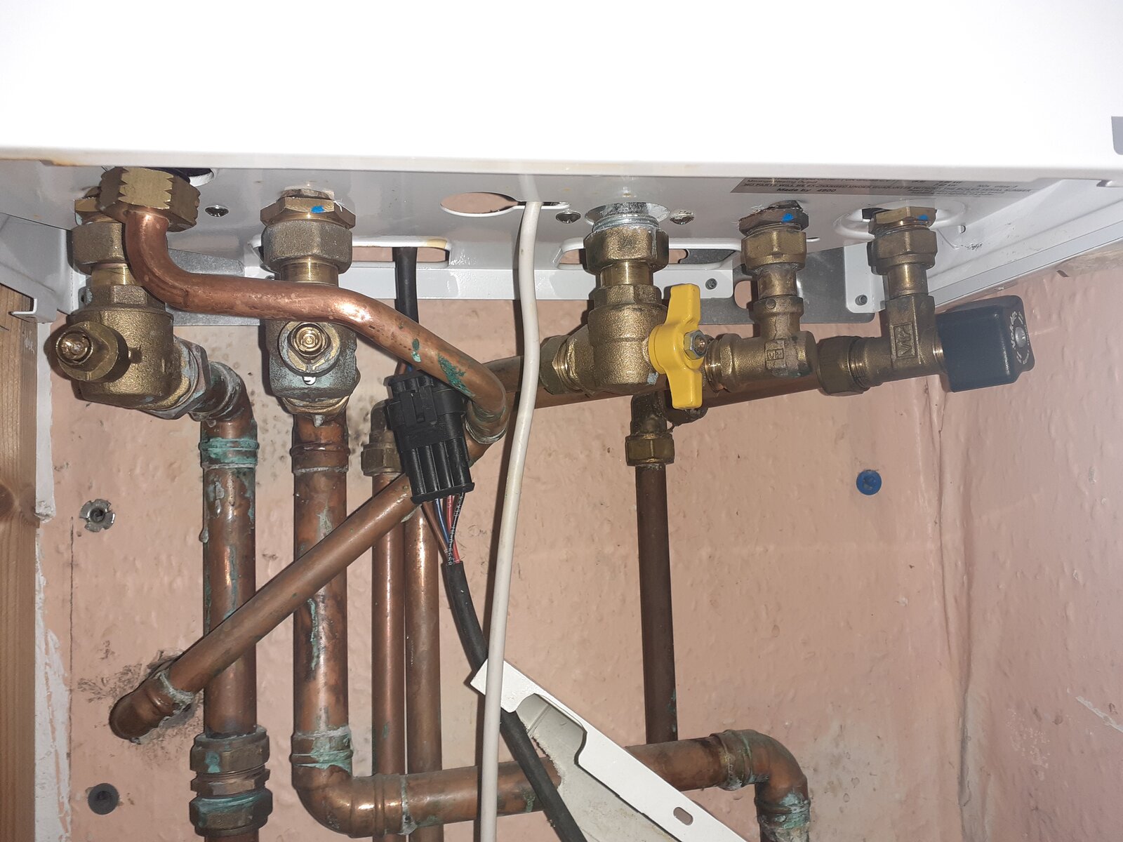

depending on the age of the boiler there are different setups with the in built filling loop, some of these can let by when in the, non filling position and if you have the earlier one this might be your broblem
Ok, ill take a pic and post it up, thanks Ian

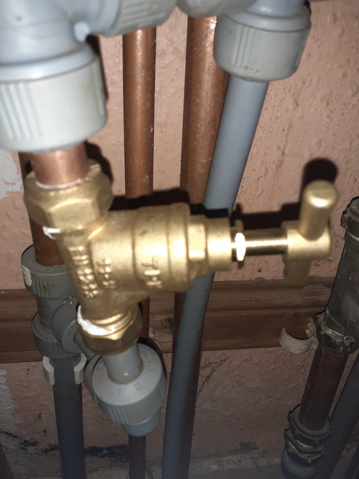

Pictures as requested. The filling loop is a 15mm stop cock, its brand new and not passing.

sorry not what I was looking for, can you show your filling loop please, that stop cock isnot the filling loop, if that is how you top the pressure up that is a total bodge, your installation is very poor but if that is how your system is topped up that is a disgrace

I'm afraid that's it Ian... :(
Totally wrong if that is your filling device , sorry I cant help you any further as I can only advise on systems that are installed properly, yours is a mess and could be so many things, if that stop cock is letting by that is your problem, hence the regulations that dont allow that kind of install

Thanks, just to clarify, this is a flat I purchased, therefore I inherited the CH system & the installation.
Funnily enough, I've had 2 GS engineers out to look at it, and neither commented on the filling loop or its installation.
