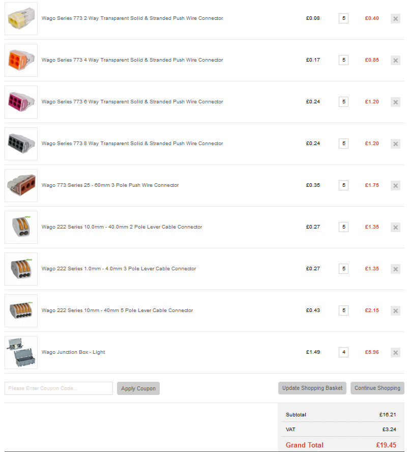

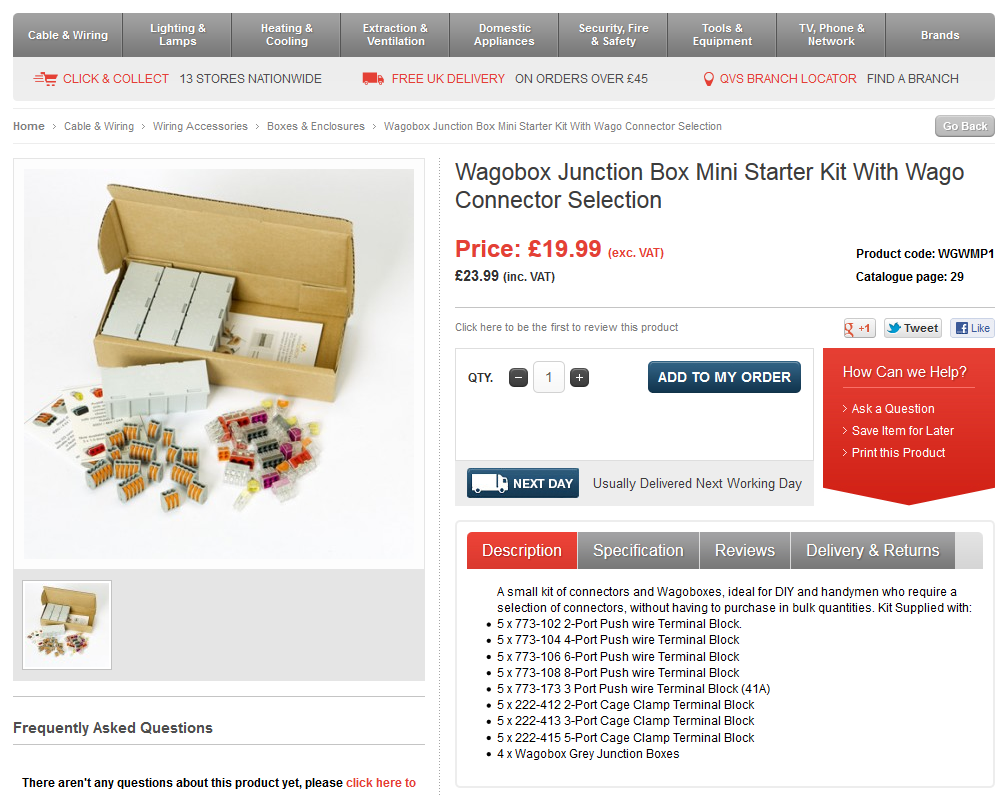

QVS seems to have the best Wago prices for small quantities, they'll sell as few as 1 of everything, at prices which are not depressingly non-linear - the break point for when 10x is cheaper is between 8x and 9x. Can find lower prices if I want to buy boxes of 100, but I don't.
Selections still make no sense - firstly they contain types I can't see myself ever needing, e.g. 8-port push-in.
Secondly they always seem to cost more than the sum of the parts
vs
£4.54 for a cardboard box? No thanks.
