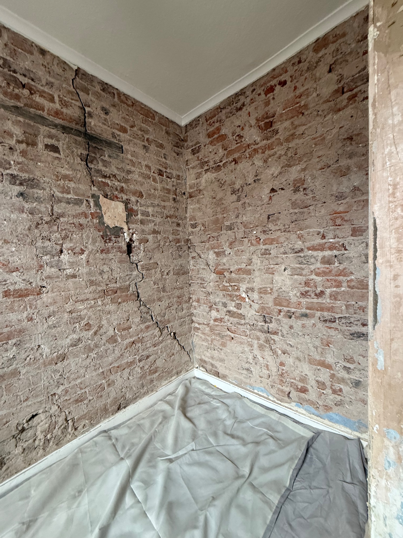

Hi, looking for some advice please.
We’ve removed blown plaster on an internal party wall in our early 1900s UK terraced house and uncovered a stepped/vertical crack running from near ceiling height down towards the floor. It follows mortar joints in places and appears to go through the brickwork rather than just the plaster. There was an older patch repair mid-way. It’s the wall shared with next door.
We’ve notified insurance but inspection isn’t likely until March. We have a baby due in April and were hoping to get the room plastered in the next few weeks, but I’m now worried we’ve opened a can of worms.
From experience, does this sound more like historic settlement/party wall movement, or something more consistent with active subsidence? Would this usually just be monitored, or is it unwise to plaster before it’s assessed?
Thanks in advance.

You need metal bars inserted in joints to stitch bricks before lime plaster.
I assume you will have lime plaster as old
Could be a sign of subsidence. I’d await the inspection.
If it has been arranged for surveyor/structural engineer to inspect then wait for their verdict. But seen much wider and longer cracks than that in old terraced houses judged to be historic.
Thank you, we’re going to try and get them to put us in priority to have it looked at due to me being heavily pregnant and it being the baby’s room. Thanks for the reassurance. Just crossing our fingers!
