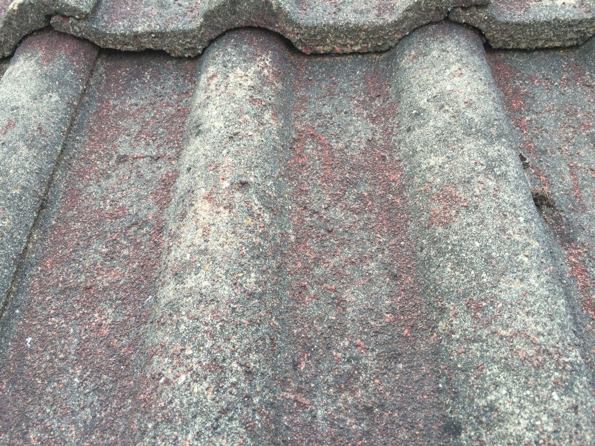

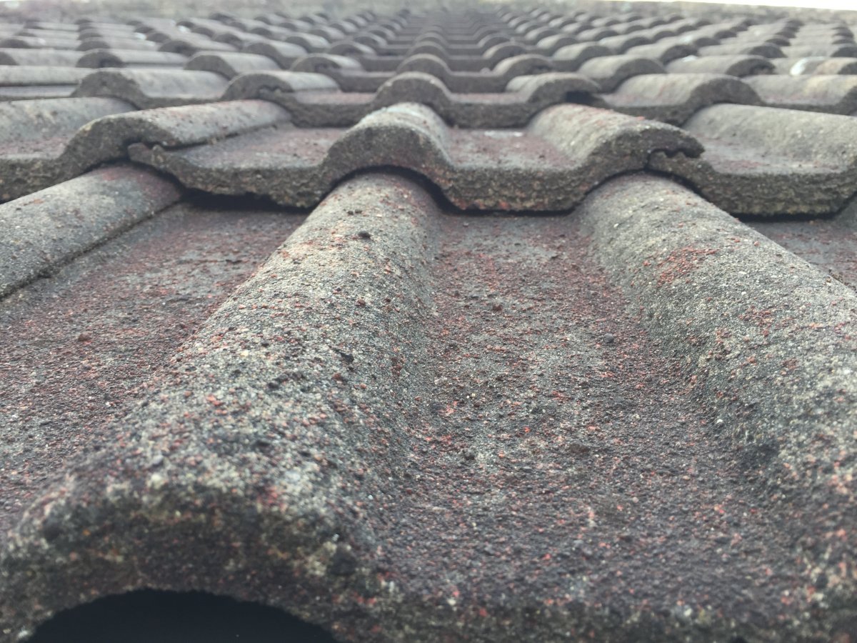

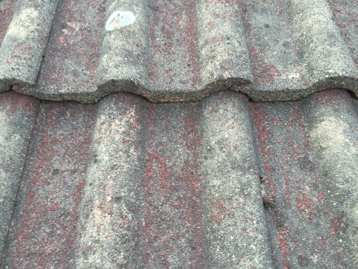

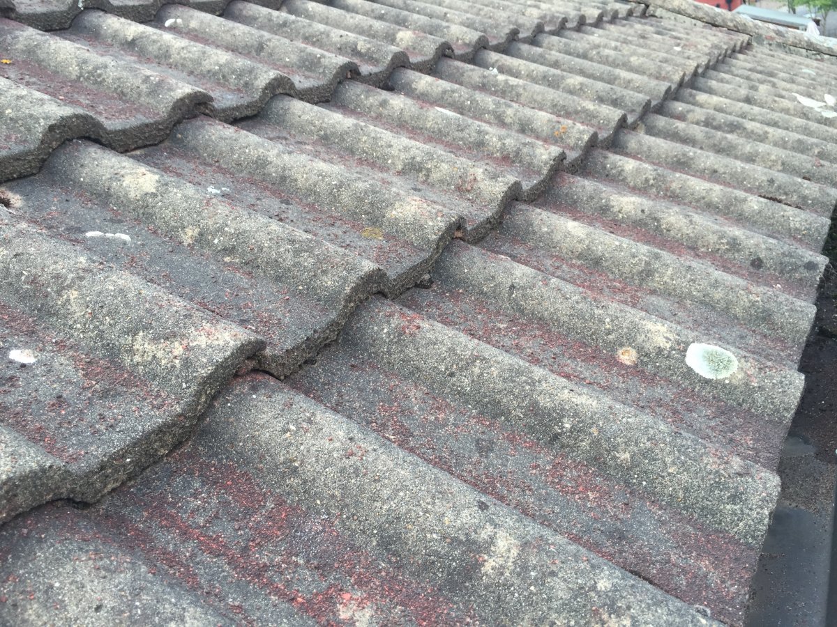

Thanks for the Reply Jimmy. I dont have any baton wood or roof tiles on site. I will pop to BM tomorrow and pick up a length of what i will be using and a few tiles.
Will use your approach and this should get me the measurement I need. Thanks
There are different concrete tiles!
It will be between 40 and 90mm depending on the tile. This is parallel to the rafter, so that's more vertically up the wall.
Hopefully the BM will be able to match the House roof. I will get a photo in the morning and post on here.

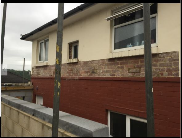

The side wall has three windows. I was hoping to go one brick under with the flashing. Do i need cavity tray along the full length ot the wall or can I get away with the just open wall areas?
I attach a photo showing the wall in question.
The question of cavity trays or lack of them is not a yes or no answer, especially when considering fitting them retrospectively. Exposure, wall position, shelter, wall condition, location etc can influence whether a CT would be of any benefit.
Thanks mfarrow, I was thinking of taking one off and taking it to Burtons tomorrow AM.
