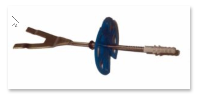

We are building an inner skin to an existing brick wall and are using a special angle bracket as wall tie. One part (vertical) screws into the existing brick wall and the other part is built into the inner skin like normal wall ties.
I would like to know how much should it overlap over the surface of the inner block? 1"? 2"? 3"?
I ask because currently it overlaps maybe 1.5" which I think is too short to provide a good bond.
Angle brackets (frame ties) aren't the best option as they have a broad profile and can pool water etc.
You should be using ss fish-tail screw in ties.
OK I will try to look these up. How to tell the builder of course is a totally different story because he will get defensive and tell me that he knows his job and that's how it's been done for 100 years. I can almost hear him saying that.
How about the overlap though? How much overlap should the tie have? I'd be much happier if it spanned over and across the whole block.
Ties don't need to be built in the full width of the block, 75mm would be ok, 1.5 inches or 38mm embedment is not enough.
I have looked and found these on the photo and I think these are what you meant - however not available in Travis Perkins, Jewsons, or Screwfix, unless I missed them,
Them's the ones.
If you stick one, thread first in the end of a (chuck) cordless drill, you can use the fishtail end to wind in the other fishtails.
Do not attempt to wind them all in by hand.

As it stands I will ask the builder to go get them, and if not available, to get the frame brackets in a larger size if possible.
Travis Perkins stock them in packs of 20, they are in a clear and yellow plastic bag near the joist hangers.
