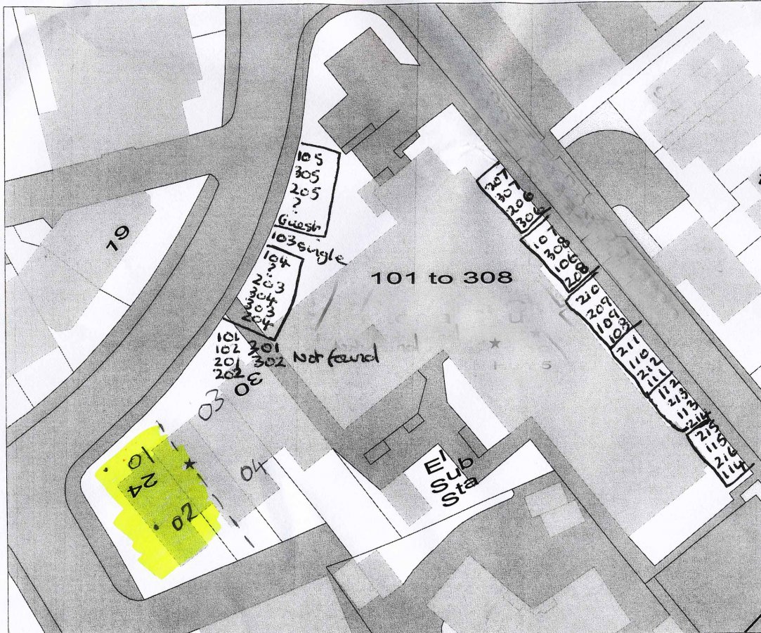

A bit of progress this evening as I now have the results of the water company's last efforts (attached). It seems the missing stop taps are for the last six flats at the end of one wing (i.e. the end two on the three floors as highlighted). It's also clear that the other flats have their own individual external stop taps mainly grouped together within footway meter boxes. It was dark when I had a look but of the two on the left hand side of the diagram, the lower one is almost completely obscured by privet hedge surrounding the flats. So I'm now working on two possibilities:
1. There is another meter box containing the missing taps buried even deeper under the hedge
2. There are two question marks shown in each of the boxes, so I'm wondering if they might actually feed the two risers for the end flats - but they could just as easily be for other purposes in communal areas within the building
I'm determined to find the answer now! :)
