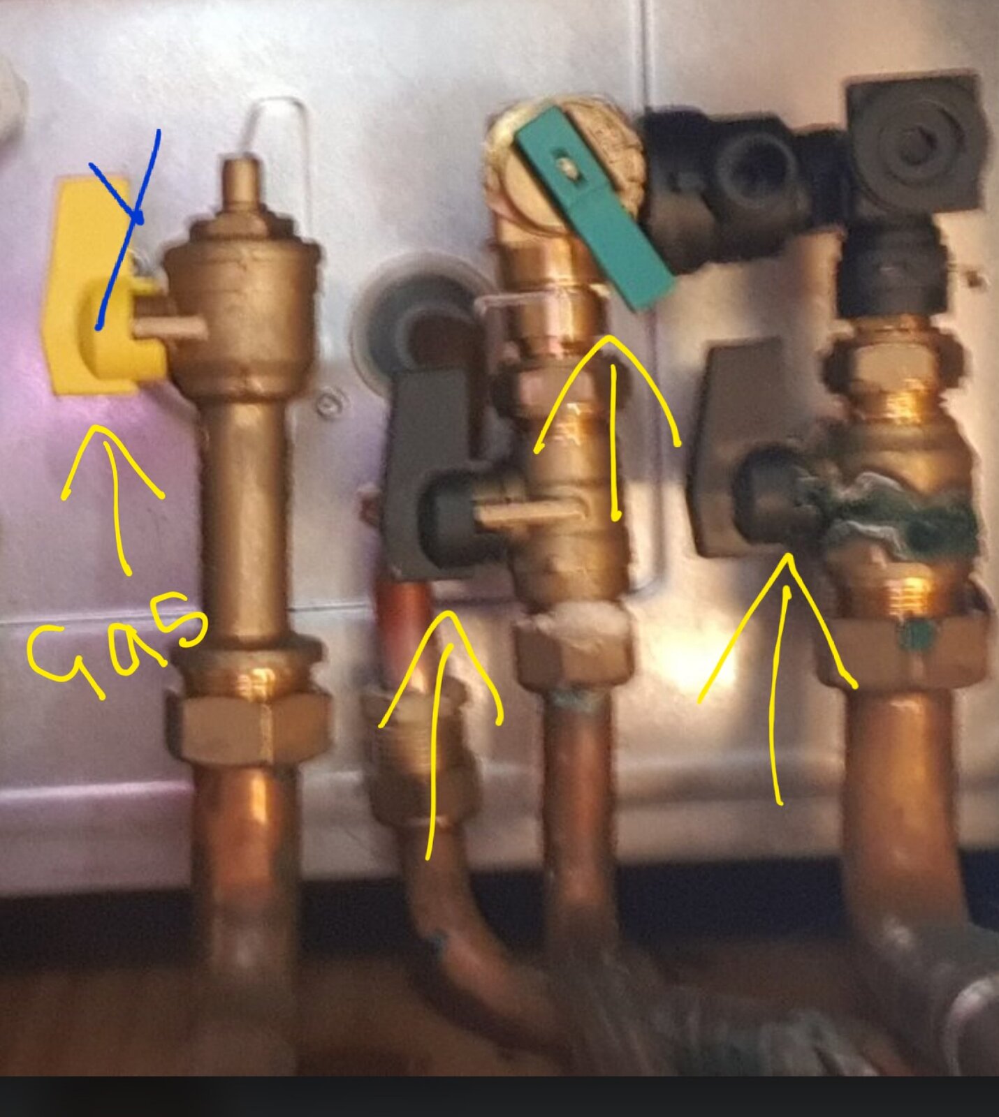

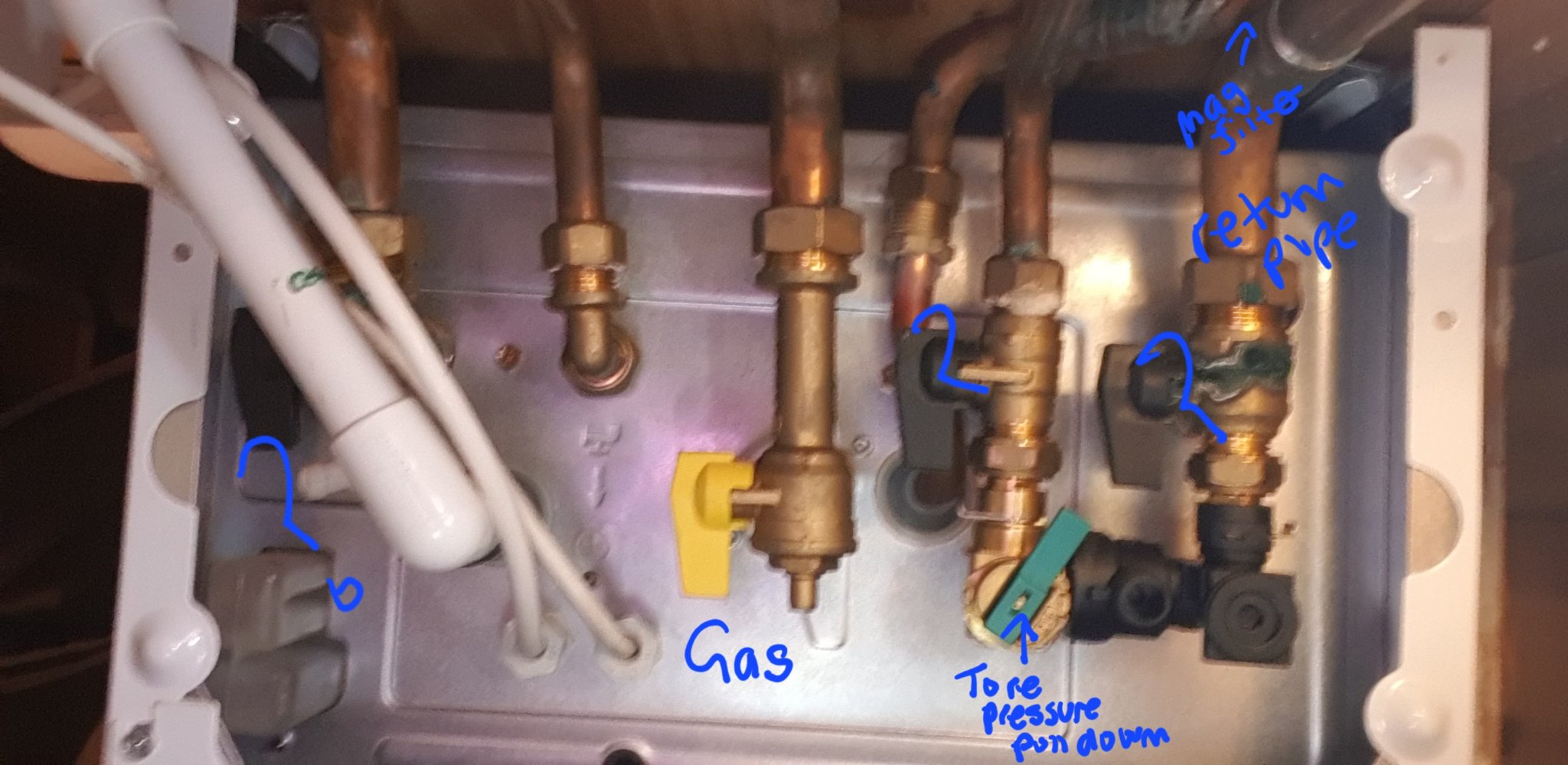

I have a baxi800 and an trying to ready myself to balance the 7 radiators in house I have just moved room . I may need to re pressure the system so in this pic are the levers for sure .
Can anyone identify them ?
What is the yellow one ?
Your help be so much appreciated.

I attach a picture of all the levers. Yellow = gas (I ain't going near that)
so the other three are water and middle one of them (that looks half way down ) is to release water into system ?

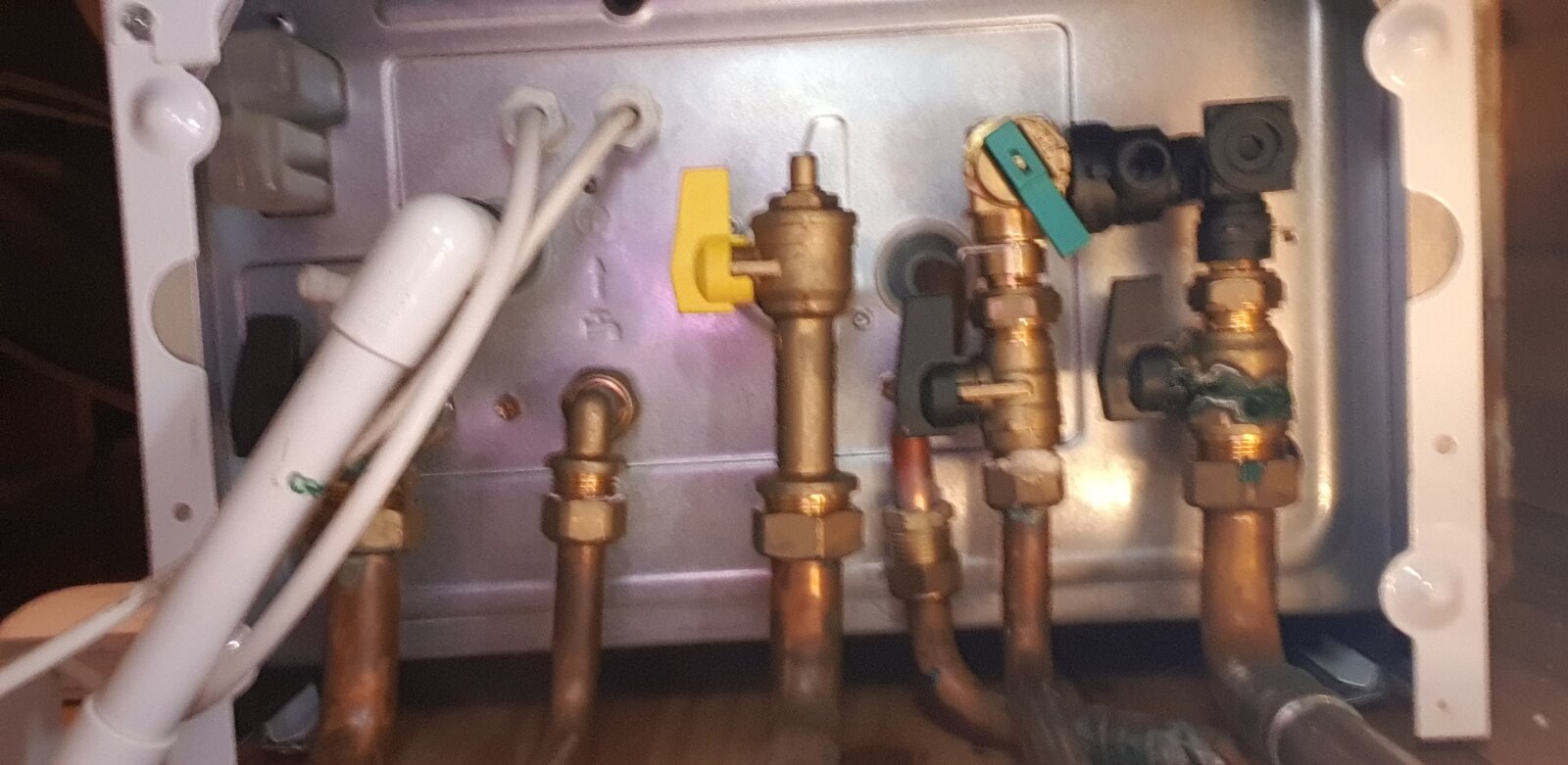

A while ago you kindly told me what lever under my boiler does what.
Im just trying to add all the dots as have to remove rad to flush and add maybe 2 TRV valves.
I attach a pic and wandered what exactly the levers do, which I identify with a "?"
There is one on the left I don't know what does and wandered if anh if these will help with removing valves , rads.

2 outside valves are the flow and return so the valves isolate the system's flow and return from the boiler. The valve 2nd from the right isolates the cold supply into the boiler or into the filling loop, usually position dependent.
The left one is the heating flow and the levers isolate the boiler from the rest of the system.

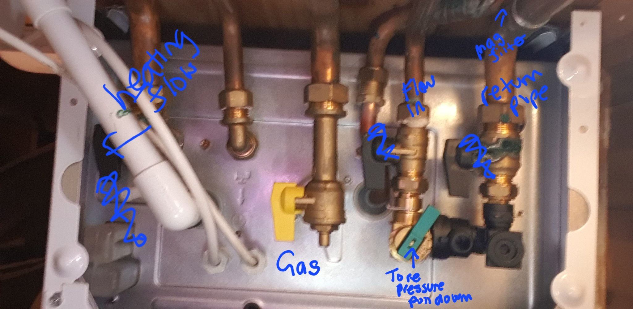

Re the left one - the heating flow ?
What is that ? Is only to do with hot water not the rads ?

The flow to the radiators, not the hot water taps.
Ok can you look at the picture again as I have from left to right . Need to hammer this down in my head.
-Flow to rads
-Gas
-Flow to ? With lever to re pressurise
( Do I assume this is simply the flow to top up from mains - water in?)
-Return from rads
