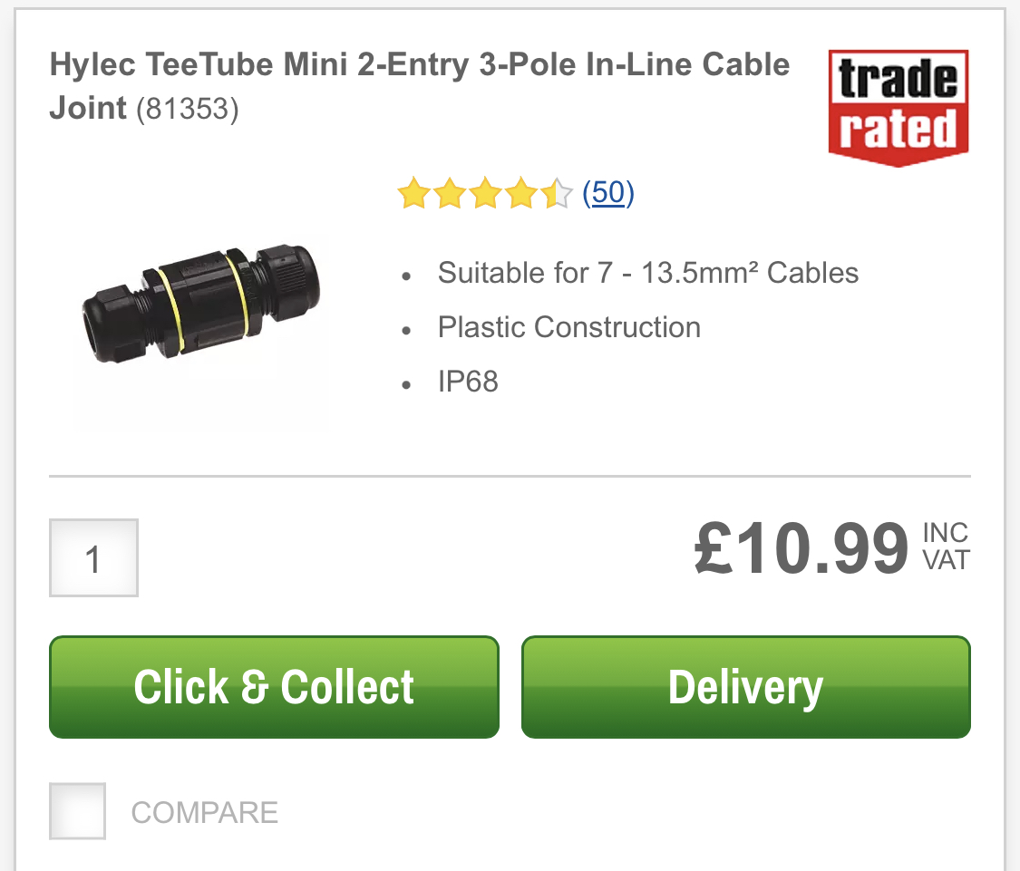

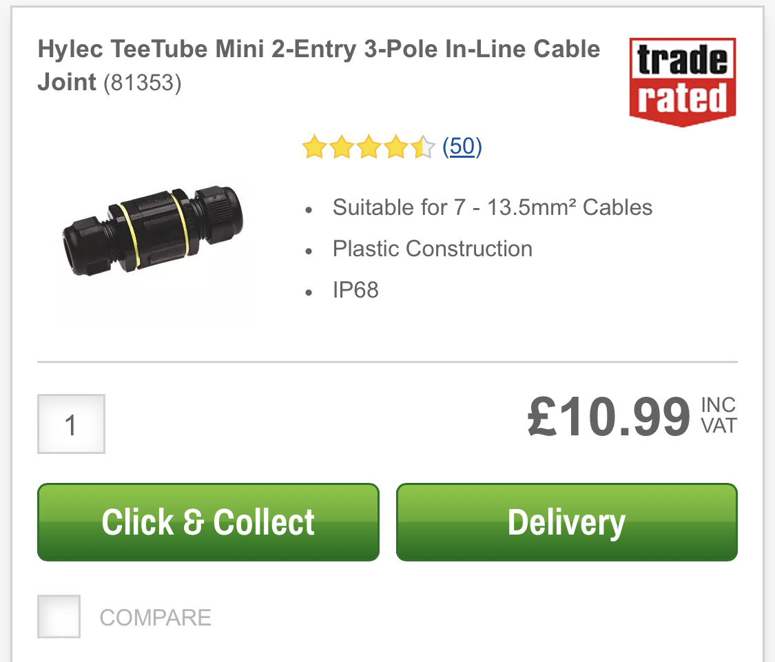

Can you find one for 10mm² conductors that suits twin and earth?What about those gel-filled junction boxes?
No good. Please read the requirement. The OP's cable is 10mm. The Hylec spec saysUsed a Hylec IP68 mini-connector from Screwfix - not cheap at £11, but did the job (and the glands fit pretty well on the flat cable).
Interesting. The spec on that one also says max conductor size 4mm. I'm interested how you got a 10mm conductor in there.I am the OP, and it is good. Sealed nicely with the larger glands:
Easy; just bend 60% of the strands out the way and trim em offI'm interested how you got a 10mm conductor in there.
@RealPolitik how did you do it? Or maybe and (not for the first time) maybe the description is wrong.
Ah. Thast makes a big difference!Conductor size is the cross section of the actual copper bit - when I said 10mm I meant the diameter/width of the three cores plus insulation.
