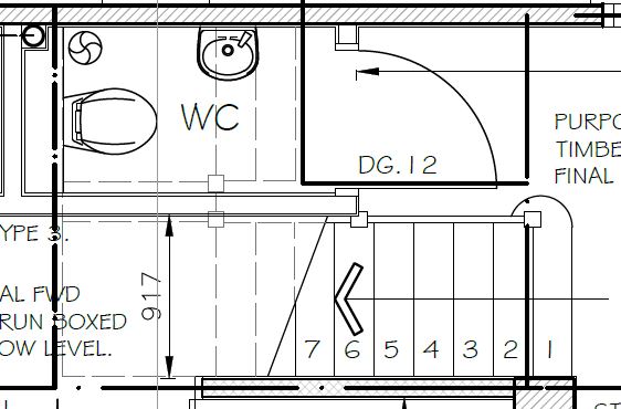

Is it usually preferable to put the light switch on the inside or outside?
On the inside. On both my prievous houses one of my first jobs was to move switches inside such rooms that some idiot had fitted outside.

we are one of the few countries which seems 'allergic' (but not because of regulations) to ordinary wall light switches (provided they are an adequate distance from bath/shower) - hence all the 'pull switches' here.
To be fair, the regs require equipment to be suitable for the environment in which it is to be installed.
So standard plate switches may be considered unsuitable even when installed out of the zones as they could still be affected by condensation or damp. To avoid any situations which could be argued to be borderline, 99% of installers choose a pullcord.
To be practical, there are any number of switches and sockets in my kitchen. They are mostly in easy reach of sinks, subject to steamy environments, and operated by people with wet hands.
No installer would think of installing a forest of pull switches to mitigate any risk.
Normal white accessories are usually IP22 or better, so unlikely to be an issue.
To be fair, the regs require equipment to be suitable for the environment in which it is to be installed. So standard plate switches may be considered unsuitable even when installed out of the zones as they could still be affected by condensation or damp. To avoid any situations which could be argued to be borderline, 99% of installers choose a pullcord.
You are describing the traditional thinking/practices, seemingly almost unique to the UK etc., which is a different matter from the question of whether it is really 'necessary'. Asking manufacturers about the suitability of an accessory for use in a bathroom is also unlikely to help much - since, if you got any answer at all, it would probably be 'no' (or 'cannot guarantee' etc.), in order to protect their backsides.
As has been said, one doesn't see the same thinking/practices in rooms other than bathrooms, even when the accessories are very close to sources of water (and wet hands) and/or there are significant risks of damp and/or condensation. If a light switch is subjected to condensation (or even 'covered in water') it's extremely unlikely that any significant real hazard would result. As I said (although I may be wrong!), I don't think you will find many pull switches outside of the UK (or UK-influenced) countries.
As for 'suitability', the regs are not really all that rational. As far as I can make out, switches (of any sort) are not allowed in Zone 2, let alone Zones 1 or 0), even if they are IP68, and therefore theoretically (electrically) suitable for use in Zone 1 (or even Zone 0!).
