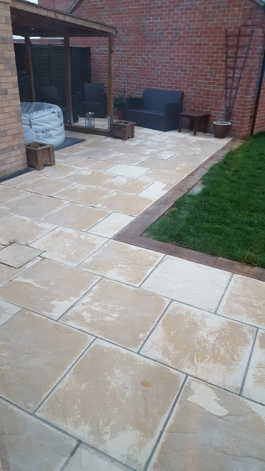

Thanks Woody. Really useful just one thing to add in that corner is the waste down pipe from the bathroom. Although I am doubtful this is a cause as when I dug up the ground for the acos it wasn't really wet. So if there was a leaking pipe I would assume the ground I was digging up would be wet.
Honestly I want to stop worrying about it. As long as the bricks can taken that moisture I would be ok. It just seems so weird. I thought the acos would be the solve.

No. The frost resistance rating is not a measure of water absorbency and the two are not related.
Correct, although many people would think that an absorbant brick would be likely to suffer from frost. The BDA did state there is no connection between the 2.
Also a less absorbant can allow more water penetrarion into the cavity (known as the Raincoat/Overcoat effect).
Answer has been sort. The base of the patio is retaining moisture and has not been construced properly. You can tell by the 2 tone colour of the slabs.
It will probably need to come up. They are Marshall slabs. This is making the wall wet.
No, I refer you back to my previous comment
I've just realise you have an entire 3 page thread where everyone is telling you this is fine, and you've still shelled out money on a non problem and are planning to spend even more?
Do yourself a favour and find something else to worry about. Don't spend a penny more on this.
You can now add these two pages to the previous three.
John, do you know what. I am going to do what you said. I am just going to leave this. Its making me unwell! I can't stop thinking about this stupid patio. I have shelled out so much on it. I am going to take you advice. Which is wait, let it dry and see what happens. It was laid at the end of September, so has only ever experienced wet, horrible conditions. It sits on clay and is mainly north facing.
I think the consensus is, that the bricks shouldn't be wet. However, being wet isn't going to cause any damage as they should be strong enough bricks to take it. If the problem does not go, or the patio does not dry out, then maybe take further action. However, even this is probably not necessary as it is more cosmetic than anything else.
