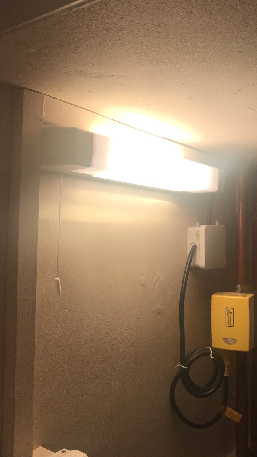

Hi all
My understairs strip lamp has a pull chord. It’s acting up - hard to describe. The chord isn’t taking. Sometimes it pulls down but doesn’t click as it normally does and the light comes on. It flickers a bit.
Could someone kindly advise how to progress please.
I’m sure it’s something to do with the bulb and the switch that the chord is on - maybe it was pulled too hard and fell off some tracker.
many thanks all.
Sounds like the plastic link is damaged.
Touch of penetrating oil required on the switch. Power off MCB first.

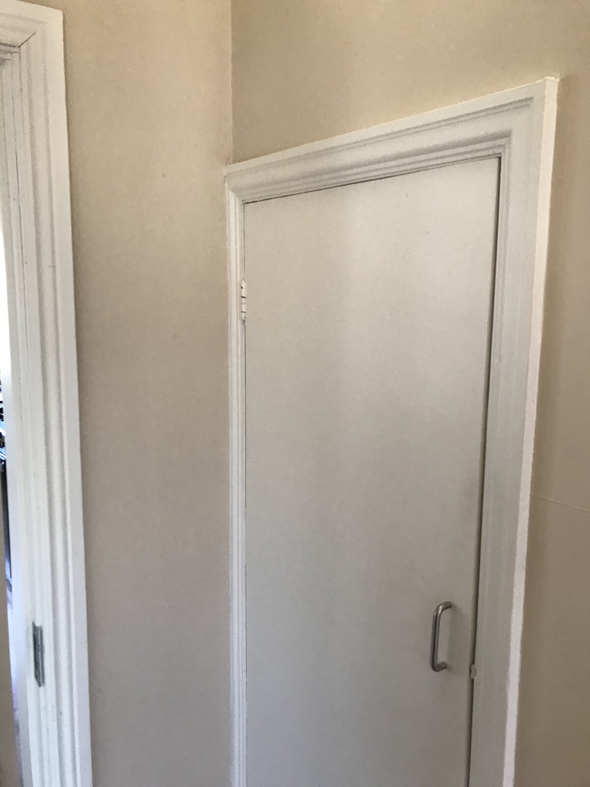

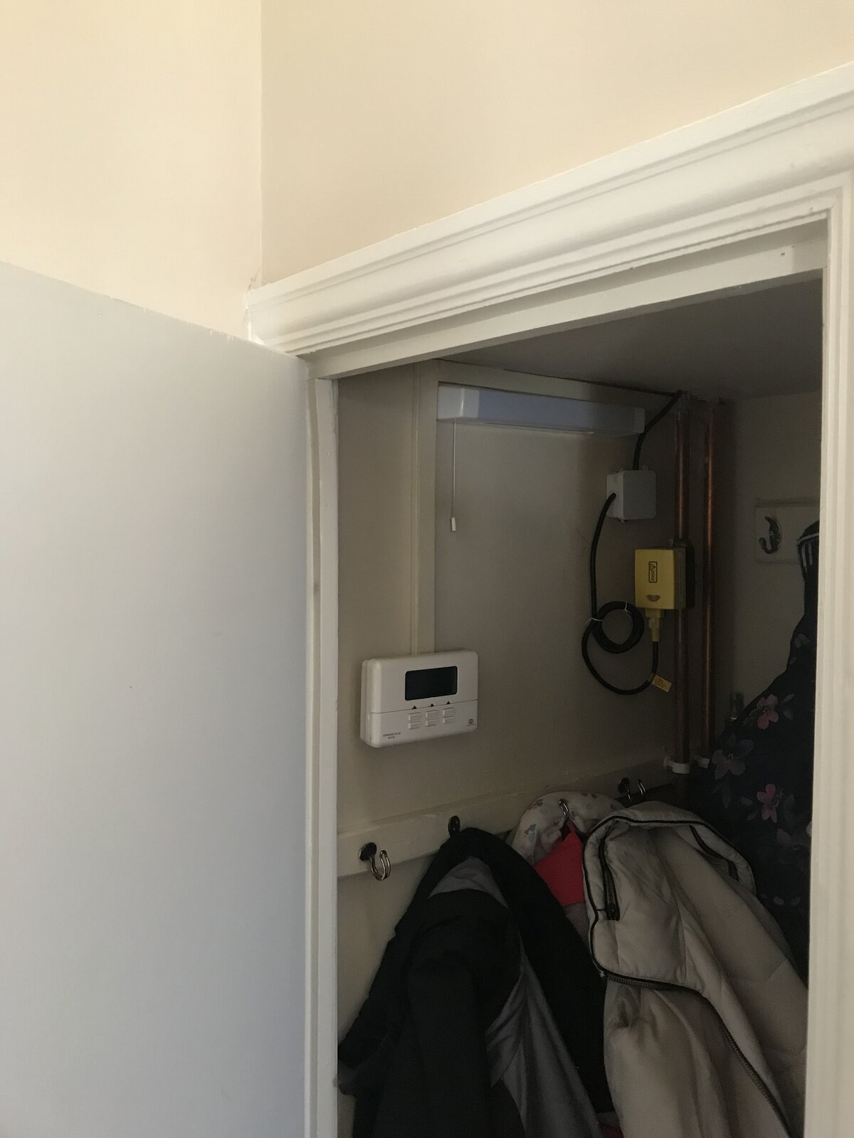

Please post pix of the situation.
You may find it easier with a separate switch nearer the door or outside.
Thanks for the pic.
Can I please see a shot showing the outside of the cupboard with the door open, so you can see the inside and outside of the cupboard at the same time?
It might be better to fit an unswitched light fitting with a separate pullcord switch like you might see in a bathroom.
Something like this: https://www.tlc-direct.co.uk/Products/KBBAT2.html
Switched by something like this: https://www.tlc-direct.co.uk/Products/BG801.html
You could also fit a plate switch on the outside of the cupboard.

Thanks for that. See below
Four options
1. Get a new switch for the fitting.
2. Fit a new switch somewhere else
3. Buy a whole new fitting
4. Bypass the switch so the light is no longer switched, but rewire the feed so it comes on with the room lights.
Simples!
If the fitting cannot be fixed, I would be tempted to replace it with something a bit brighter.
But having looked at the cupboard, I would ask these questions:
Do I go in there often?
Is the existing light bright enough to see what I need to see when I do go in there?
Is the existing pull switch a pain to reach?
If the answers are no yes and no, I would replace the fitting with a similar one or repair if possible.
Also check the front diffuser is clipped on properly, them fittings tended to have a safety switch fitted preventing them working with the cover off, proberly not the issue but worth checking.
