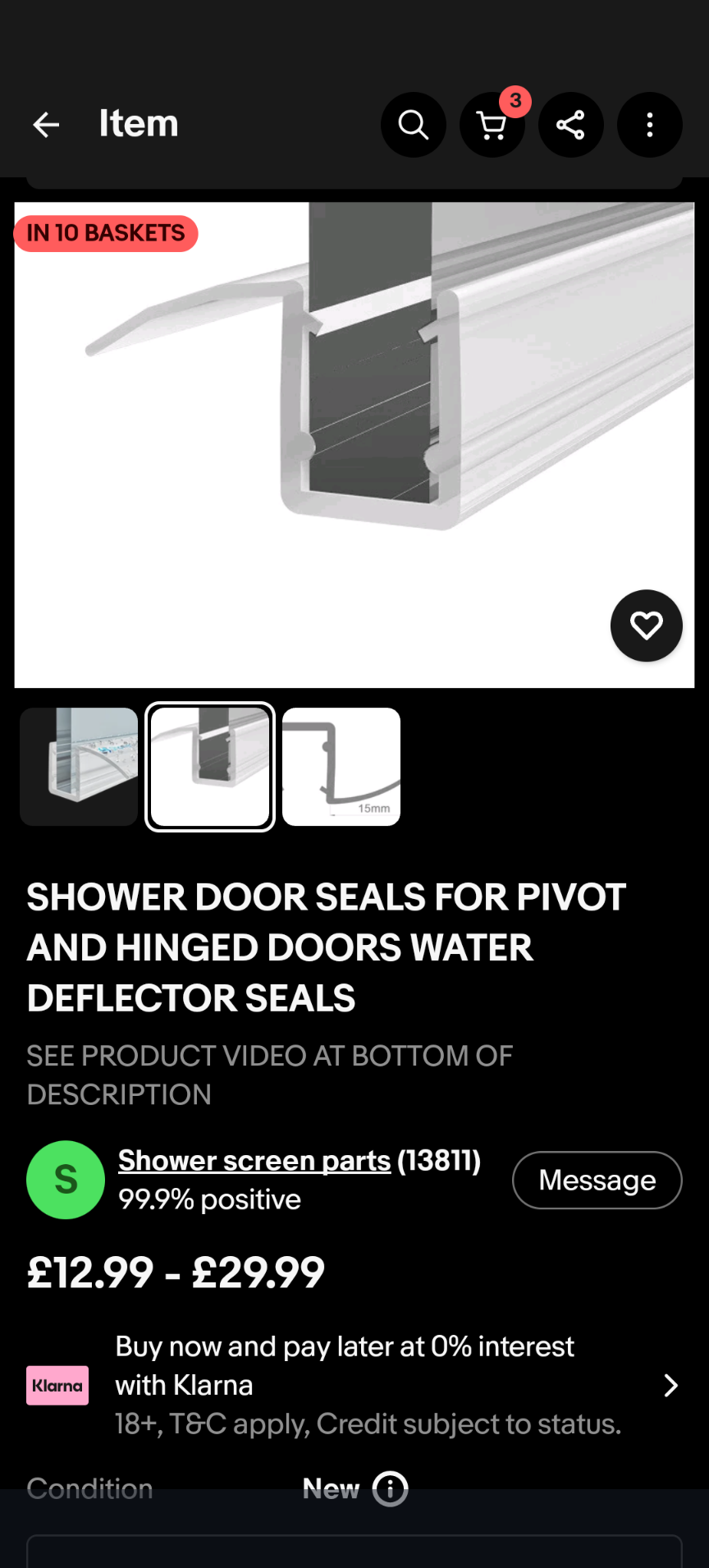

I just thought of another question: my door, which has a hinge arrangement exactly like yours, has a seal glued on the bottom of the door which has come away and deteriorated at the hinge end. What did you do about the seal on yours? Was it OK to reuse or did you get another, in which case do you remember what type?
Thanks again,
Peter (mlcprs)
Yes.
My seal (a horizontal flat length of plastic) came away last year.
I tried super glueing it back on and it came off.
I tried without it, but shower leaked into the bathroom.
So I got the following and it has worked well.
I do not have it where the hinge is (because it does not fit onto glass there).
I cut it with a small hack saw, at the end were the hinge is so the other end loos perfect.
I slightly rounded the curved bit with sandpaper at the handle side of the door as it was a bit sharp and it scratched my foot.
I did not glue it so I can take it off and clean it.
It does protrude into the shower more than the old one.
And it is perhaps less professional looking.
But works well (no leak including from even the hinge side).
I have had it fitted since Sept2025 (1 year) and it has not yet gone green at the u bend bit.
8mm glass.
£12.99
