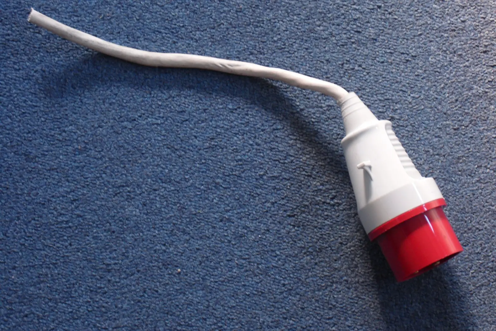

This is what a 2.5mm² flex looks like having powered a catering wagon from a 5.5KVa genset or 32A MCB
How big was the load on this 32A circuit. Per BS7671, 2.5mm² flex has a maximum CCC of 25A.
Kind Regards,John
Kind Regards,John
I did measure But I don't recall, however it was protected by a 32A MCB at that time (Not that cable though) so theoretically only 25ish% overload possible
Fair enough. Strictly speaking,of course, 2,5mm² flex is not adequately protected by a 32A MCB.
I certainly wouldn't expect a "25ish%" overload to do harm to a cable very quickly, but if the overload persisted for a long time, that might be a different matter.
Also, don't forget that a 32A MCB does not impose a 32A 'ceiling'. A 32A MCB will allow about 46A to flow for about an hour (and highre currents than that for shorter periods) - and that would represent something like an 85% overload for 2.5mm² flex.
