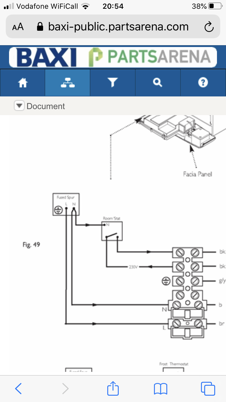

Not correct. All of the connections are made inside the boiler.

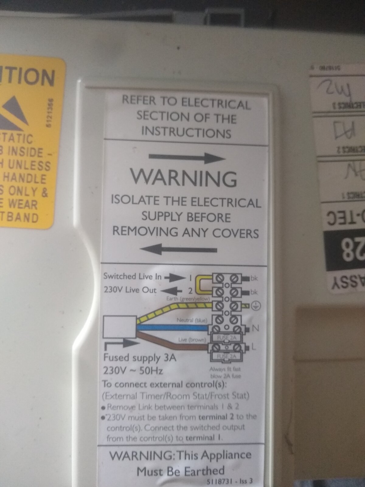

Pick up the LN&E from the boiler mains terminals. The two thermostat connections are Linked inside the Baxi, remove the Ed blink and that’s where the stat goes. Check the installation manual for confirmation - I’m no boiler expert!

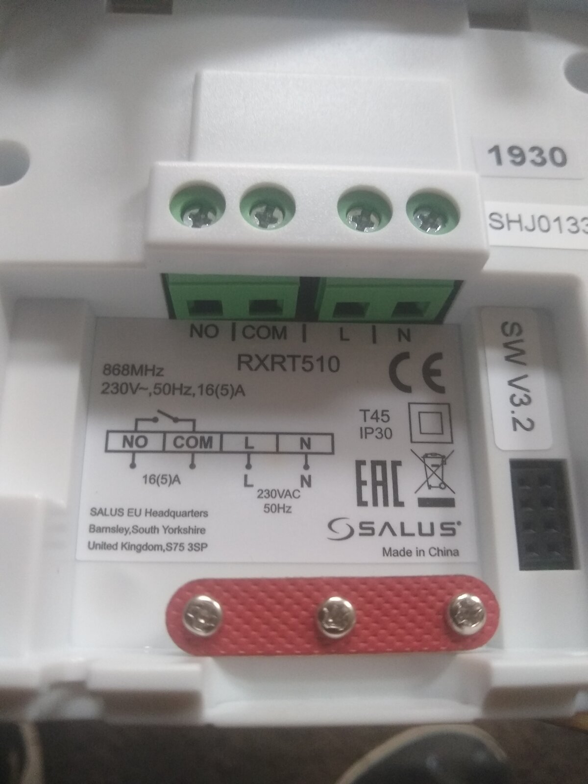

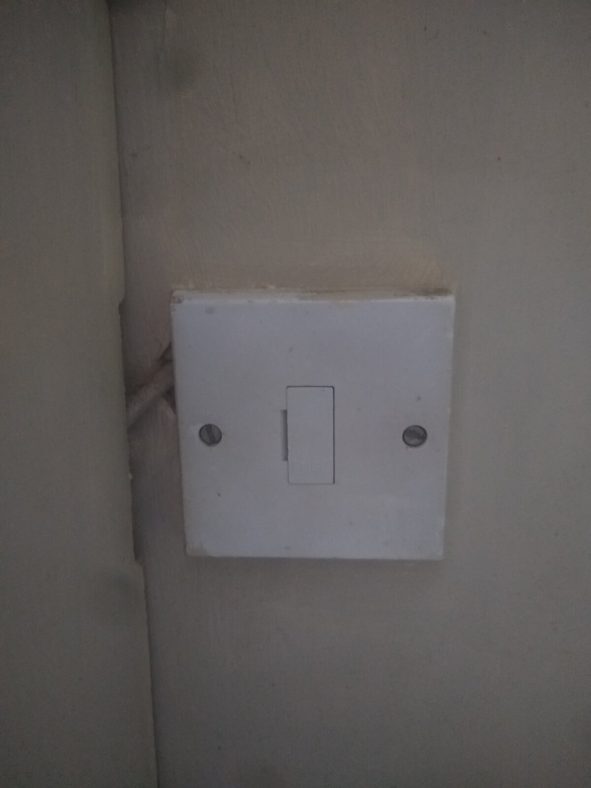

I have now received my wireless thermostat: Salus RT310RF
My boiler is a baxi duotec 28 HE A
This is what i currently have:

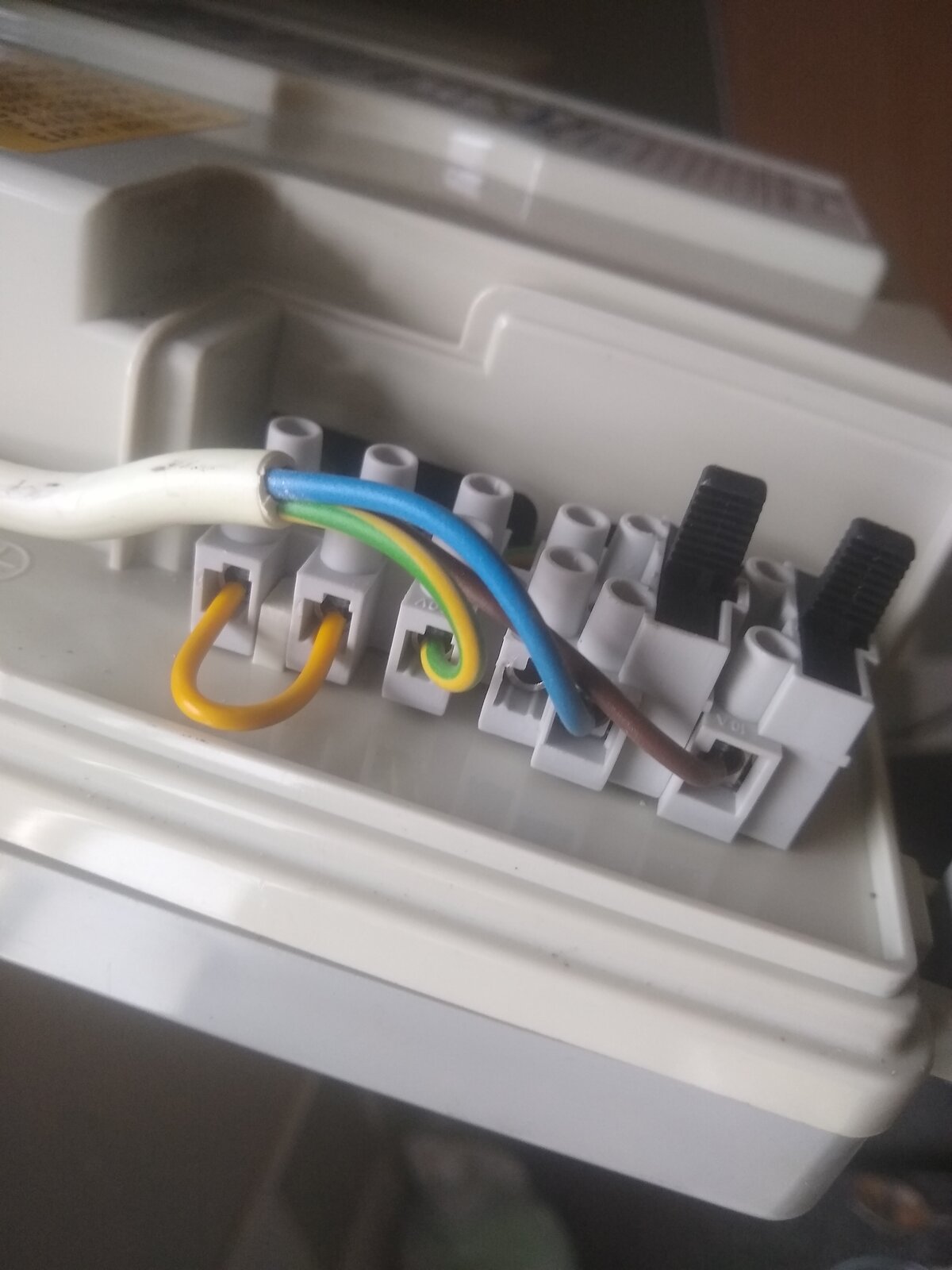

A fused spur with cable supplying the boiler with mains power (as per pic below)

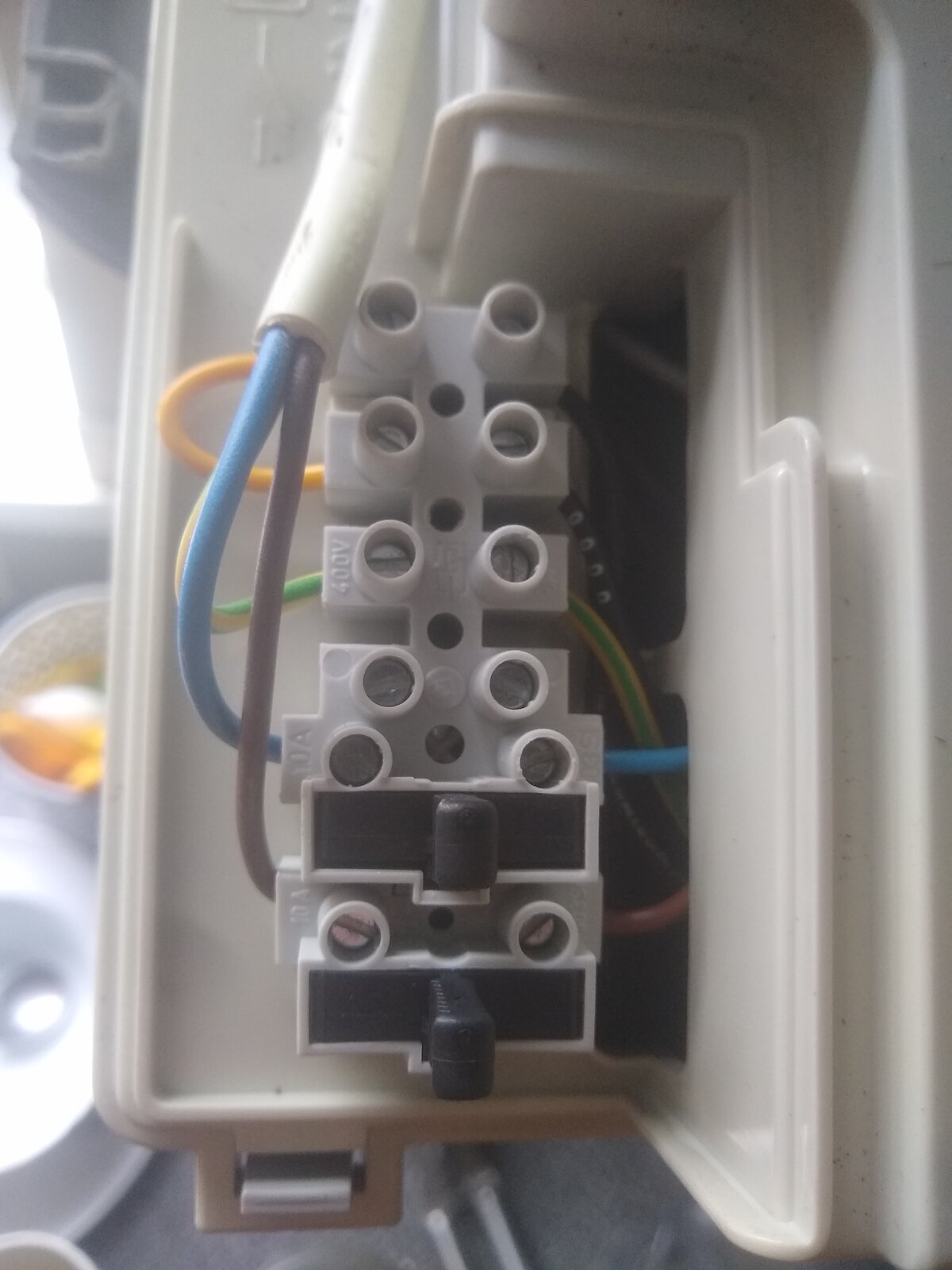

This is what the terminal block CURRENTLY looks like inside the boiler where the connections for thermostat will be made
This is the wiring diagram on the boiler:
This is the wireless receiver which i need to connect to the boiler:
This is the wiring info in the manual:

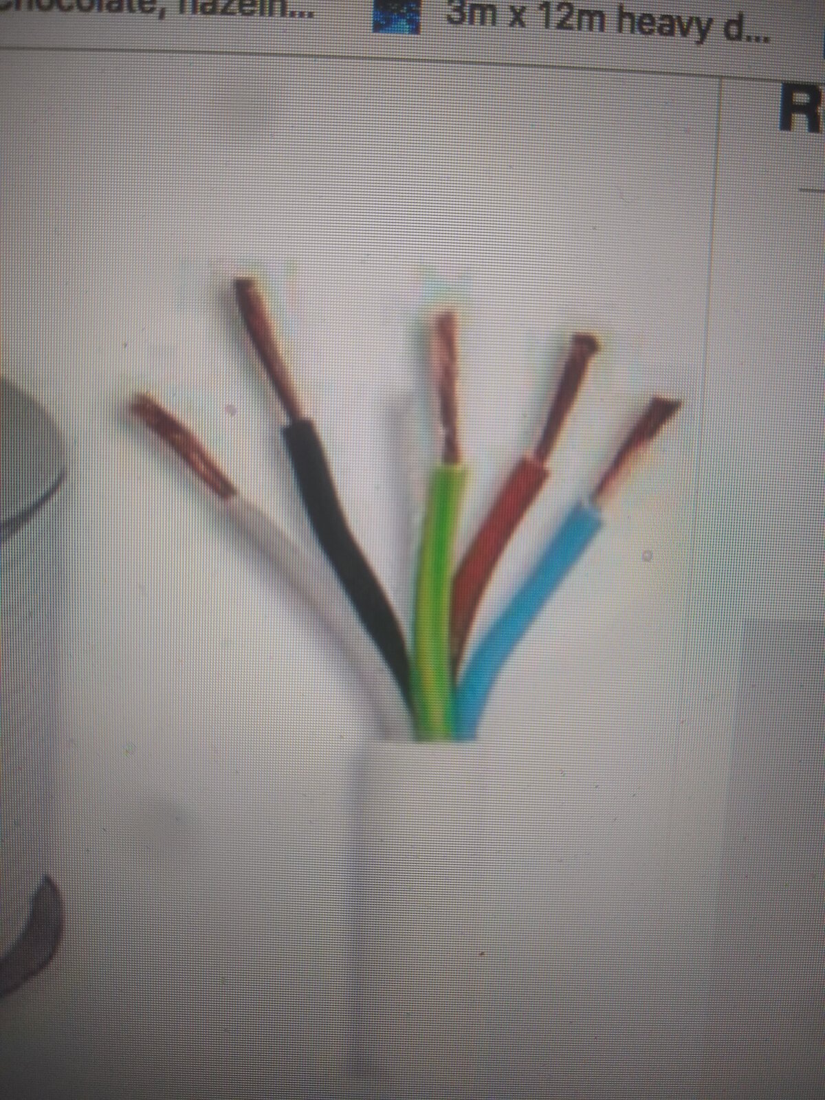

And finally, this is the cable that i have purchased to wire in the connections. It is 0.75mm 5 core heat resistant cable.

That fused connection unit ought to be switched.
Or swapped for a plug and socket arrangement.
Is that neutral connection on the boiler fused?
Ok i'll get a front plate with a fuse and switch - i assume wiring is like for like?
Not sure regards to neutral connection on boiler - i can't see a fuse in there? The white cable running into terminal block is the one directly from the fuse box on the wall
EDIT: Wouldn't the fuse be underneath the black 'bits' that can be seen in the picture? Or should these be removed and replaced with 2a fuse?
The wiring will be like for like in that you will have an incoming supply cable or cables feeding the incoming (or feed) terminals of the switched fused connection unit. Then you'll have an outgoing cable to the boiler connected to the outgoing (or load) terminals of the switched fused connection unit.
But the positions of these terminals will differ. Don't forget to swap the fuse for a 3A one.
Don't alter the fuses in the boiler. I commented because it does look as if the N connection is fused, and there are not normally fuses in the neutral conductor.
There could be a solid link in the fuse holder instead.
Have you got the boiler instructions?
