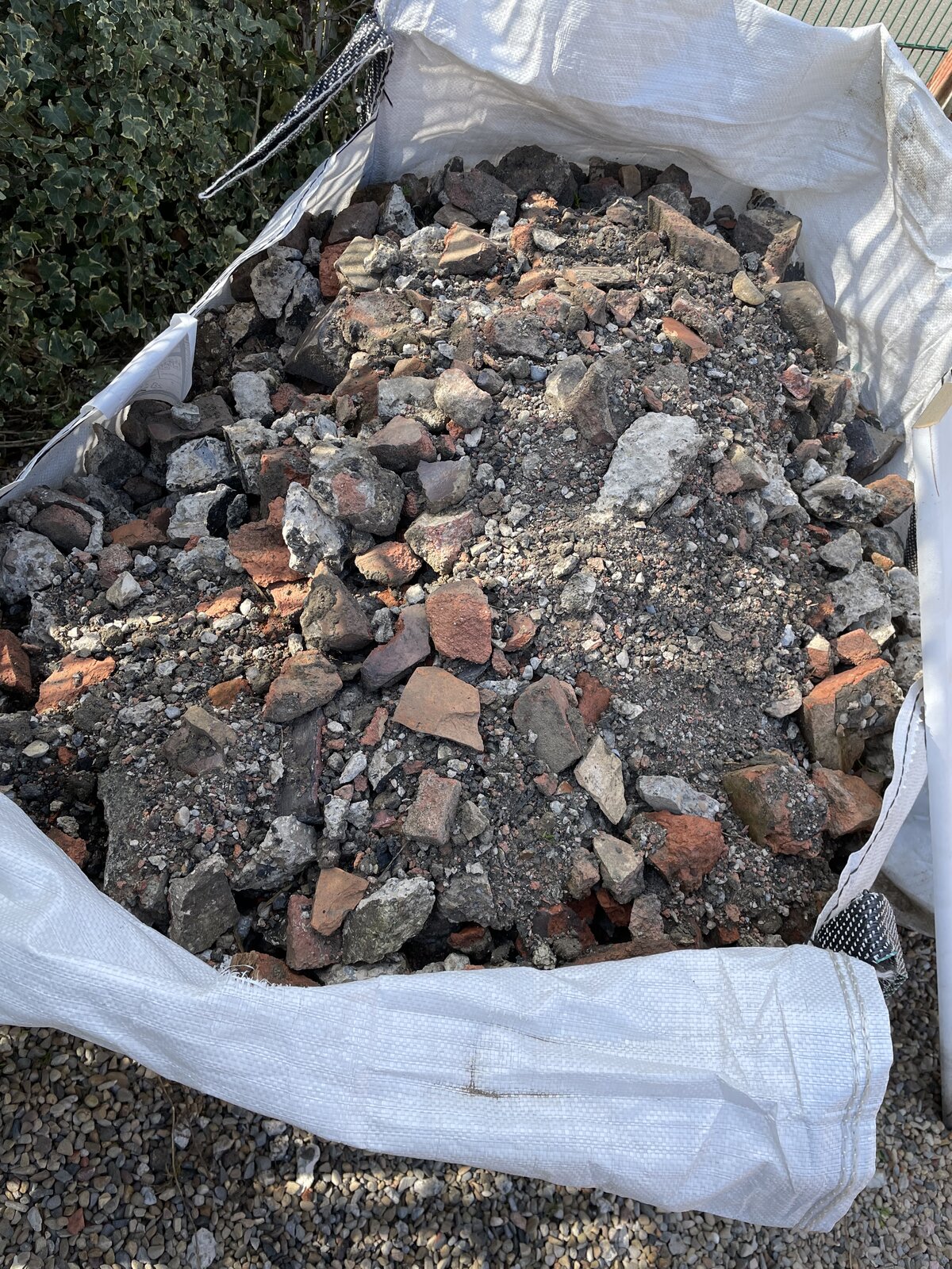

So I have bought a metal shed and have some 60cmx 60cm reinforced slabs to lay…
My plan was to do a hardcore mix (whacker plate) followed by a dry mix and slabs…
However for the hardcore mix what I plan to reuse lots of old rubble, mainly chunks, that I already have (see pic) however what should I mix with the rubble to make it more compact …
I will be using a whacker plate afterwards
Those bricks look small enough to be whacked down on their own.
