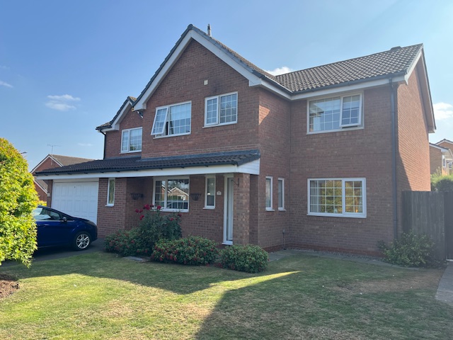

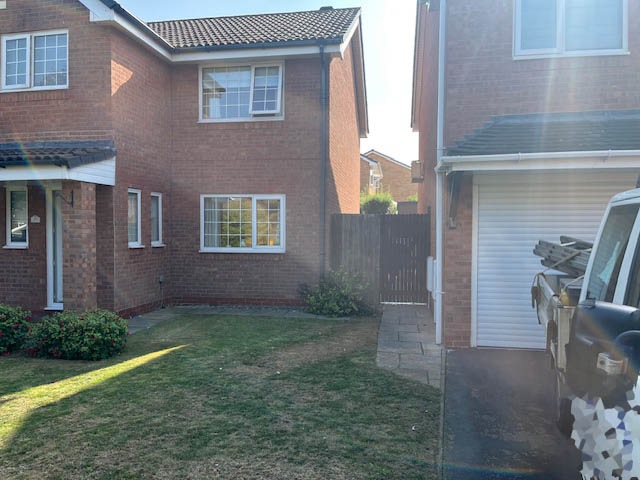

I have a problem neighbour (silly anti social stuff but annoying - don’t want to report anything in case it devalues my house if I sell) and want to monitor my property along a fence line without infringing their privacy.

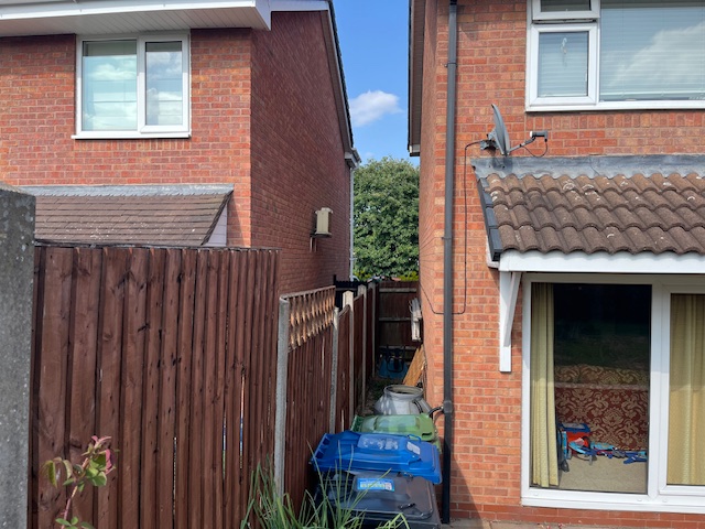

The area is between the gable ends of our two houses. Each of us has a path of 3ft separated by a fence (6ft high). Both ends then extend into a rear and front garden. Total run is probably around 30 metres.
Is there any way I can achieve this - film my side but not his? I appreciate that a low level camera/cameras might do the job but getting power to them might be a problem (happy to hear suggestions though).
The ideal would be something I could mount onto the gable end of my house (probably at loft level as it is an easier access for any power/cabling).
I have also thought about using a dummy camera just to put the frighteners on him.
DIY install preferred
TIA

He'd have to see at least one of the cameras due to the area that needs to be covered, although I could probably cut a hole in a panel which is fitted where a gate would normally be.

Probably can get some power to various points from bedrooms at gable end - is this just a case of running a DC cable through a hole in the wall then plugging into a socket inside?
Images of house attached - front and back of side entry shared with neighbour and a couple of the front.

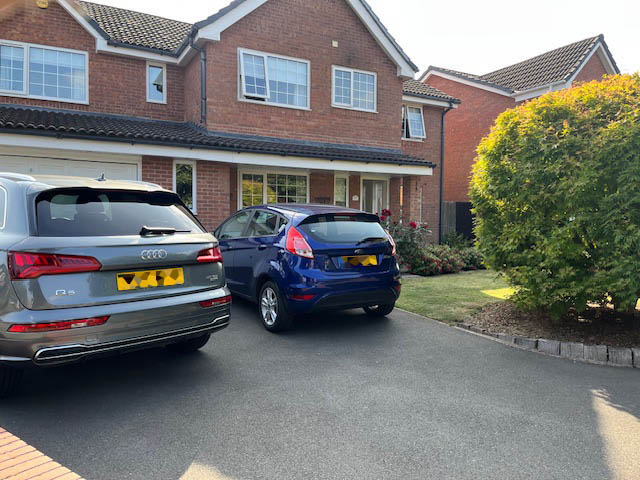

Main priority is to deter idiot neighbour from doing something stupid that we can't see or whilst we are away along the boundary between the two houses (you can see the dead grass on the front lawn where he has swept chemicals off his path!). Whilst I'm at it, I'll probably put some other cameras up to cover the front of the house (suggestions for positions would be appreciated).

Cables can be run to each point, my preference is hard wired and POE cameras on an NVR.
WiFi cameras are easily to interfere and have issues with compared to hardwired ones for the image/video feed.
You can place a camera for the view you want and mask out the areas you don’t want covering.

You can have what ever you want and just use the cameras privacy mask to section off along the boundary.
You only need to recognise its the neighbour doing the deed at any point along your boundary.
I personally/ professionally would go POE and not have a wifi connection issue, its easier for your neighbour to take out the wifi but unlikely they would.
In general with location its as simple as can you get a cable there and would the camera get the image that you want.
Something covering the drive, something covering the front lawn, something covering the recess as this is where you neighbour gets to the front of your property.
Gable ends and something at the back.
