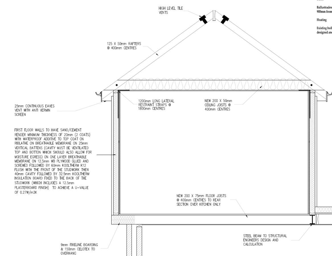

What does this specification mean, its a side extension wall.
26 Aug 2007
507
8
London
Hi All.
I have the specification attached, I would appreciate it if someone can explain to me in lay mans terms what it means, so from outside, what is the composition of the upstairs wall. I can see that the outer wall needs 2 coats of sand cement, with the top coat having a water proof additive.
Can someone please explain to me the various layers until the internal plaster board.
Is that a UK specification?
It's funny but the holding down straps will likely stop the roof from being blown off. However what will stop the whole lot lifting off the wall?:whistle:
A few panel pins should suffice.
In layman's terms .... your plan drawer is sh'ite.
Get him to detail it properly so that you can see what needs to be done.
