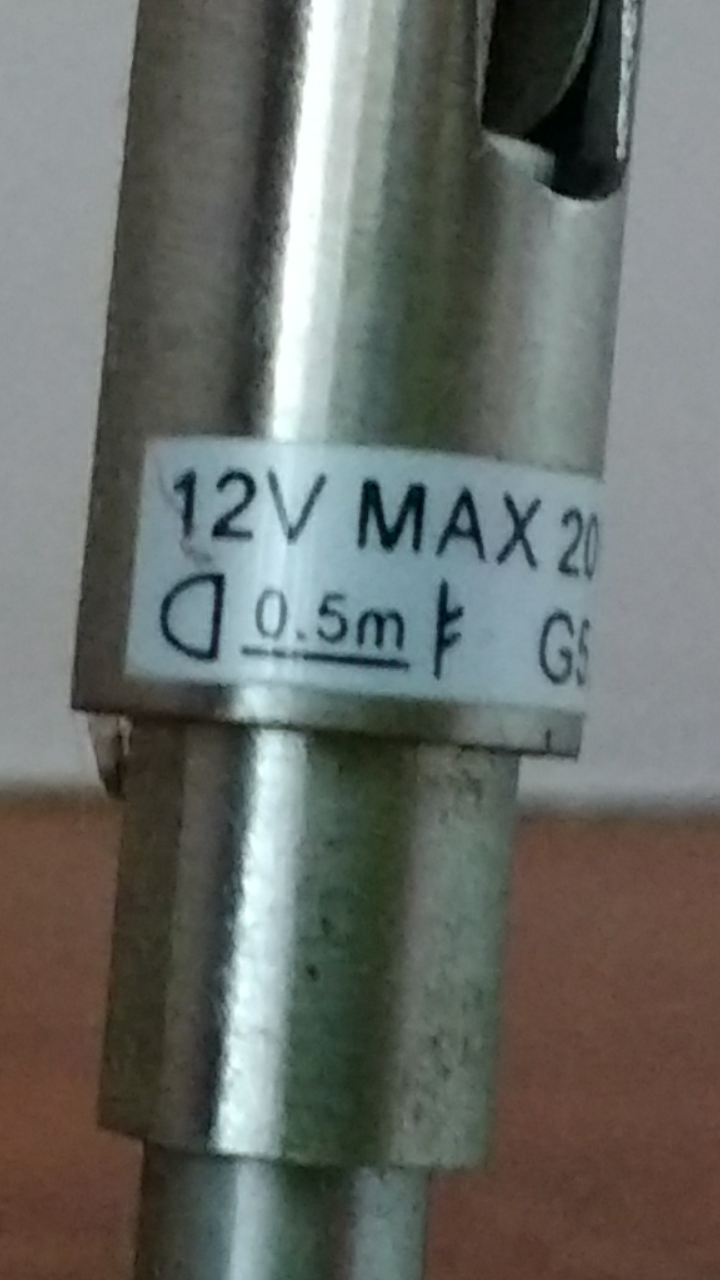

What does this symbol mean on this swan neck light fitting please? The symbol that looks like an F after the 0.5? Can't find it with Google. I'm hoping its an obscure symbol for double insulated.

Minimum distance from illuminated surface 0.3m – distance depends on wattage and reflector. Usually only used for products with reflectors built in or MR16, GU10. Ensure light source is not too close to surfaces causing them to overheat
https://www.pagazzi.com/faqs/
In other words, keep it away from walls/cupboards/etc that could get slight scorch marks, or anything that could burn(curtains, etc).

OK looks like my guess was wrong.
