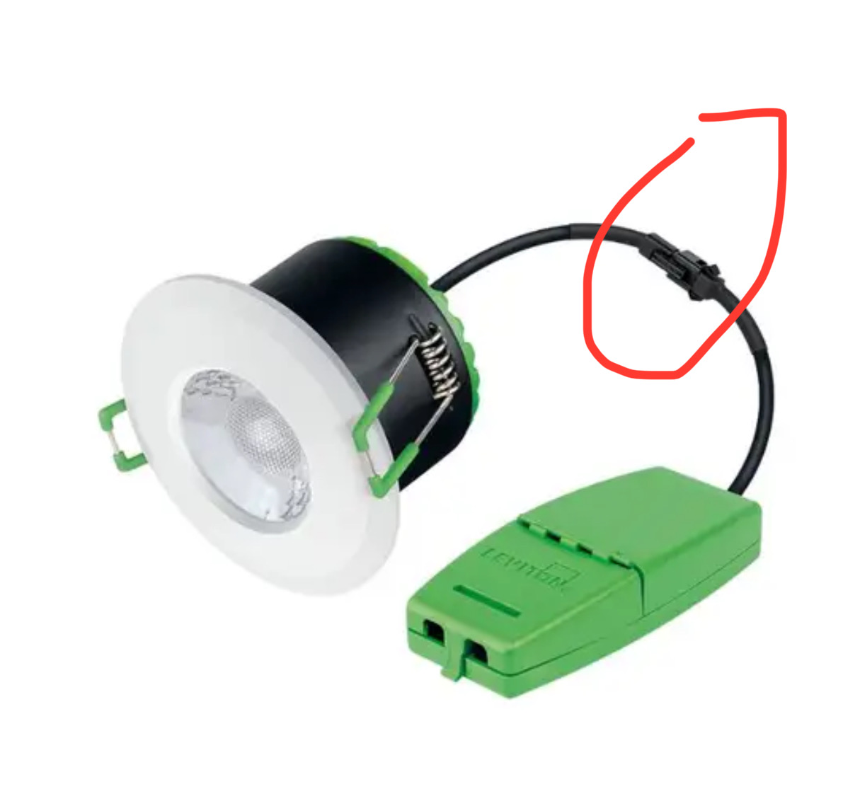

What fire rated downlights are you all fitting?
Its all in part L isn’t it.
No.
A replaceable bulb fitting that can be replaced with a Tungsten bulb will get a lower EPC than a fixed LED un replaceable bulb.
So the millions of properties that have pendant lighting will get a low rated EPC. As will those that have any other types of light fitting with G9, G4, GU10 and all the other styles of replaceable lamps, and all because someone might go and buy some inefficient incandescent lamps that are obsolete and have been off the market for years.
No.
Yes that right
And is another indication of how stupid the EPC is

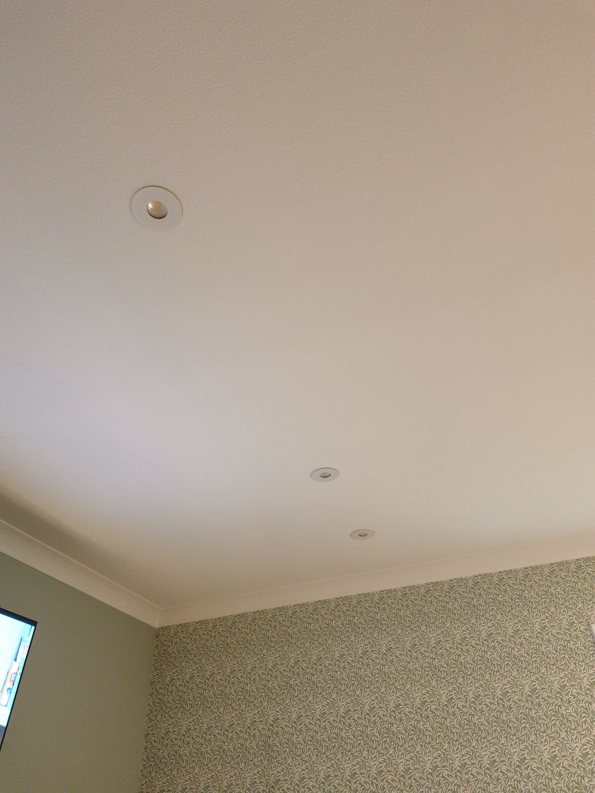

I'm regretting that blinking paper already. Bill Morris, I thought would be good. I saw a sample in the shop, but when it's hung, you can see the repeated pattern and it does my eyes in something rotten.
That's a massive job filling the holes and IMO you will always be able to see where they were - are you good at plastering / filling - or have to pay someone to do it.
Replacing with new GU10s would be much cheaper. Replaceable bulbs.
But the issue with replaceable bulbs is that it will affect your EPC and will lower your score due to Part L
How is filling existing holes a massive job?
Cut some 76mm board match existing, batten, but scrim over it.
Wide filling blade/knife and tub ready mixed Gyproc lite or similar.
Have you ever done it in a virgin perfect ceiling. You will always be able to see where it was.
with whatever GU10 lamps are desired.
Not sure if that is true? Can one fit plastic bulbs and still comply with fire rating? As in the main, were designed to work with glass bulbs.
Not true, and no one cares about EPCs anyway, they are just a thing people are compelled to get when selling a house.
They are also grossly inaccurate and only cover certain items that the software knows about.

One would think fire rating was like ingress rating, and would have some number like the IP56 excreta? And to maintain the rating it would need to be used as the manufacturer instructs, so the big question is, can a plastic lamp be fitted in a fire rated fitting, and it retains the fire rating? I don't know. Will be interesting to see replies.
Lamp type make no difference it's the fitting that is fire rated.

Since a LED GU10 is made of plastic not glass, fitting them instead of glass unless authorised by the manufacturer could completely change the fire rating of the whole device. So I would simply not fit LED GU10 lamps where the lamp forms part of the fire rating.
