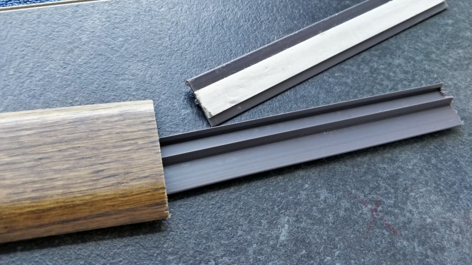

I bought some threshold strips that have a pretty useless adhesive strip on them.
Already tried it and it failed within a day as the floor is concrete.
So I thought the next best thing is maybe a glue. No more nails, gorilla glue? etc..
I know some glues melt plastics, so what's the best option?
Any thoughts, suggestions appreciated..
Thanks in advance
Each to their own I suppose. In commercial work they are always screwed (for obvious reasons) but even in new build housing that's the only type/approach I've ever seen

i screw them down to timber floor normally. i refuse to drill concrete or screed though, since i went through a plastic central heating pipe that had no business being there.
So if sticking something and there is dust it won’t stick. So using primer or a mix of pva and water will help glue stick.
You screw down , the adhesive you referring too is to prevent flooring movement not to hold strip down.Flooring needs to be able to expand hence you can’t glue down safely.
