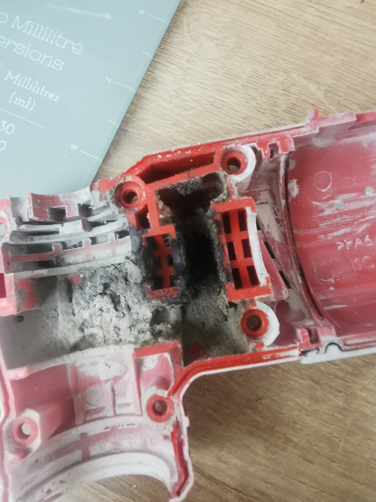

Hi all,
Had my Multitool apart as it's full of dust from cutting plasterboard, the grease in there has now also become a clogged up goo, I want to remove the old grease but what type should I replace it with?
Chris
I do not know the answer, but I do carry lithium grease in my rucksack.
It comes in handy (not sure if it is the correct grease though), but perhaps you need to consider using a vacuum to suck away the dust when working. It is a bit of pain, but when working, I try to hold the vacuum hose next to the blade. It prolongs the life of the tool and cuts down on the mess.

Clean all the dust first, then use either lithium grease or moly grease.
My preference is moly grease for moving parts that get hot, but lithium grease is good as well.
Lidl sells lithium grease spray cans which you can direct exactly where you want it.
I used to have a tub of white grease from Ford, excellent stuff, but can't find it anymore.
