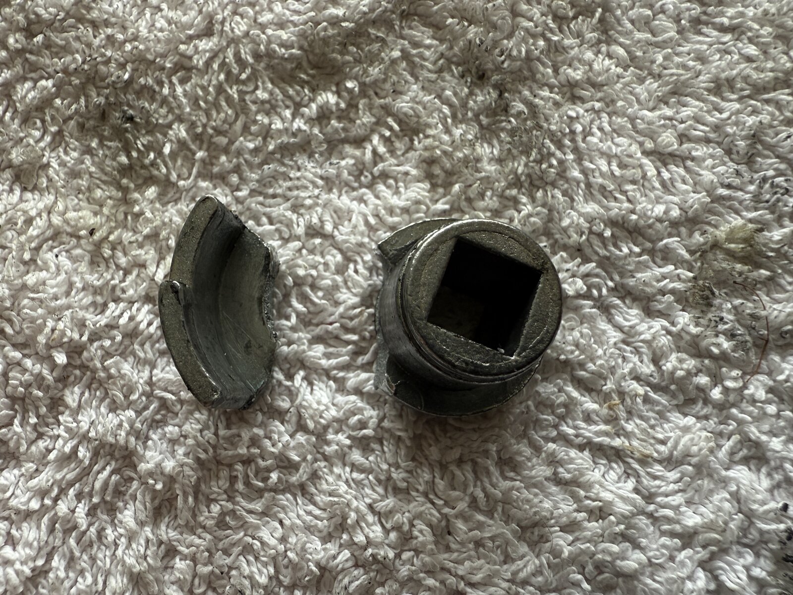

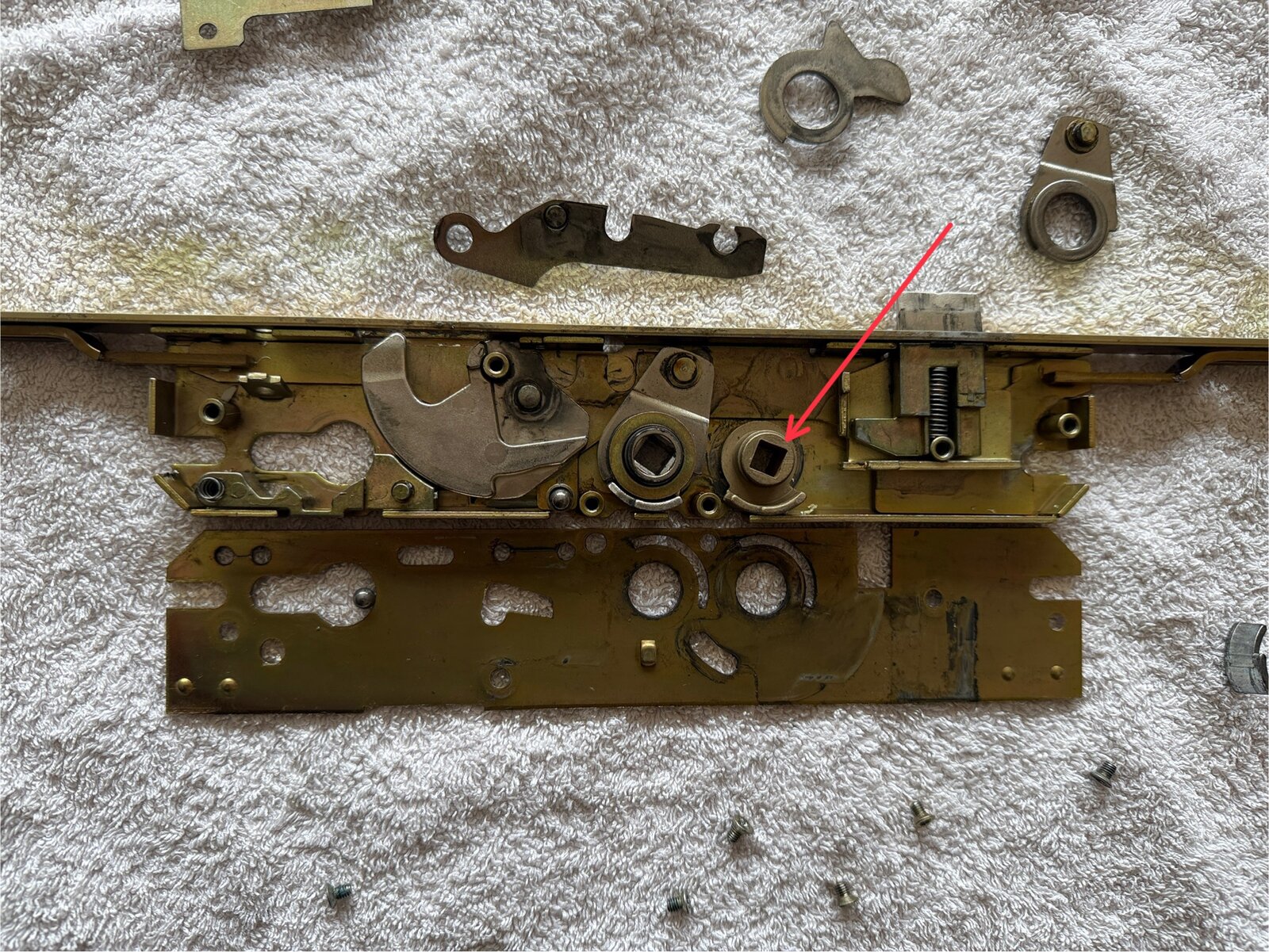

Fixed! Having repaired it once nearly a year ago, I was confident of another successful fix. It was the inner handle cam that broke last time. The lock was always a bit stiff afterwards. Anyway, so confident of what it was, I ordered the part in advance of stripping the lock down. Sure enough, it was the same cam that had snapped but it did look like a pretty cheap and lightweight replacement that I had fitted previously.
The new cam this time looked to be made of a better quality metal. Only £9.20 instead of nearly £200 for a complete unit. Took me no time at all to remove, strip, repair and replace but this time, like a master horologist, I gave the whole mechanism a good clean and lubricated it with some grease before reassembly. Works a treat and has a far smoother operation than before.
hope all those oil parts are not on a nice clean carpet or towel! - you will be due a belt round the ear from the misses
