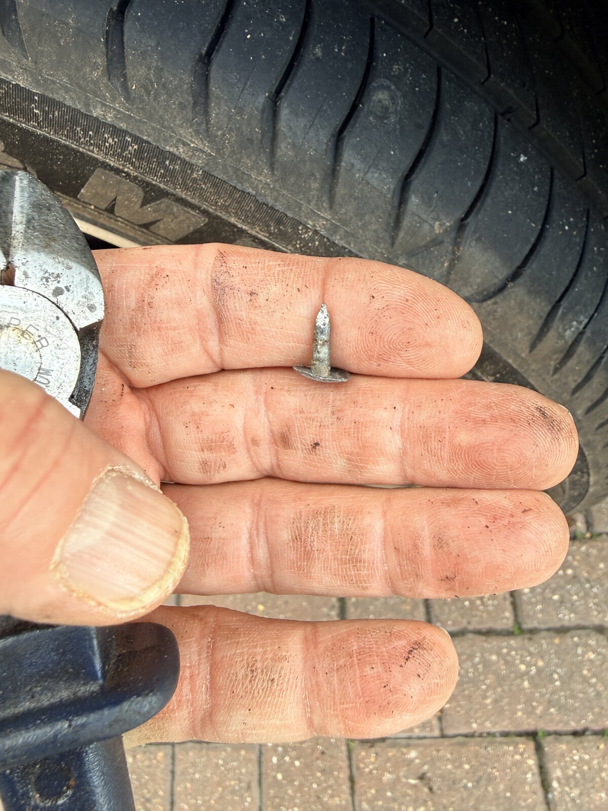

Found a short clout nail in the tyre of the Tucson. Pulled it out, no 'hiss' but when I tested it with soapy water there was the very, very slightest hint of a leak. Absolutely minimal but it was on the shoulder so not in a repairable position. I emptied a bottle of slime into the tyre and it sealed the leak so I’ll just keep an eye on it through the TPMS. Not much change from £200 for a new one fitted and balanced if I go that route. My neighbour was repairing his shed roof the other day so I suspect that’s where it came from. Can’t prove it though.
Photos can be deceptive, but that appears to be in the repairable area of the tread.
