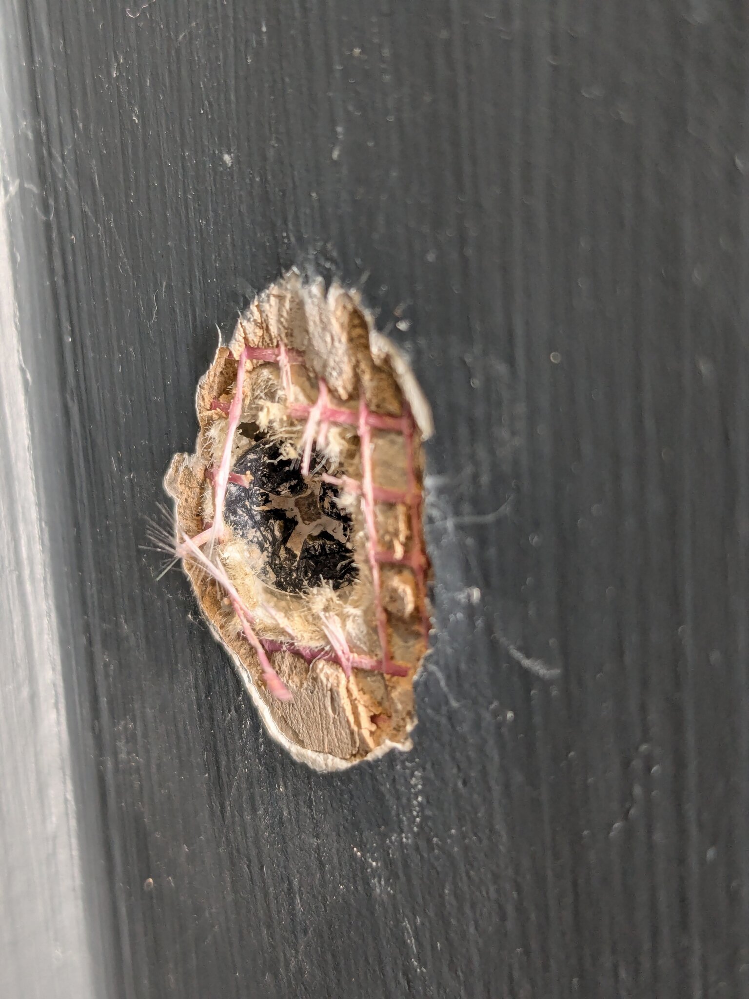

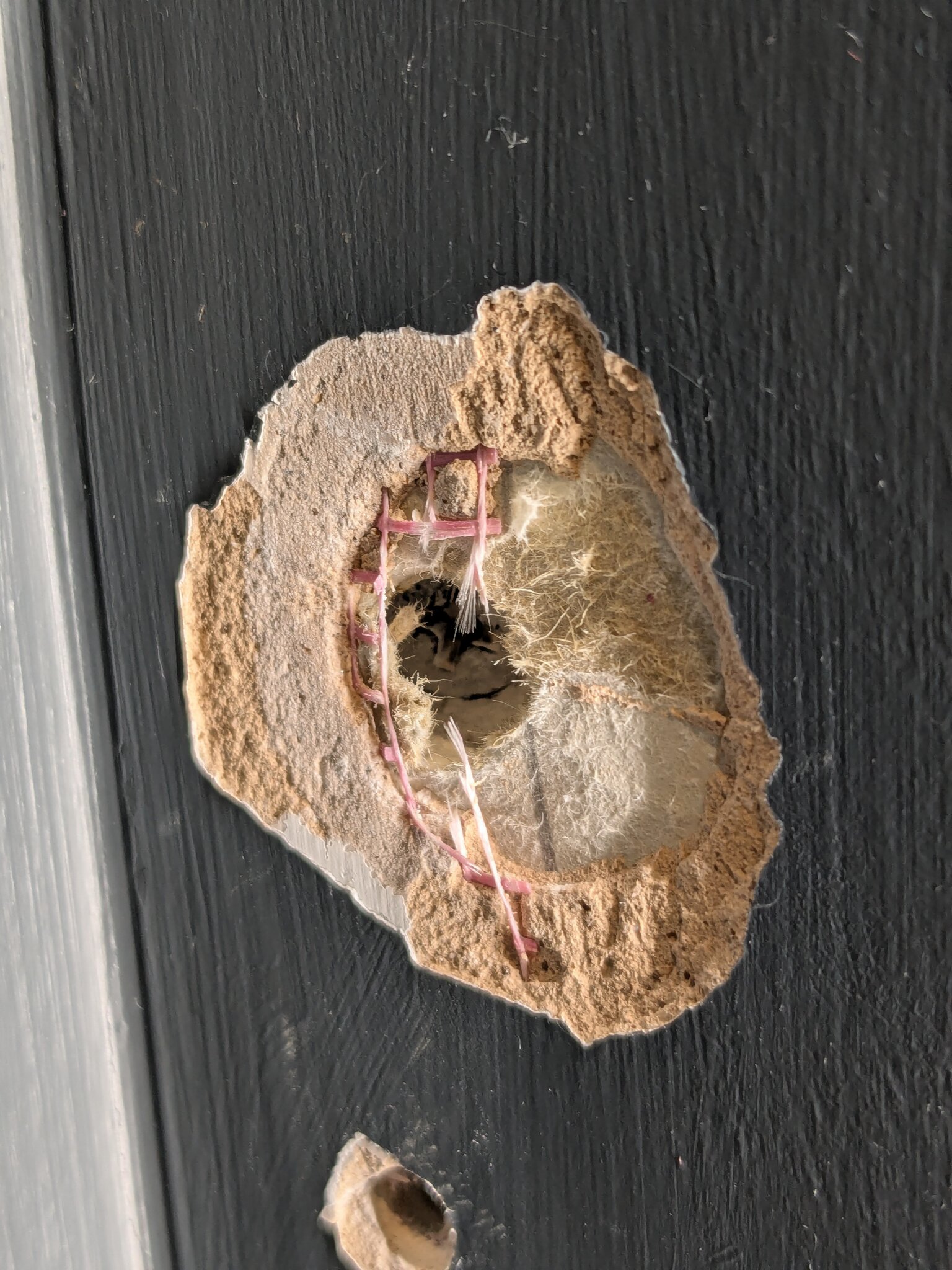

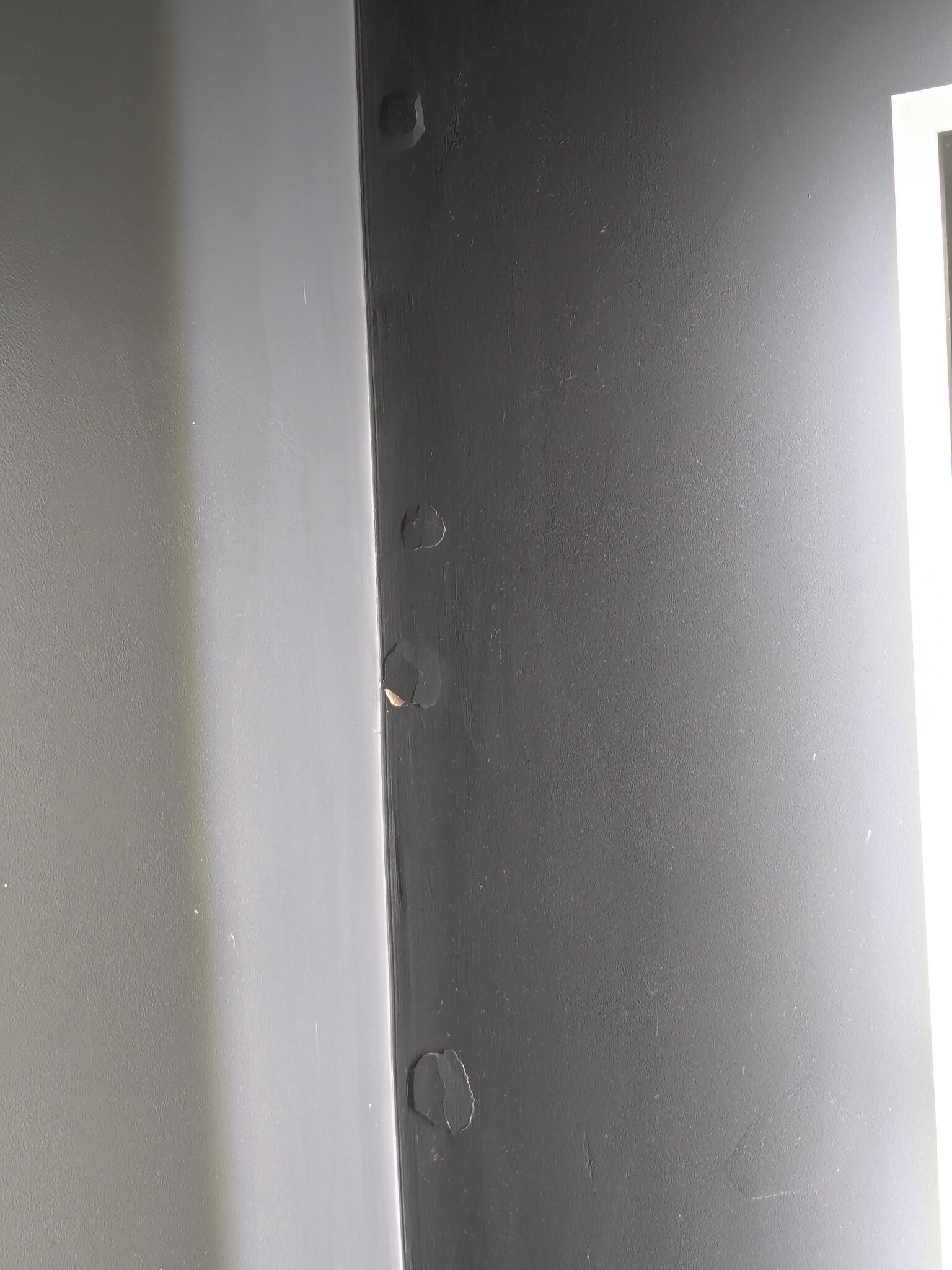

What is causing these screw pops?
I would drill elsewhere, finding a decent place for screws to fix and then fill in old and new holes.
From the photos, it kinda looks like you have plasterboard over a moisture resistant backing (maybe).
I would expect that there is a timber stud running along the wall. I have no idea why the screws are at an angle.
I suspect that the problems are the result of the screws being buried to too deep.
Try drilling above or below the screws holes and see if you can get a decent fitting.
Standard plasterboard is 9.5+mm the backing might 18(?)mm. If so, a 50mm plasterboard screw might suffice.
I previously tried driving in a 75mm drywall screen just beneath one of the existing screws. I drove it in straight/perpendicular, not at an angle, and it never bit. There's clearly just a void directly behind these screws.
Could it be that the stud somehow sits in the corner of the wall (remember - this is a dormer) and that is why the plasterer used very long screws and driven them at an angle?

I think the screws have gone through plasterboard and are not doing anything.
The plasterboard is loose as not tight to wood so this pops the plaster.

What makes you think the screws are in at an angle?
Just move screws left or right if required.
Also screws should be just below surface not driven in at high speed with a impact drill.
Think that's why they are so deep.
I think you're over thinking this.
Take me 60 seconds to move screws and 2 minutes to fill holes including mixing a bit of filler...

I think what seems to be happening (as someone else suggested earlier), that the PB isn't sat tight with the timbers, but it is sat on some insulation, allowing it to flex when pressed. Someone then leans on the panel, then the PB moves back, popping the plaster out from the screw heads.
OP - if you press on the PB, does the PB move slightly, in relation to the screw heads?

To be honest, when I push against the wall I can't see any movement. However, I suppose it only takes fractional movement over the months for the screws to pop.

The screws are definitely at an angle. When I remove them, they are pointing in towards the corner of the wall. As I mentioned before, they are very long and only bite right at the end of their range, suggesting the timber stud is strangely placed. Also as I mentioned before, I tried driving a screw in perpendicularly and it didn't meet any timber.

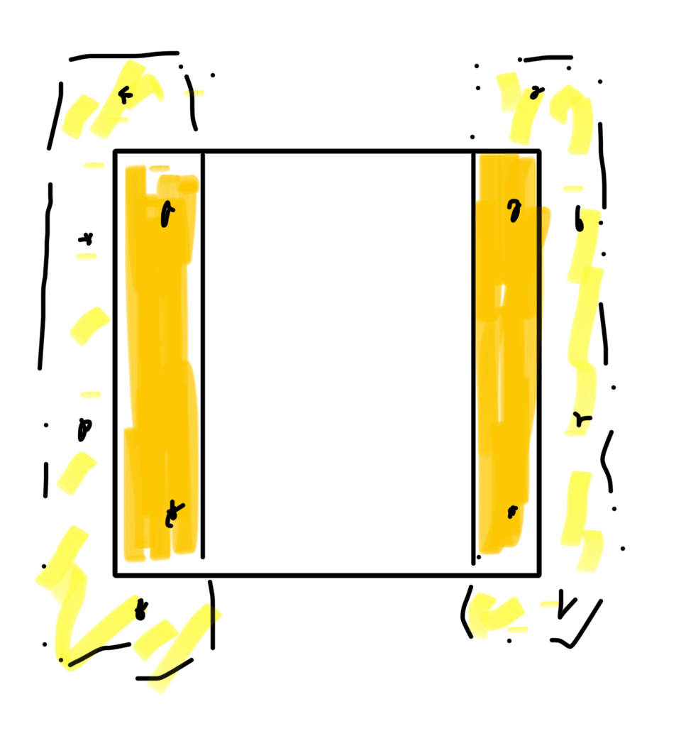

Once you’ve cut eg a 10 inch square and carefully removed it you’re looking at a neat hole in the plasterboard. When replacement time comes, you find some scraps of wood (local skips can be a good source if you don’t have any lying around) - and it can be a variety, like a bit of 12mm ply or 2x1 batten or anything in between; so long as it fits inside the wall. I’ll assume you found some scrap of ply and have the means to cut it up
Cut a couple of strips of ply maybe 14 inches by 2 inches, insert them into the hole and position them at opposing edges (left right) so that you can see 10 by 1 inches of wood and the remainder of the wood is hidden by the edge of the hole. Carefully screw through the plasterboard at the top, bottom and a couple at the sides; don’t drive a screw into your finger if youre pinching everything together
At the end of this you’ll have a hole tat is now 8 by 10 inches, because of the overlaps of wood, and you can easily replace your original square, screw it in place and then filler over the edges and repaint

I'm also wondering if putting in the batten will help with the screw pops, since presumably it will add to the plasterboard's rigidity.

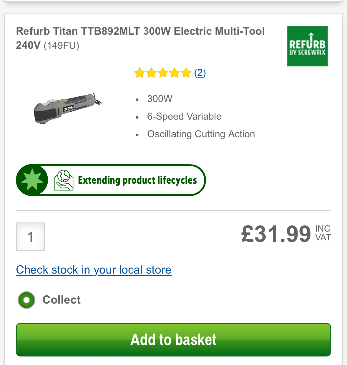

I’d buy one tbh, very handy.. £32 from screwfix. But yes you can do it by hand; pick up a jab saw for less than a tenner
