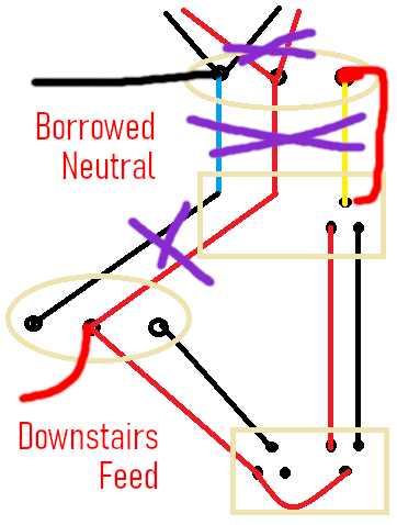

What is going on with this switch wiring?
I think this was an ATTEMPT to get rid of a borrowed neutral (or live! Technically) which was done incorrectly.
Yes he had lots of other things to fix there which he was contracted for.
He was correct that there is no quick or easy fix for this.
More wires required between upstairs and downstairs. 3 are required in total.
Or as said wireless.
What I don't understand is that there is an RCBO board, so presumably there has to have been alteration work on the borrowed neutral?
I didn't watch the whole video as the audio was so poor, but either that 3C&E was part of an alteration for the borrowed neutral putting the downstairs hall light on the same circuit as the upstairs lights or the two circuits have not been separated. It would have only taken 5 minutes to test and trace everything out, but I'm suspecting that upstairs switch is actually at fault.
Most likely the hall light has been put onto the same circuit and separated from the rest of the downstairs lighting. There appears to be everything that's required in those pattresses as the 3C&E has the L,N and SL. There's two sets of cables going to downstairs and another two in the downstairs switch - the rest will be in the rose in the hall light.

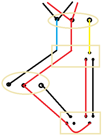

Danny - If you believe that draw a diagram on a bit of paper and prove to yourself how it all works (including the downstairs light)
Looks pretty straightforward to me.
3C&E from landing light - L(R) N(B) SL(Y)
T&E from landing switch to downstairs switch = strappers (R + B)
T&E from landing switch to hall rose = L(R) and N(B) from the Red and Blue 3C&E
T&E from hall rose to hall switch = L(R) and SL(B)
Hall switch uses L(R) for the common terminals on both switches providing the permanent live for both of the lights.
Landing switch is faulty or broken strapper.

If my [and aptsys] assumption of wiring is correct:
then it really would have only taken a few minutes to:
a) locate the fault or
b) prove that is not the way it's wired. and
c) repairing may have taken a lot longer
BUT AS IT IS WE HAVE NO IDEA, other than assumptions, WHAT IS THERE AND FOR THAT MATTER WHAT THE SYMPTOMS OF THE 'FAULT' ARE AS THE OPERATION OF SWITCHES AND THE EFFECT HAVE NOT BEEN DEMONSTRATED OR DESCRIBED. All I've heard so far is all the switches are old and need replacing... Hardly a professionals diagnosis especially as I still have a number of those exact switches in my home which behave perfectly.
That's is certainly a creative idea.
However
1) I don't believe that is how the red and black wires would have been routed when the house was built in the 60's. It's a possibility it is like that now.
2) Jordan said the switch strappers were not connected like this.
What we did hear was that the upstairs light only works off the upstairs switch.
We didn't hear the light only works if the downstairs switch is in a certain position (a symptom of a faulty contact or connection). In fact he changed the downstairs switch with no improvement
Yes the "switches are old and need replacing... " was very poor. And he proved himself wrong when he changed a switch (downstairs hall). And had to change it back lol
Still guessing here, but I would assume this is how it was originally wired.
upload_2020-8-5_11-47-411-png.201064
Given one piece of T&E looks to be quite different to the other (grey jacket is stuck to the inner core) I don't think the T&E from the switch to the downstairs rose or the 3C&E existed previously. A single red was probably originally between the landing switch and the landing light as was common in the 60's.
