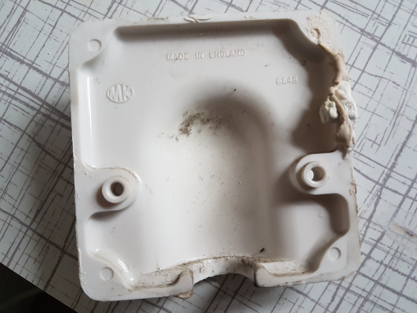

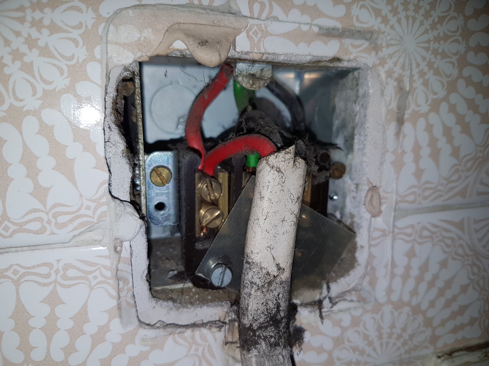

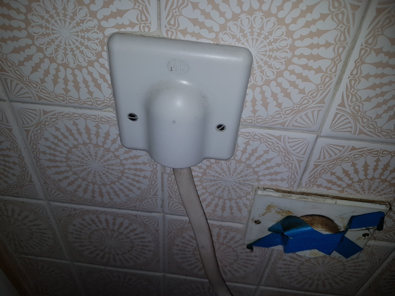

Hi, I am looking to replace my kitchen cooker (it's about 40 years old) with a modern equivalent though I want to confirm the cooker power outlet is suitable. Please find enclosed photos of the MK outlet. The fuse box is unlabelled therefore I was unable to identify the fuse rating. I assume this old MK outlet is 45A rated which is equivalent to a new MK replacement. Though I wanted to see whether anyone on the forum has come across this type and can confirm its power rating. Thanks.
MK 5045, rating not specified in the catalogue but designed to take up to 2x10mm² conductors so will be rated to at least the same as 10mm² cable, which is far in excess of 45A.
Any modern cooker outlet will be a suitable replacement.
Though possibly no more than 63A which is unlikely for a cooker.

Thank you for replying and sharing this information, it's much appreciated.
