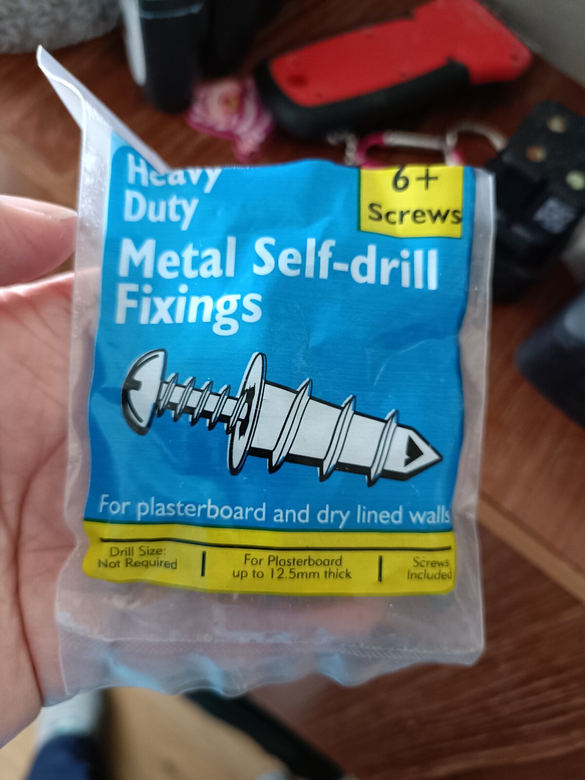

What screws fit these anchors?

I have this packet of anchors that I'd like to use for hanging a towel rail but the included screws are missing. The packet helpfully only says they are included. What kind should I buy to replace them?

Correct size wood screw will work, unlikely those supplied in the packet would suit your use.
Use umbrella fixings (hollow wall anchors), they will cope better with the forces on a towel rail
The space inside the wall is too small for those. It's one of those weird 1950s cardboard partitions and it's narrower than a modern stud wall. The wings are too long.
I found a forgotten packet of Fischer duo plugs and used those instead.
Zip Fix might have been better.
They are like spring toggles but the screw can be removed and reinserted if required.
I often use those Interset umbrella) fittings but recently had a job where they started to fail under load... I had not realised that the walls were double skin plasterboard. They were too thick for my fittings to work properly, so I slightly enlarged the holes and used the Zip-Fix fittings. It wasn't plain sailing though, the rockwool in the wall made it difficult for the toggle part to drop down. I spent ages using a long screwdriver to push the rockwool out of the way.
FWIW they do make interset fixings for double skinned walls. Mine were only suitable for single skins
