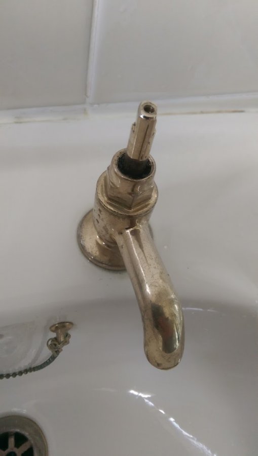

Hi, I am in the process of replacing the 'O' rings on my bathroom taps. I've removed the tap heads and the retaining nut that sits above the 'O' ring. I have also removed some PTFE tape that I had used as a temporary fix in the past. However, underneath this is a black ring of some kind, that I'm having real trouble removing :(
The reason I need to remove it is that when I try to put a new O ring in, there isn't enough thread visible for me to be able to screw in the retaining nut. This makes me suspect that the black is the old O ring, compressed down after years of use.
Can anybody confirm if this an old rubber 'O' ring, that I can safely rip out (destroying in the process) or is this an important part of the tap that I mustn't damage. I hope it's not the latter, since I've already done quite a bit of damage to it :oops:
If I do need to remove it, can anybody suggest the easiest way of doing it? I've tried attacking it with the point of a bradawl, and a small screwdriver, but with not much impact.

To replace the spindle o ring, the valve has to be removed from the tap and dismantled.

Hi Terry, could you give a bit more detail please? Am I likely to have done any serious damage by attempting to remove it from above?
tap.jpg Here is a photo of the tap. I have dismantled it, as if I was going to change the washer. Once I've done this, I can completely remove the central 'rod' by screwing it down (as if I was closing the tap). Once I've done this, I can pull the rod out and look at the insides. It looks as if the O ring might be in the middle, under a plastic tube, which is pushed down when I tighten the retaining nut on the top. However, I can't seem to remove that plastic tube - and I don't think it's just because of the damage I might have done - it just seems firmly wedged into the top bit.
Update: I have managed to prise out the plastic tube bit, and it seems to be just that - a rigid plastic tube, with no O ring. I've tried putting an O ring in place underneath the tube, when viewed from above, but then the retaining nut only just fits in and the is quite hard to turn. I'm thinking I could just dispense with the tube bit and put a rubber O ring in its place. Be interested in your views Terry.

In the end, I went ahead and prised out the black plastic tubing and put a couple of O rings in its place. Seems to work OK-ish, but it's a bit tight to turn the tap. I've now gone ahead and ordered some plastic tubing, to see if I can cut this down into some short lengths, to replace the plastic tube that used to be there. Ideally, I want just one O ring, then a bit of plastic tubing, and then the retaining nut. I figure a single O ring ought to provide a good enough seal against water coming up the spindle, without making the tap too hard to turn.
