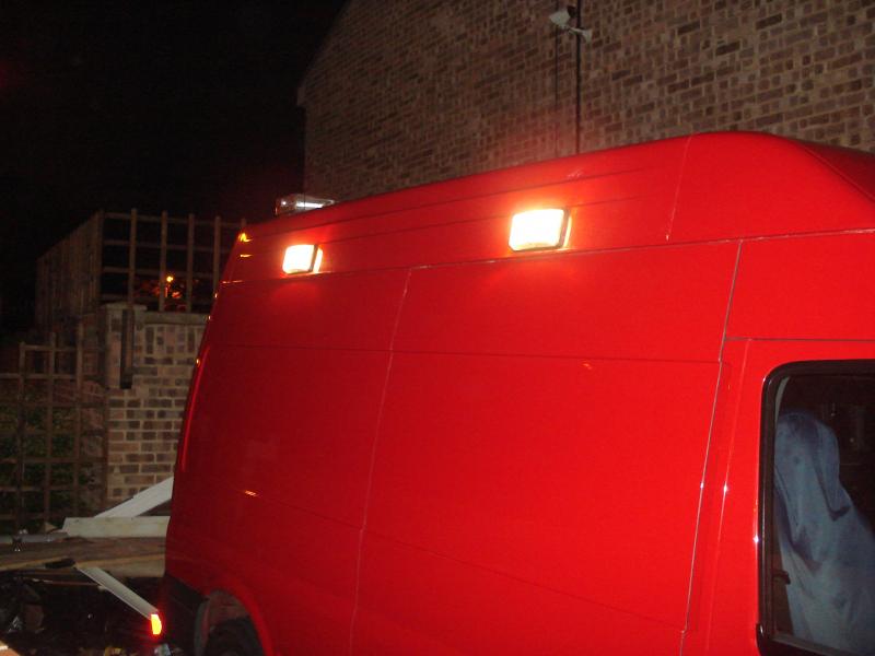

Hi, I have scene lights on side elevation of my van. There are 2 lights with a total of 140 wattage. The question is what gauge wire do I use and what size relay?
