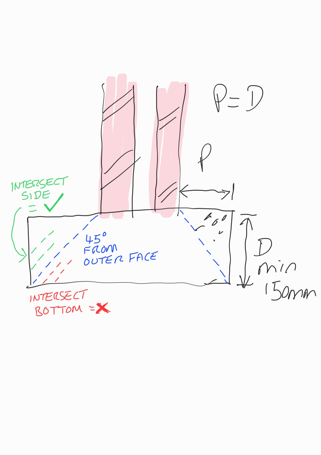

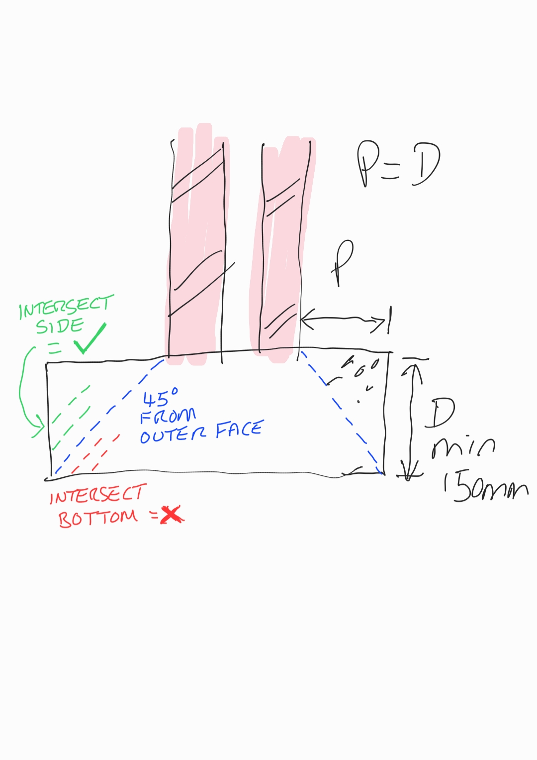

The concrete strength and depth for a one storey will suit a two-storey and potentially three-storey.
The practical minimum thickness of concrete from Part A is 150mm, but that would depend on being 100% certain of ground conditions throughout the whole trench, which most people CBAr'sed with. So most people just go for 225 instead - or more?
