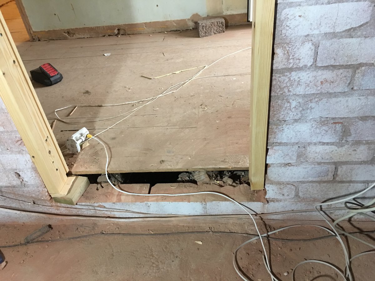

i have created a opening into the garage. And when we put door frame up had to remove a course of bricks to allow the door frame to reach floor level(it was half a course above floor level.
Given I removed a course how should I make it level? A piece of timber? Find some thin bricks?

Buy a piece of 220mm MDF bull nosed window board and make a tread/sill.
Or chop the next course of bricks off and run a load of soldier snap-headers (brick-on-edge) along.
A piece of timber will be fine and form a cill ..Nose beat me again

Ok, so I got some spare roofing timber which I will shave to size, then put some window board on top. Then screw it down with some window frame screws. This sound ok?
