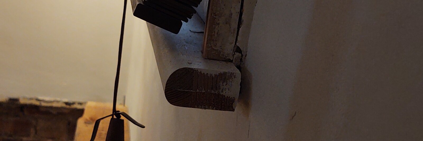

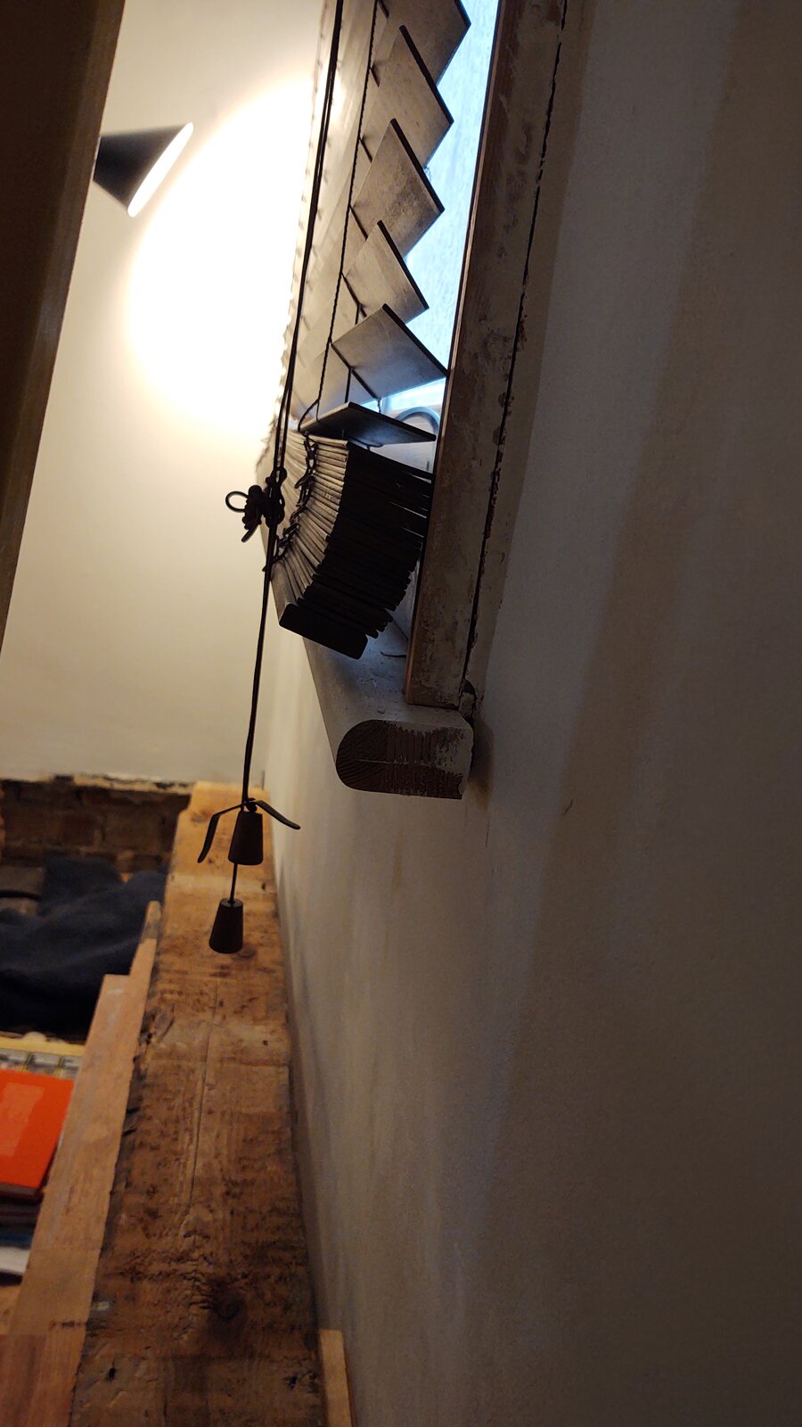

If like to route a piece of timbre so it's edge looks like this
and another one like this
Which router cutter do I need?

The first looks like an ovolo moulding (without the lower lip), the second a bullnose or rounding over bit is required. You will have to work out the radius for a close match. Depending on the thickness it would would wise to consider cutting it in a router table rather than free hand (if possible), and in any event to use a half inch router shank. Do not try unless you have built up some practical experience in the use and maintenance of routers and routing.
Blup
a very large roundover bit and a quirk or even a panel bit and a router table if its not a constant curve

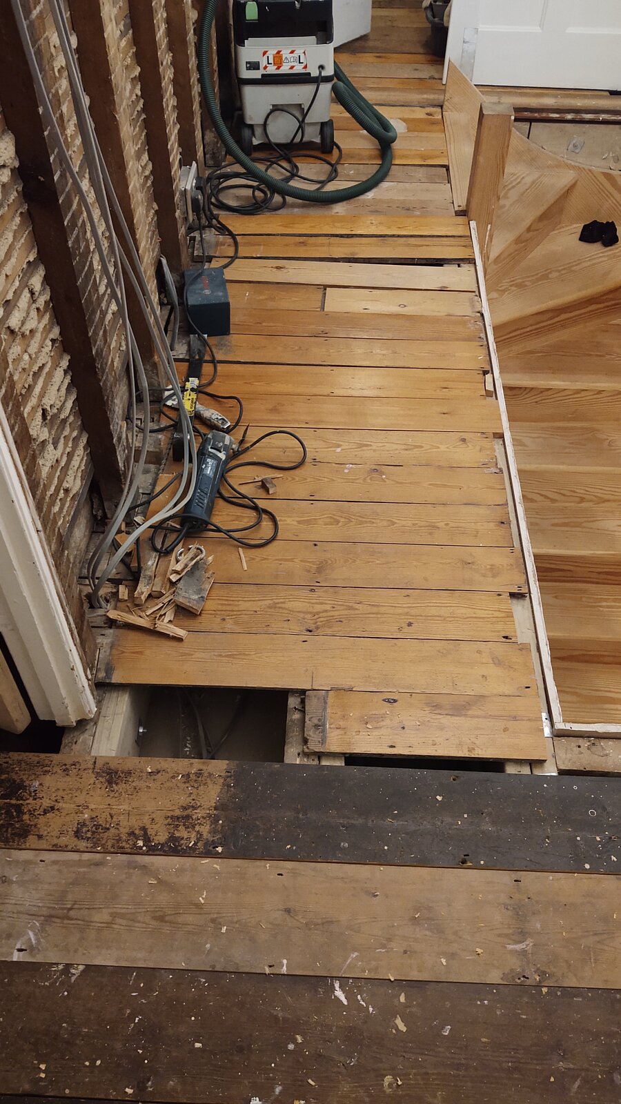

Just to give more detail regarding the project I am doing; I am changing my existing floorboards with nicer, thicker, and wider boards, see the pic below. I'd like to use a narrow long piece of the same floorboard as an edge (is there a specific name for that bit?) on the stairwell side. I would like to route the outer bit of this edge bit with a bullnose cutter like this one to make it look nice and match the stairs tread edge. I do hope this makes sense. Does this sound like a good way of doing it or is there a better way?

how thick are the boards or bullnose ??
one pass on the top and one pass on the bottom take the board thickness say 22mm deduct 3mm that gives you 19mm half that is 9.5mm so get that radius as you need a 3mm flat on the nose to run on
