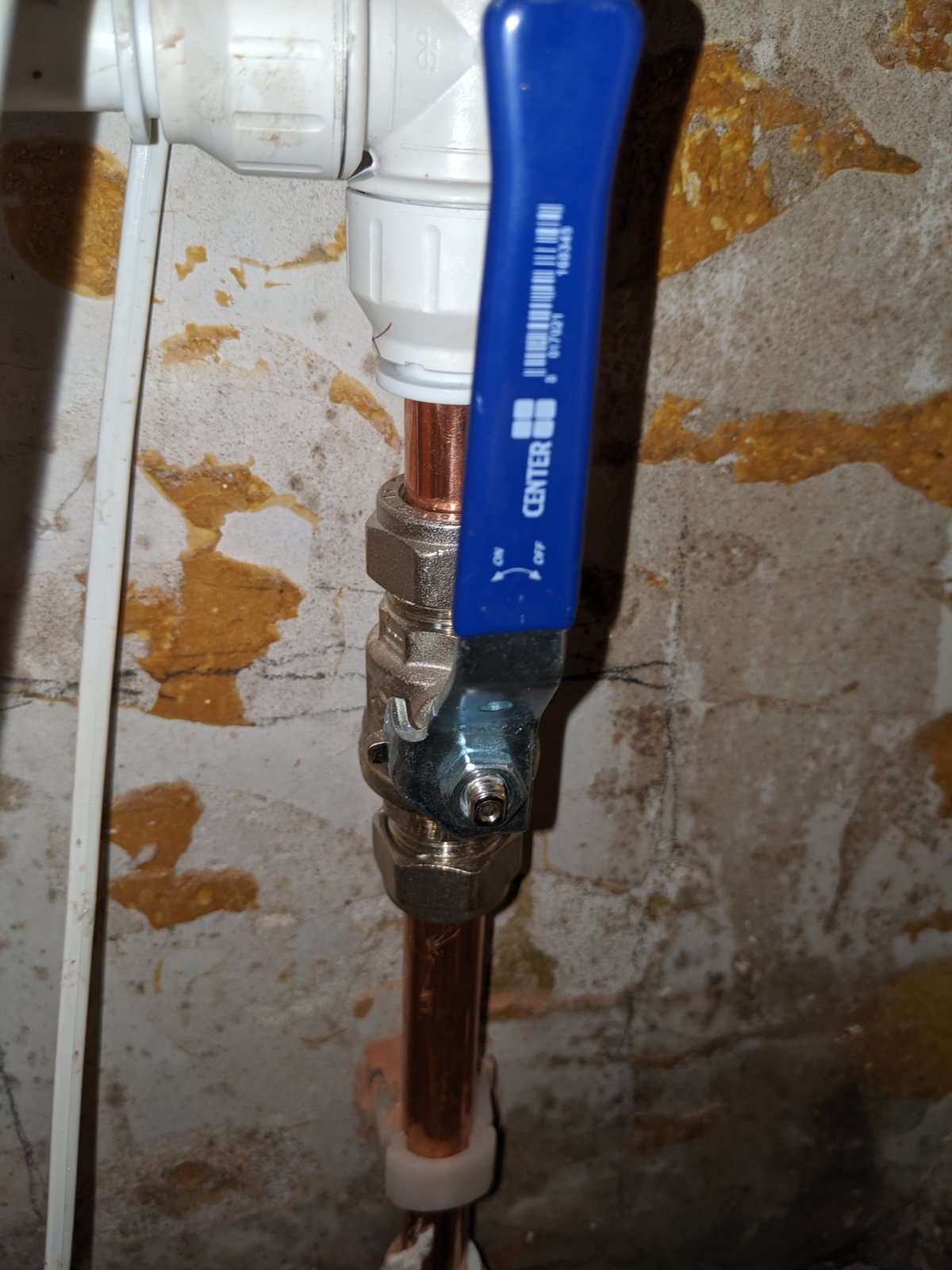

Thought I'd update this.
So the plumber has replaced the old stopcock and also an isolator valve which was nearby as he though the restriction of the valve might be affecting the flow.
He has replaced it with a lever type stopcock and if anything the flow is worse!!!
Help!!!
Does the copper pipe that rises vertically from the lever valve go directly to the kitchen cold tap ,and is that worse than what it was ?
I can understand everything else being worse as the " plumber" has used plastic pipe / stiffeners and reduced the internal bore substantially ,which will of course reduce the flow.
better pics of the valve and stopcock please.
Full-bore ones are rather fat.

Photo of lever.
https://photos.app.goo.gl/krt6q9k1fCkwYKiTA

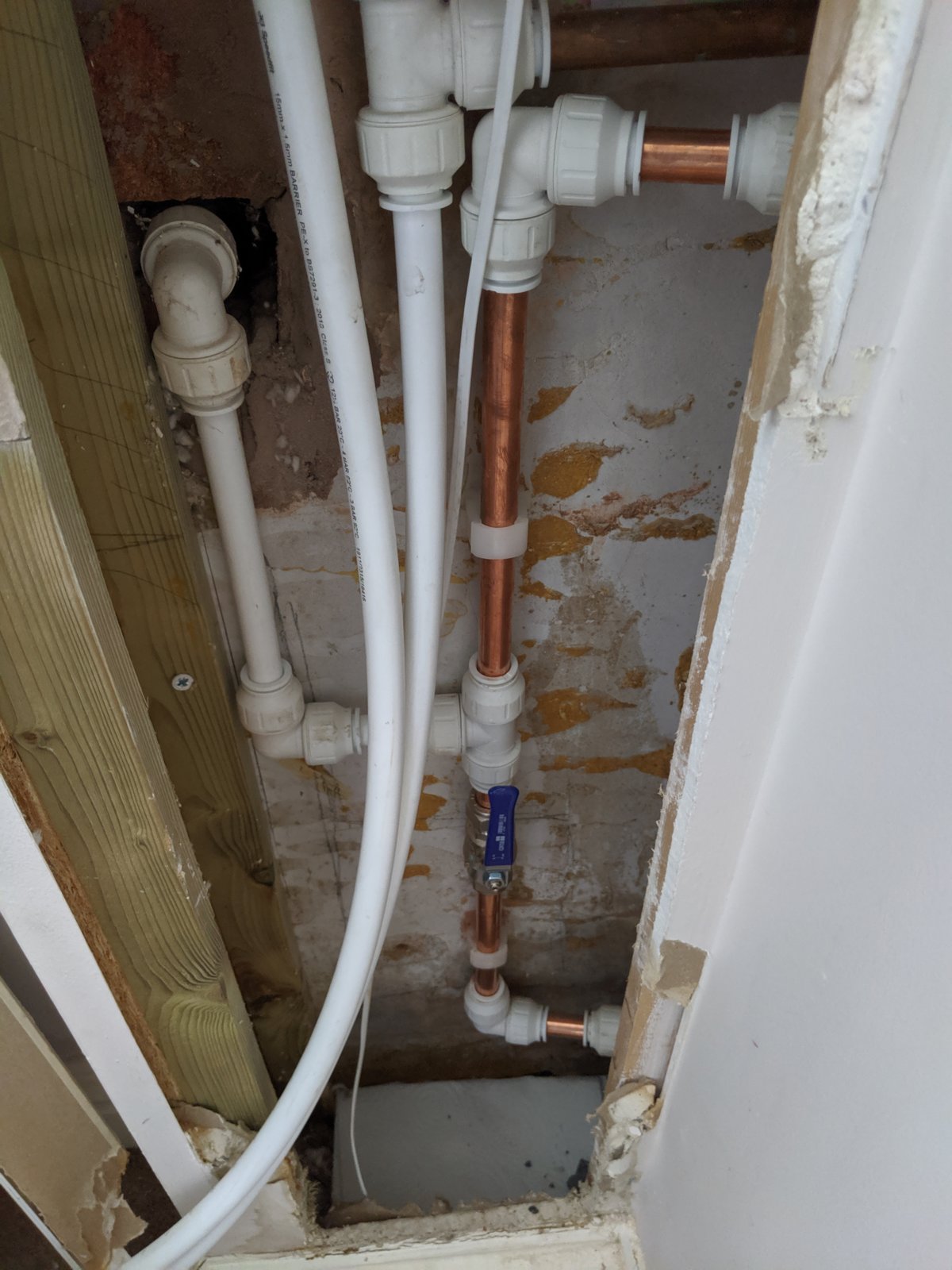

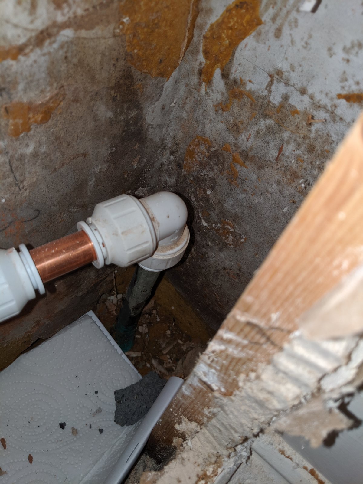

This is a quick vid of the route for the cold.
The cold ends up on the plastic pipes going to a temporary sink we have setup.
Measured it quickly and the flow is probably the same at 6 litres per min.
The outside tap which you can see on the vid going out the wall gets 9 litres per min. Was 12.
Maybe that's all I can get and the pipe under the house is naff.
