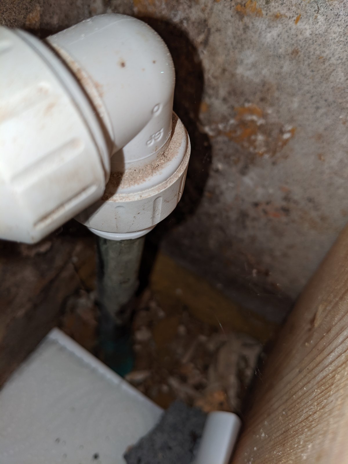

if you have suspended wooden floors with a void underneath, and can use a spade in the front garden, it is not at all difficult or complex.
Do you have any lead pipes? If so, get the water co to test your drinking water for lead content. There might be a subsidy or free connection.
I changed one in an old house and got a vast improvement in flow (use 32mm, or at least 25mm, plastic pipe, and full-bore stopcocks)
The water co will want to inspect before you refill the trench.
Blue plastic is much newer than 1960s
What diameter?
Does the blue come into the house?
Photos would help.
What diameter?
