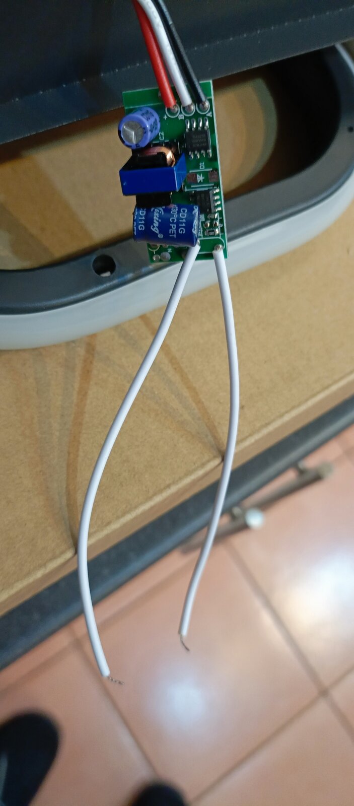

What white wire to connect to neutral and live
30 Oct 2025
What white wire to connect to live and neutral
Edited. Obviously me talking bollards.
In theory it doesn't matter, because on an A/C supply, the polarity of the incomer is changing around 50 times every second; hence the name, alternating current supply(y)
If that were my little power supply, I'd fit a double pole switch as the isolator.
Doesn’t matter, the AC is immediately rectified and turned into DC. AC polarity really only matters in a few specific cases, e.g. upstream of single-pole switches (like light switches), fuses, and with Edison lamp holders. Some complex circuits in older gas boilers also rely on correct polarity, in that instance it’s a functional rather than a safety issue though. If connected the wrong way, the boiler doesn’t work.

I hope the two wires haven’t been salvaged from any other extraneous device, deviating from their intended use in AC, and used here.
