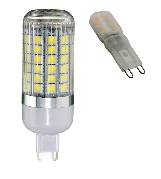

Yes I have done Mean, Median and Mode. And LED bulb design does vary manufacturer to manufacturer, unfortunately price seems to have very little impact on quality, I have shown this G9-comp.jpg of G9 bulbs many times, the larger one was also cheapest, and did not comply with UK regulations, but worked far better to smaller one, but the big change is I use to buy a pack of bulbs for a pound or two, now one bulb can cost £5 or more, and where one has a chandelier or silly down lights one room may have upwards of 8 bulbs.

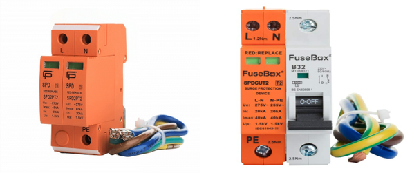

Not convinced a SPD will help, but also not convinced a SPD will not help. I have fusebox consumer unit, when I bought it a few years ago the SPD was two module wide with no overload, today one module wide with overload upload_2021-11-20_5-20-0.png what is going on?
Nominal Discharge Current (In 8/20us) 20kA
Maximum Discharge Current (Imax 8/20us)40kA
Both types.
The video linked in previous post does talk about this, and also the types of SPD, both say T2 as said at around £30, BG and Fusebox, I fitted one, seemed worth the money to save LED's even if not sure they work. But for Wylex nearly £90 and one has to ask what is the difference?

In the previous edition of the IET Wiring Regulations, BS 7671:2008+A3:2015, there was an exception for some domestic dwellings to be excluded from surge protection requirements, for example, if supplied with an underground cable, but this has now been removed and it is now a requirement for all types of premises including single dwelling units. This applies to all new build and properties being rewired.
I note this IET resource shows a Wylex CU with double width SPD and no MCB. different make, but looks like my own CU.
note 'was', so it seems we have no option, same as RCD. But I can't see a down side with SPD, there are clearly problems with RCD's, I know in my old house the RCD would have a bout of tripping. This house all RCBO's.
