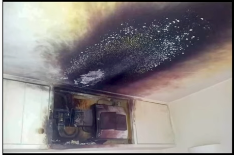

If the videos singing the praises of SPD showed the oscilloscope pattern before and after that would help, but pictures like this
with a claim that a SPD would have stopped it. I can not see how a SPD would have absorbed that.

If the videos singing the praises of SPD showed the oscilloscope pattern before and after that would help, but pictures like this View attachment 251193 with a claim that a SPD would have stopped it. I can not see how a SPD would have absorbed that.

No that pic would undountedly not had been stopped by the SPD. If that was a surge I imagine the SPD would have done that itself and/or made the bang worse. However I suspect the big bang was more to do with a bad joint and a short circuit. Just my opinion as there is virtually nothing in a cutout that would be affected by excessive voltage!

If the videos singing the praises of SPD showed the oscilloscope pattern before and after that would help, but pictures like this ... with a claim that a SPD would have stopped it. I can not see how a SPD would have absorbed that.
