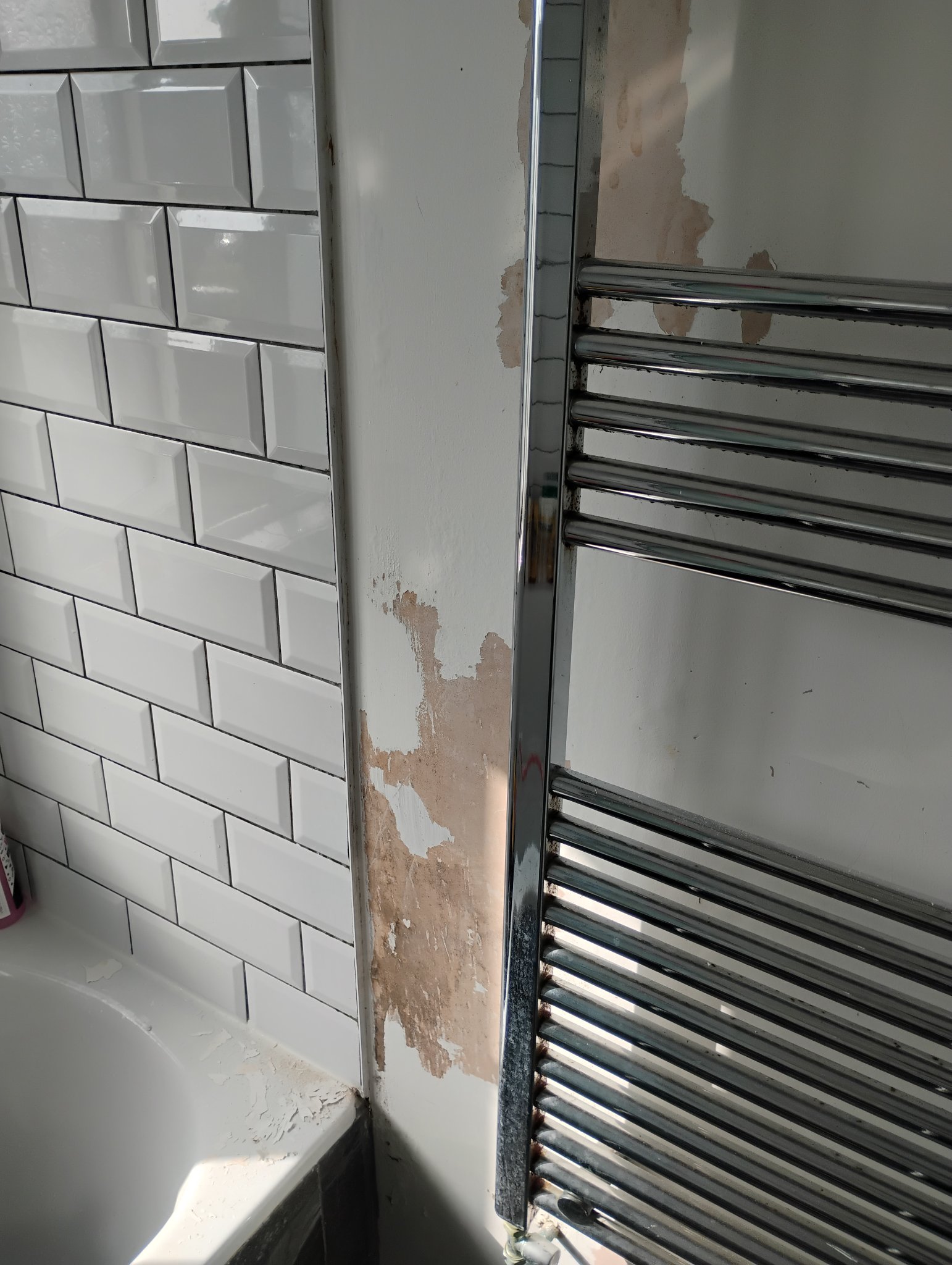

What's the easiest way to remove flaking/cracking bathroom paint?
17 Dec 2018
608
15
1. Condensation in bathroom has caused extreme flaking/cracking of bathroom paint.
2. I plan to remove all of the paint in the bathroom i.e. the flaky and non flaking (well attached) paint.
Please advise on the easiest/quickest/best method to remove all of the paint?
P.S. I've already used a scraper and detail sander to remove the paint but this was slow/messy and not effective.
Glass scraper or wood chisel will get paint off.
Gardz to seal.
Toupret powder filler.
120 grade sand..
Gardz the filler.
Paint.
Run dehumidifier in winter near bathroom for a few hours every night
Stop putting wet towel on radiator. It's a towel warmer not dryer.
Hang towels near dehumidifier to dry.
Just saying. Nicely. We made same mistake
