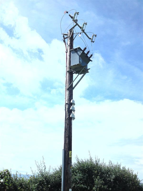

This transformer was installed on a site we did a while back. An HV cable running between two substations runs through the field, and this pole mounted TX was stuck up and tee'd from it. WPD only exceptionally fit small TX's on the ground.

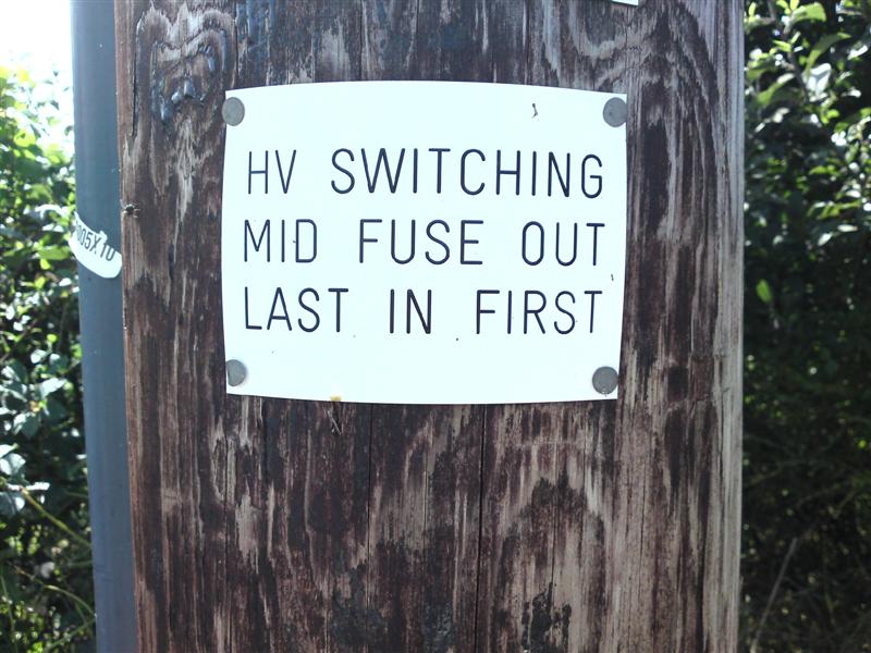

The sign puzzled me?
And me!!
I suspect that when the fuse is tripped it will be in close proximity to the dropper wire going to the left hand terminal of the transformer.
Yes I saw that entry of the 14th, I'll look at our log on Monday to see what it was
I take it the HV fuses are those things on the top? Not as simple as so if one is dropped it doesn't short across the insulator terminals on the transformer??
The fuses pivot on their bottom contacts so it tripped (opened) will swing down, this, I think, will bring the top contact close to the other dropper. Bearing in mind that though the operating rods are insulated the heads are aluminium, thus further reducing clearance.
