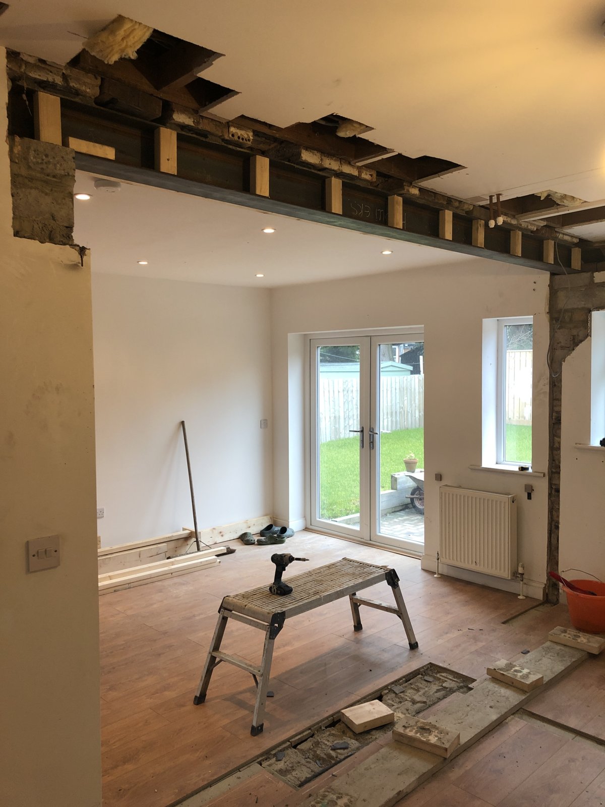

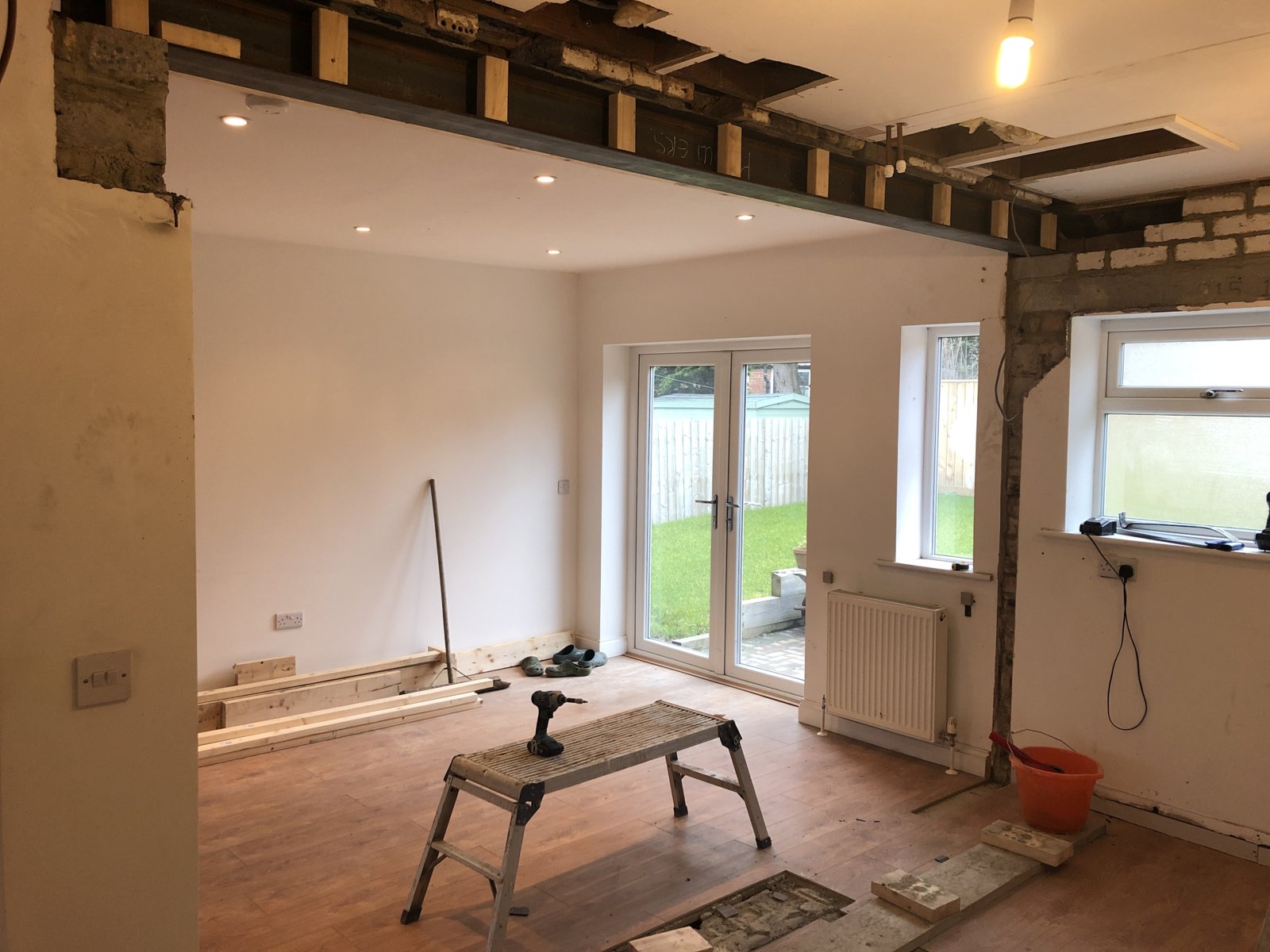

4m rsj went in Tuesday and the 10mm gap between steel and existing brickwork above was packed with 3:1 sharp sand:cement (very dry, just clumping). Also banged in some slate where I could get a tight fit.
This is indoors so heated each evening. The mortar felt as hard as a rock 24 hours later. It’s now Sat morning so it’s been 80 hours. Am I ok to remove Acrows?
Thanks Woody but the slate isn’t everywhere so I’d prefer to be confident the mortar has properly set by now
If it's not set by now it's not going to so probably best to find out sooner rather than later and it's not going far - 10mm
Tada!!
God I hope you’re kidding!! I’m confident but it’s still a big task for an amateur.
