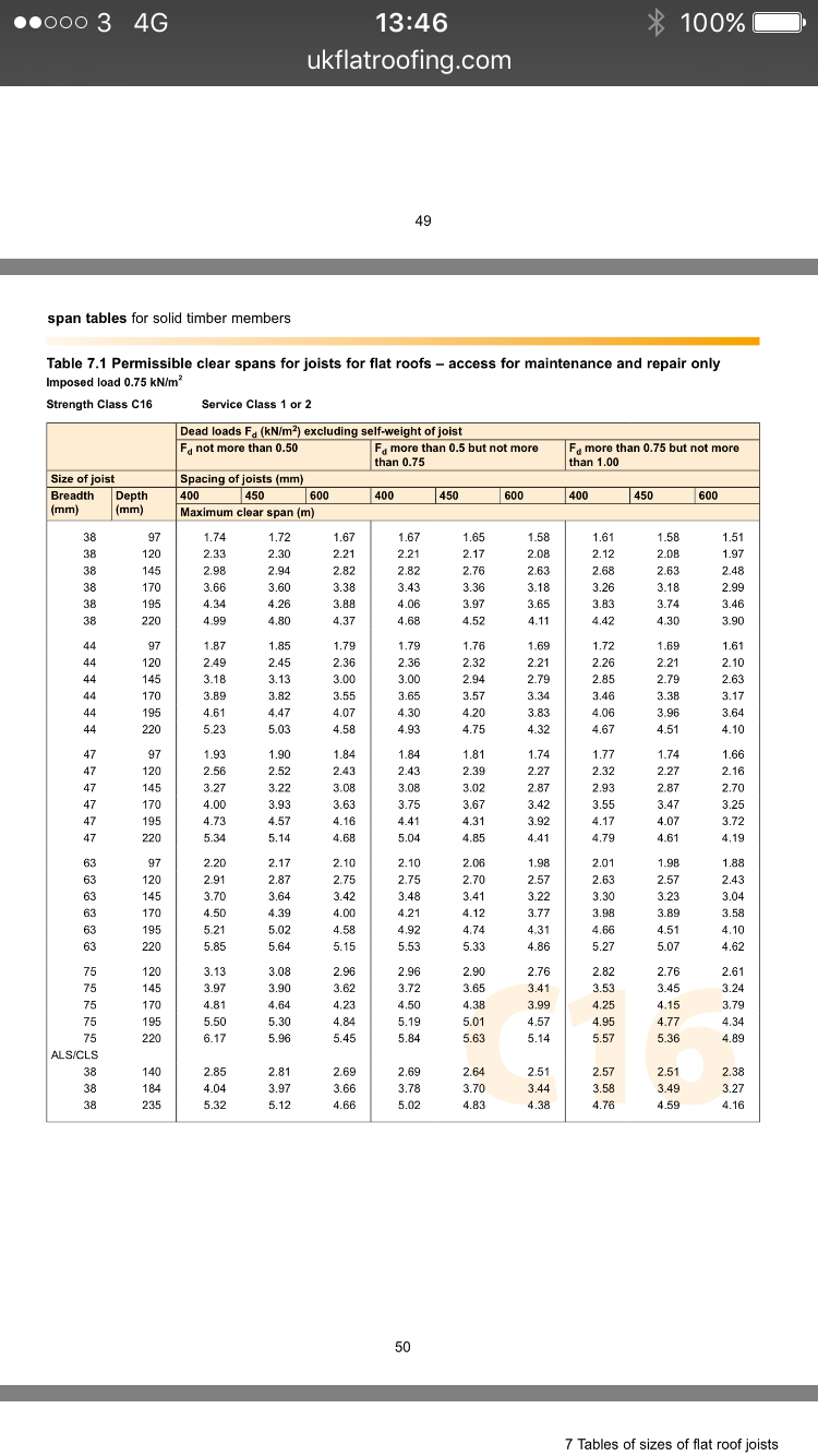

I would also review your section sizes, and whether c24 is actually necessary.
The 8x2's have a span of 4.8m for the flat roof. The building control guy looked at his span tables and said C24 was required. C24 is harder to get hold of and more expensive than good old C16. Not sure if increasing height to 9" timbers and going C16 route will offer savings.

Just looked at span tables. Seems to me at a max span of 4.7m I can get away with C16 with my 8x2s. (Taking into account my wall bearer plate and RSJ)
Gonna review my order tonight as I may get away with C16 and the span tables show I can go with 600mm centres for pitched roof rafters so need less of them. Will try the other options and go into Cambabest in person.
