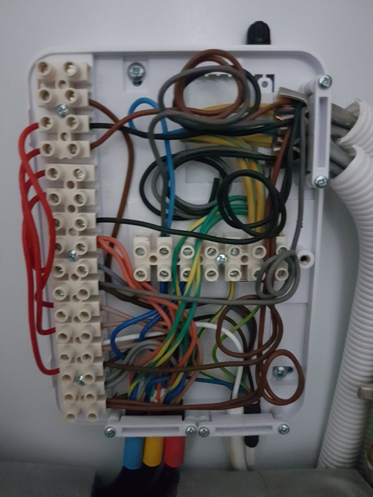

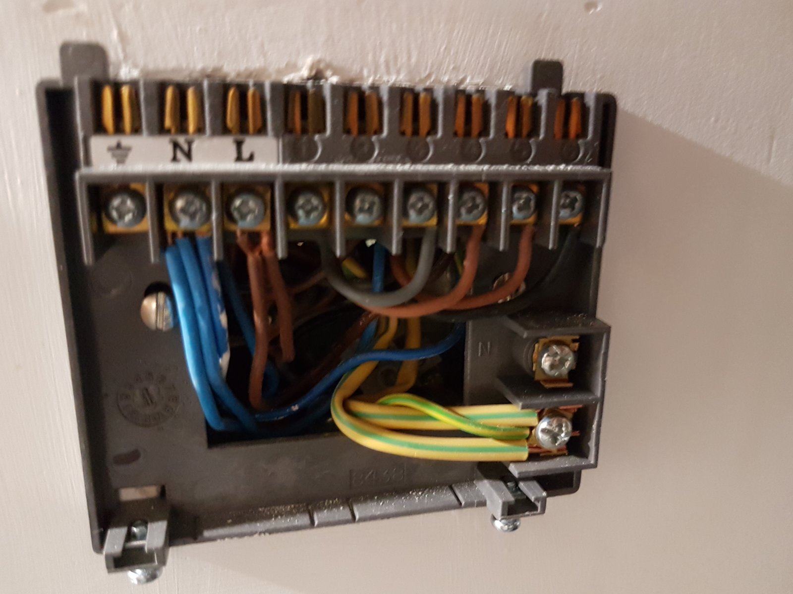

I have a Danfloss tp9000 programmer and TS2 room sensor which is controlling the Ideal Heat 15 system boiler.
I'm trying to replace it with a smart thermostat by Nest, replicating this set up https://d3vlabs.com/2016/12/09/install-nest-tp9000-ts2-danfoss-3rd-gen-uk/

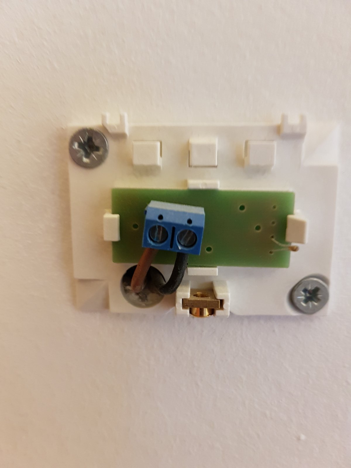

There are 3 lives, 3 neutrals one grey to call Hot Water T3 and brown to call CH on T4, this is all straight forward more or less. Than there is a brown and black two core cable on terminals T5 and T6 for the remote sensor TS2, which I wanted to re-use to power thermostat via 12V DC supply from heatlink, as I thought this is just a straight connection to TS2.
My problem is when I turn the power off on the boiler I still measure 5V AC on between two cores on room sensor wiring. Even when I disconnect the cable on both ends (sensor and programmer) the ac voltage is there. It goes away obviously when master is off on the board.
I struggle to understand this. If the cable goes somewhere else, why and where? If this is induction then 5V is quite a lot, but sensor is working fine somehow despite this.
I've got a wiring central next to hot water cylinder in cupboard. I tried to find these 5V but there is nothing.
There is also a second zone for bedroom CH, which should not matter I thought, as it runs from another tp5000 and there is no external sensors.
Please help, as I don't really want to try connecting thermostat to try it out.

Thanks. Yes, normal Fluke multimeter. This is good point about a load. I will probe it with a resistor. It still shows 5VAC when sensor is connected on other end. 10VAC and 3VAC between eaxh core and earth. So it made no sense to me.
So yiu think it won't interfere with dc supply when connected to power supply and thermostat. I was afraid it was running somewhere else for whatever reason.
Interesting, 5V to me sounded a lot. I used to few mV to uV at most of parasitic.

Ok. Now the main question will the thermostat and heatlink like such dirty supply line. Any ideas? I connected a 9v battery on one end I read it fine on another, but it still have about 10-8VAC parasitics on top. Is it safe for 12VDC powe supply?
All is solved now. Thanks everybody. I've connected the heatlink and nest thermostat via that existing sensor cable after all, as laying another cable is out of question. I thought if the passive thermistor sensor circuit could work fine like that, so dc power supply should be also ok. It works so far, let see how long:).
