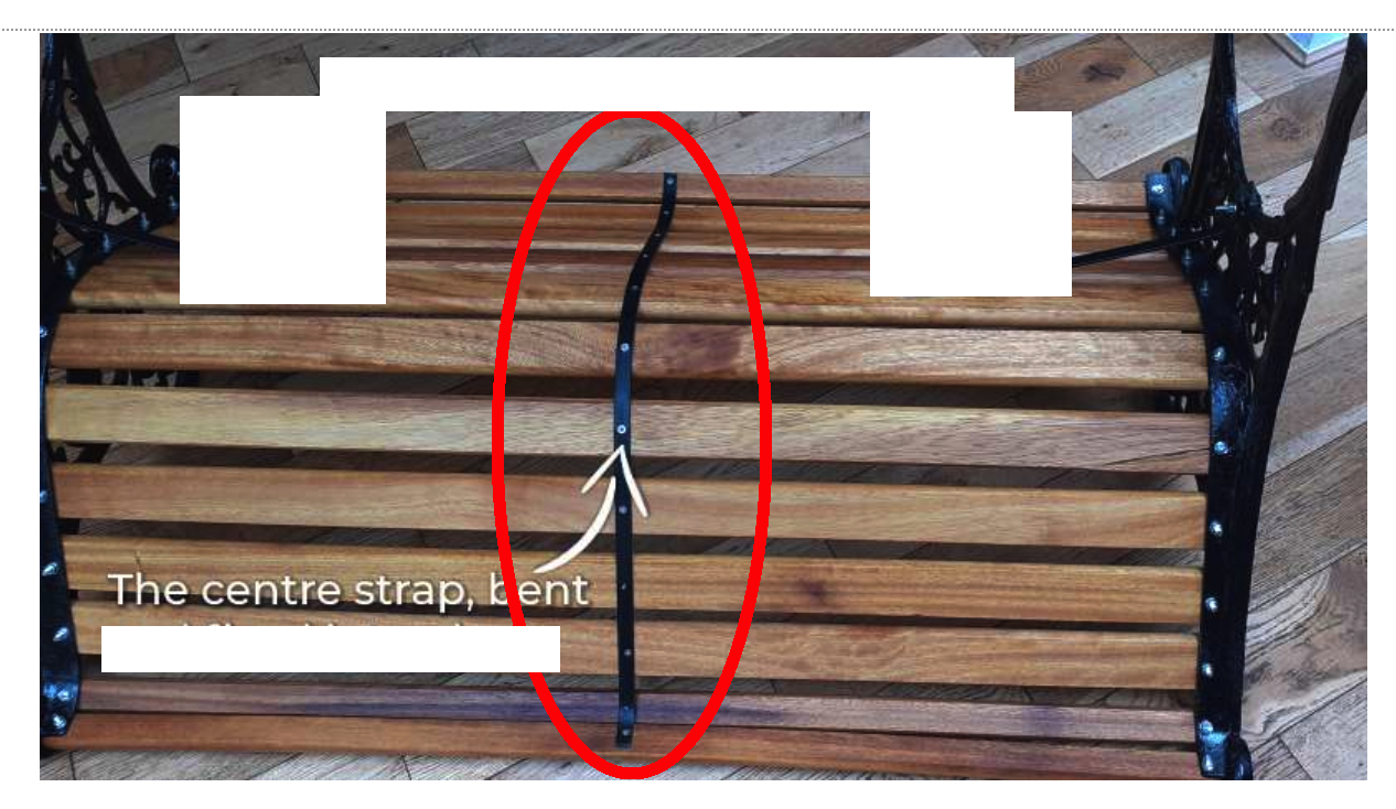

I just restored a garden bench but can't find centre strap (marked in the attached pic). Tried Googling but no luck. Does anyone know where I can find them?

Its only thin mild steel bar.....dead easy to drill and bend, if you have a vice (or a strong knee).
B&Q and similar have the steel strip, its around 2 to 2 1/2mm thick.

The holes are not evenly spaced, so how can you buy it ready made? I needed some a few years ago, for a similar bench I was refurbing - I just used some thin, easy to bend, mild steel. I just bent it roughly to the profile, marked where the slats were and drilled it.
